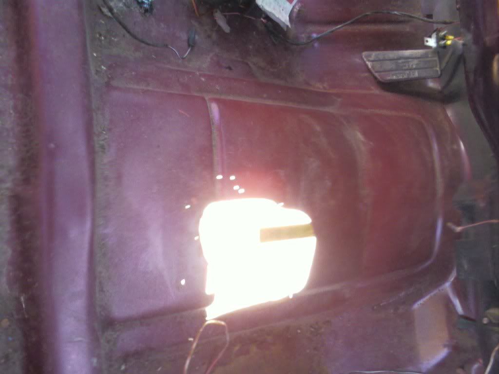

Here is my high hump in my 86
Here is my low hump in my 78
What am I going to have to do? It looks the even the transition to the firewall is even different. The one on the 86 ribbed(crappy pic so you can't see it) going into the firewall and the 78's is not. I know now that I am going to have to cut back the 86's hump to the rear of the hump but what I'm worried about now is the front by the firewall. Thanks guys

I got bored and got the cutoff wheel out and cut it already. I cut back on the firewall and all the way back to the end of the hump. Believe it or not the year difference in the floors have a slightly different shape(basically the same) and fits a little different but I'll make it work

Its not a picture perfect fit, but with a little hammer and dolly work they fit pretty good.

Yeah, Its not going to be perfect but I'll be covered up with a full plastic molded floor mat so I'm not going to worry about it. At least i got what I needed from the 86 cab out and placed in the 78 cab. Thanks guys
