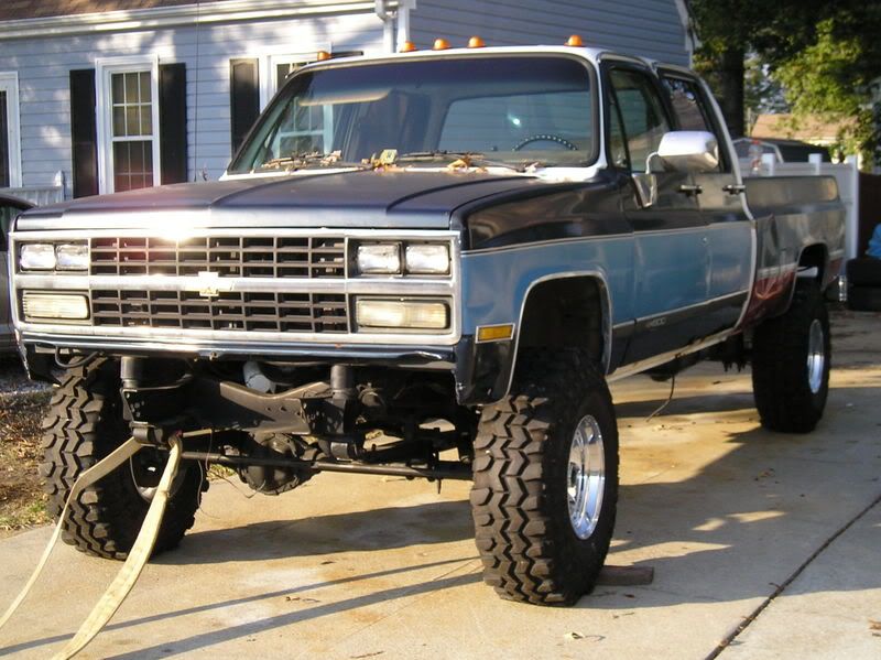

I now I'm looking to remove my 3" body lift and install this 1/2 ton based 8" lift on my 1-ton V-3500.
What snags might I run into?  What basic modifications will I need to make?
I figure their is a good chance that the rear springs will be different legnth.
I also realize that I will need to correct the steering / possiably add a box brace (even though the 1-tons are stouter)
What is the better steering correction for 8" of lift.
With the kit I bought I've got front 8" HD springs / Rear 8" HD springs / Stainless front brake lines / and set of 4 shocks.
Current set up is 3" Body lift + stock leaves with a (Dump Truck) looking add-a-leaf up front.  Rear spring pack is the original 13 leaf 1-ton spring pack.
It is on 38x12.50-16.5 Swamper TSL-SX's.   I like the stance but hate the body lift.
(Fan doesn't fit the shoroud well / fuel tanks showing / bumpers do not fit well / ect)

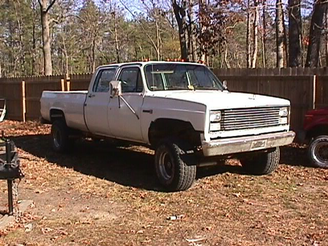

~ ugly before pics...   PO kids were running 44's and giving the poor truck the beat down of a lifetime.
