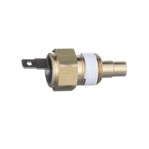

trying to locate the sender that the gauge is connected to. Where is it located? what does it look like? pics anyone?

Not sure what you are working on but they are usually in the cylinder head. Could also be in the intake.
Re: Where is the temp sender located?
March 30, 2010, 04:08:11 am »
the one for your cluster is on the drivers upper engine area, below the valve cover, between the front and center exhaust ports in the head. now the one for the ecm is on the intake its the sensor the one on the head is the switch for the cluster

Yes, i forgot to mention that its an 87 tbi 305.
I will take a look at it when i get home. Previous owner installed an after market temp guage which i am trying to get rid of. I do not know if its the guage or the sender, so this helps out alot
Thanks for the responses

Quote from: SgtDel on March 30, 2010, 04:50:02 pm
on my '79 383 stroker..
b/w the two spark plugs on left side....
same place in my '91 5.7...
Thanks for the pics, helped out alot.
Wire is the same color too.
Ok, so i grounded the wire the gauge shot past 260 to about the 3 o'clock position, but when i disconnected the wire it did not go back.
Is the gauge faulty? Or is there suppose to be some kinda resistance on the wire so that it could go back?
