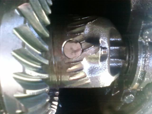

I just swapped the new axle assembly in as a unit and kept it open.  I could sell the locker unit to re-coup the cash and time I spent replacing it today.  Funny thing... yesterday on my way home from work I smelled that gut-churning stench of burning gear oil.  Found that the wheel seal was leaking again, so I dug out the replacement open one today and replaced it. here are a couple of pics of the menagerie I found when I opened the cover of the original:
OH MY God
What the heck is this brown... stuff?
Lets not forget to mention the "hum" it developed, and the 1/4 turn of play between the gear mesh... Its a wonder it moved at all. The drained oil looked like brown sparkle base coat  ::) .  I am glad I don't 4-wheel in the woods with this thing.
