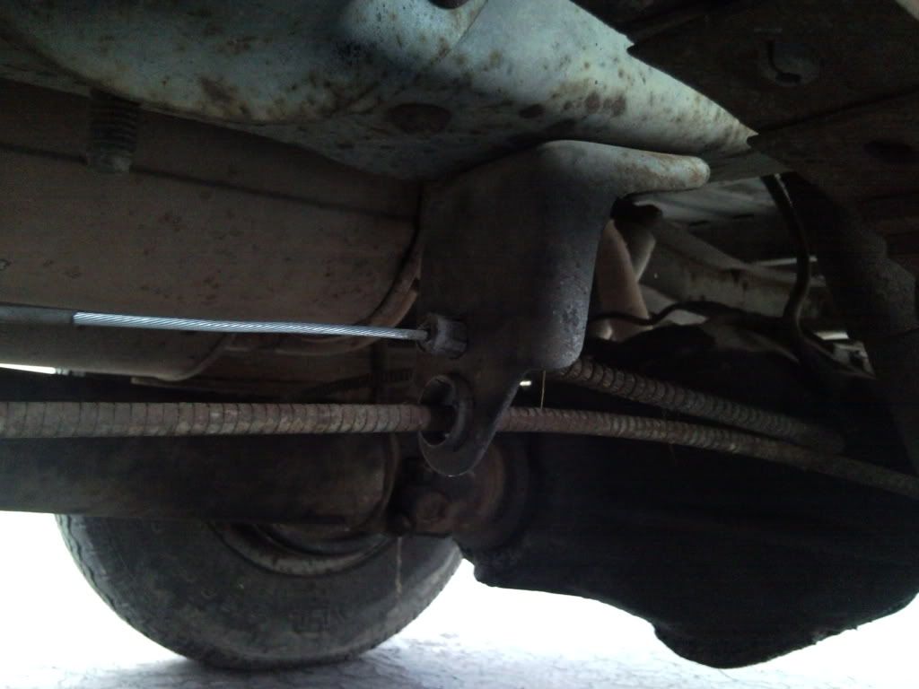

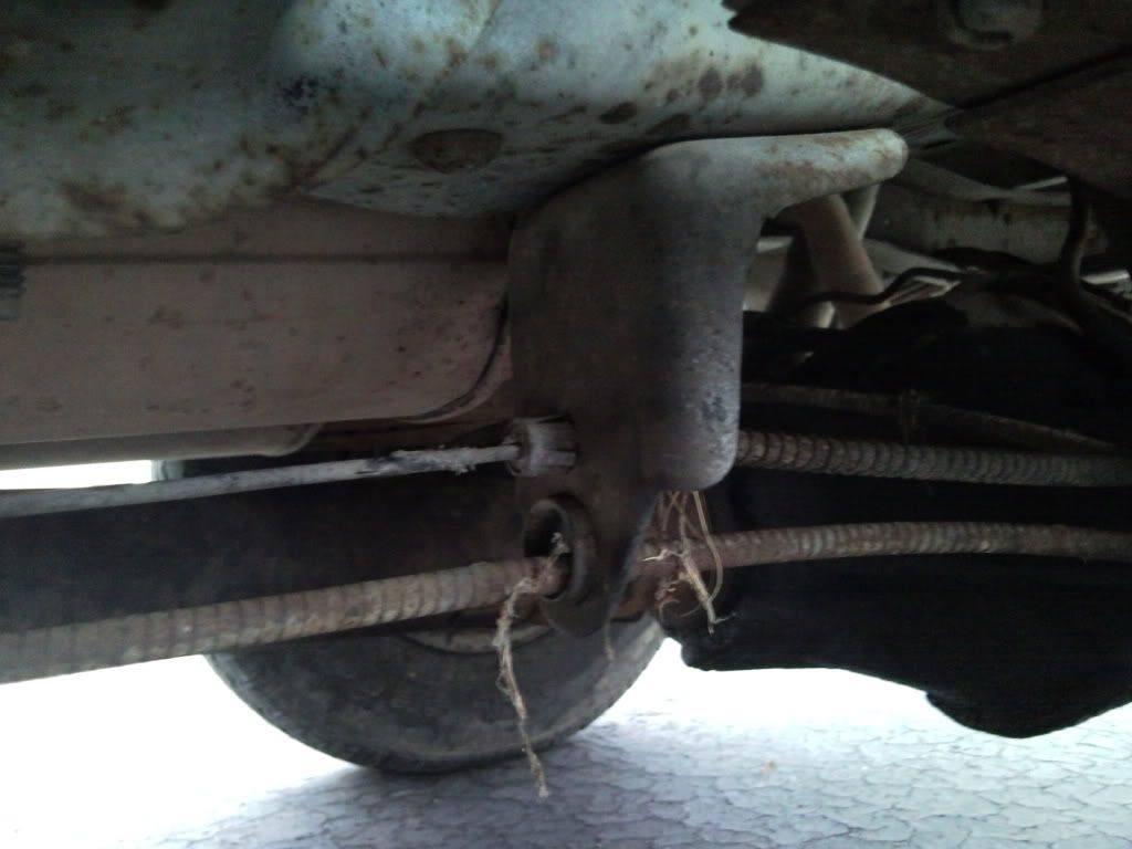

Finally got the brakes to 100%. I put everything back together to find out that the RR brake just wouldn't adjust right. I found that the plastic covering on the parking brake cable had started coming off and was bunched up against the cable housing, preventing the parking brake from releasing fully. I peeled back the coating and I'm all good now. The brakes are happy again.
Parking brake cable before:
Parking brake cable after:
