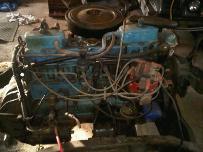

ok so i have a 79 chevy c10 and it has a strait 6 in it the vin on the cab says its a 250 but i dont know if its ever been changed, i had a guy telling me it was a 292 because the valve coves had the dip in them. where on the engine is the vin# and is there any good sites for decoding? thanks    -kyle

Looks like a 250 to me.  The 292 side covers are taller.

Definitely a 250 cause of the short lifter covers and cause the 292 has the passenger side motor mount and fuel pump reversed!

If it is supposed to be original, it would be a 250, a 292 wasn't offered in half ton.
x's 2 on this,
Also looks like the 250 in my '80.
which, btw, I do not reccomend.

Yes, in 1979 292 engines were not offered in C-10's only the heavier light duty trucks had them.

Thanks for all the replys I'm pretty sure it the original motor and from what u guys have said it seems like it is the 250

Definitely a 250.  The 292's didn't have the emmisions (humps on the heads)
