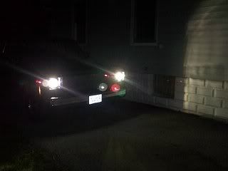

Ok I was not really wanting to do this to my truck. but my partner talked me into doing it. i order new headlight (the glass part) that a H4 buld would fit in. They were really nice and made with glass. than Got the HID's  for it. Do not have to cut any wires everything just plugs in.. Let me tell u all these make such a huge difference at night that its one of the best things I have done to my truck. Check out the pics . the brighter ones is when the HID's were on the other is the high beam(ha ha if you can call it that)
HID's ON
with the bright on

Those kits always infuriate me..That reflector housing is NOT designed as a proper projector for HIDs..You just created a glare machine that will blind on-coming traffic. HIDs require a precisely tuned reflector specifically designed for projecting light from the xenon HID "bulbs"..I've seen some of those conversions done on other vehicles locally, and have been blinded to a point of seeing spots for a good 5-10 minutes afterwords just from meeting them coming over a hill.

I don't man  i had someone else drive my truck and i was in another car they were no more blinding than other cars that come with them. Now I did aim them down alot more from were they were with the stock lights.Just so i  would not blind people. I'm sure there alot of people out there that don't care about other drivers and aim them higher. but anyways I like them.
jay
