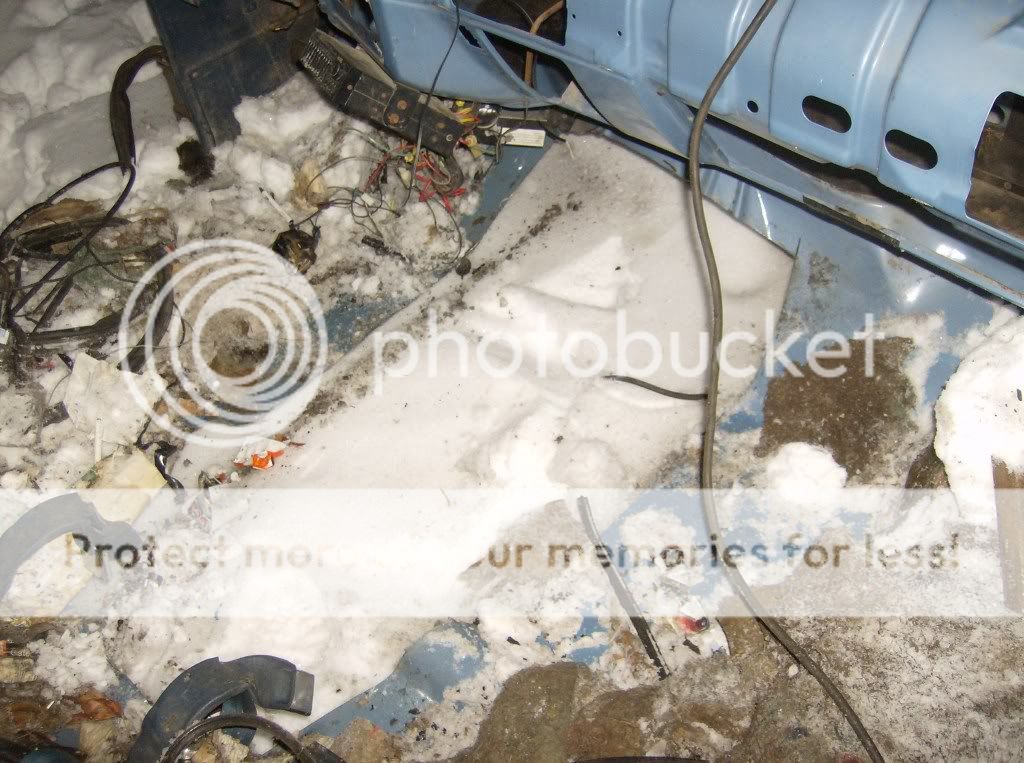

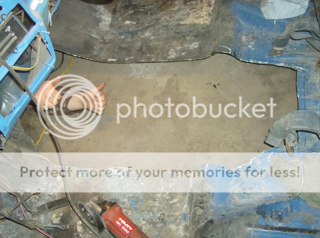

swapping floors is simple
this is mine and i did it in a few nights
first slice and dice the 4wd one out. sounds like you already have one from another truck. i had to cut mine from a 4wd one
step 2
drop over existing 2wd floor and stare in under shock that is it lines up  ;D
make a line with a sharpie around the outside. then measure in about an inch or 2 inches. then make another line.
the second line is the one you want to cut

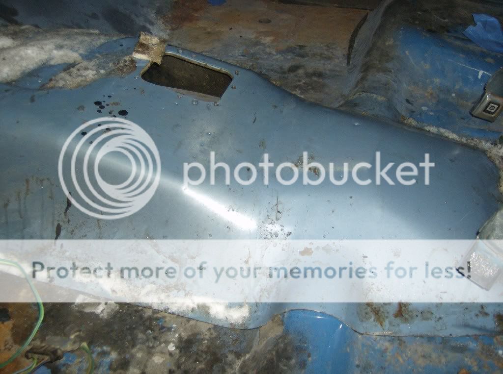

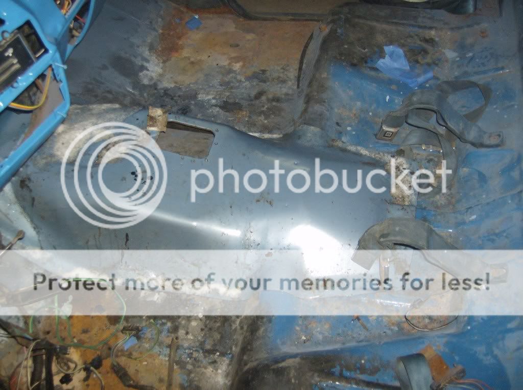

step 3
grow a pair of you know whats and bust out that cut off wheel and safety shield and get to work :)
then drop the 4wd and plug in that welder and go to town
and that is how you put a 4wd hump in a 2wd cab
don't forget to seam seal
-dave
