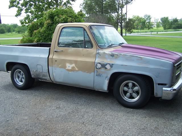

Heres a pic of my 85 with shackles and hangers and 2-1/2" spindles with 1 coil cut. It rides good and I tow a boat with it occasionally. It's all about what you want and what you do with your truck. Go for it.
Randy from Okla
Whoever said "Money can't buy happiness" has obviously never seen a speed shop!
