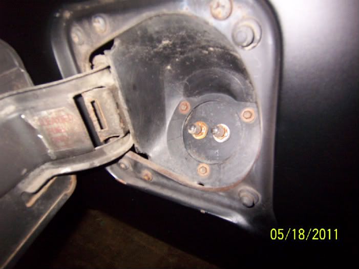

with a shrader valve set up, pull up to a gas station and air up as needed.
Funny you mentioned that!
I went out to the garage & took a picture of mine for you...right now they have a few pounds of air in them, they blow up rather round when aired to 20 psi or so & can raise the truck several inches.
The airbags definitely help with stabilizing the lean with some weight in the bed while going into a corner. I leave just a few pounds in them (per the manufacturer's recommendation) unless I'm hauling more than a couple hundred pounds, then I air it up to make up for the sagging so the snubbers don't bang. Lorne
