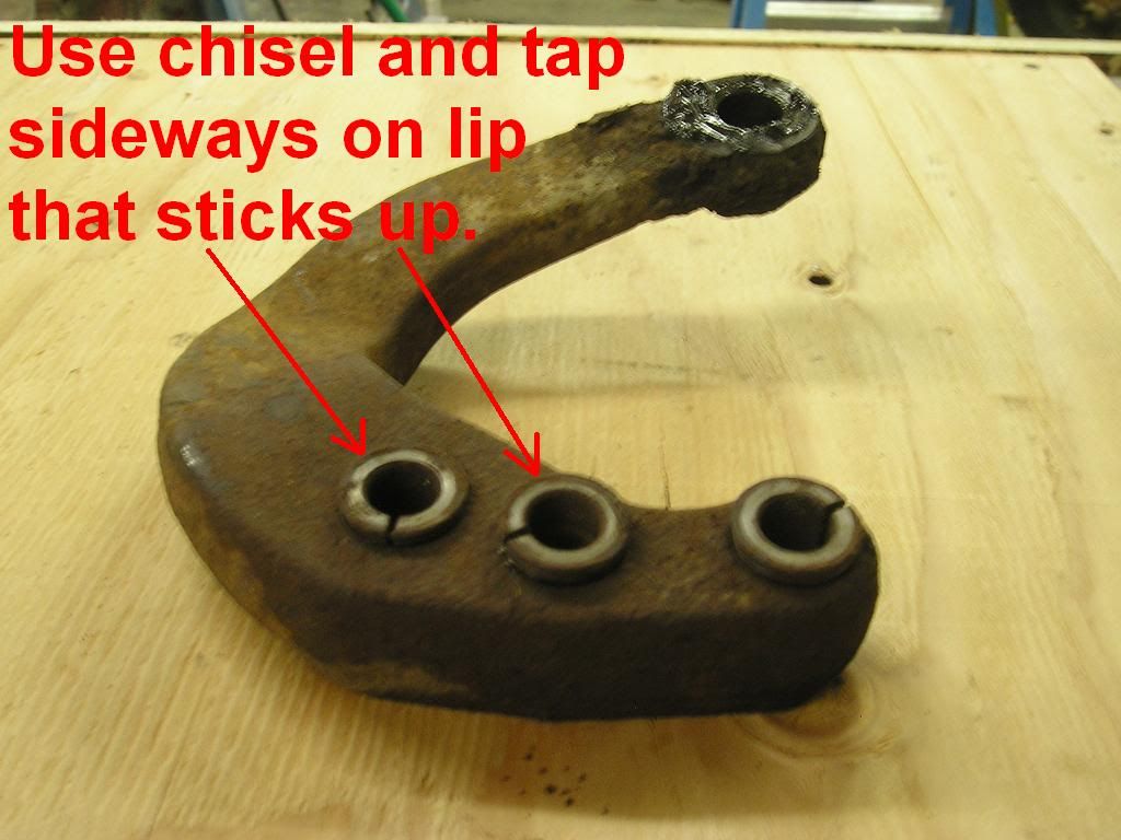

Well I guess since I'm in the middle of installing a 4" suspension lift kit on my truck, I'd better chime in here. My truck is a 1976 chassis so I'm not sure if there is many suspension differences or not.
I thought I'd have a problem with the removal of my 35 year old steering arm, but had it off in about 15 minutes. I removed all 3 retaining nuts but couldn't figure out why I couldn't get the washers to come loose. It wasn't until one came loose that I realized they were cone washers. I soaked the area with WD40 (or any type of panther piss) and began beating up and down on the arm with a persuading tool. I could see it separating from the surface below but it was stubborn. I kept at it and it just kept getting looser. I finally got two washers to come off but the third was stubborn. I ended up tapping sideways on the exposed lip with a chisel and it came right loose. Maybe you can try that? It worked for me anyways. Here is a pic of what I am talking about.
Now here is a comparison of my original steering arm and one from my 4" lift kit. It's hard to get a good accurate measurement but it appears the original arm had about a 1" drop to it, and the new arm has about a 3" lift to it. That would make sense since my lift kit is 4" and they're putting the drag link back into a factory position. Here is a comparison.
Hope this helps you.
