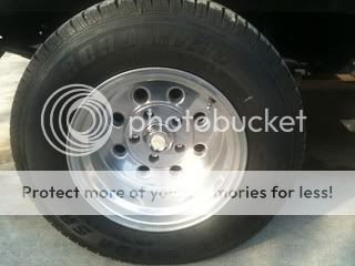

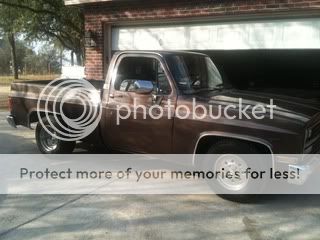

thanks for your help! i got the wheels and even got them mounted today. will post a pic shortly. the rears fit just right. now i just need to lower it a little more.
Offline lechez71
  • Posts: 101
Re: wheel question ?
« Reply #8 on: January 26, 2012, 02:33:39 am »
here a pic of the wheels the day i put them on. ive since then polished them and now they look like chrome. will get better pics when weather is better. just need to lower it a little more and get a shorter tire for the front.
