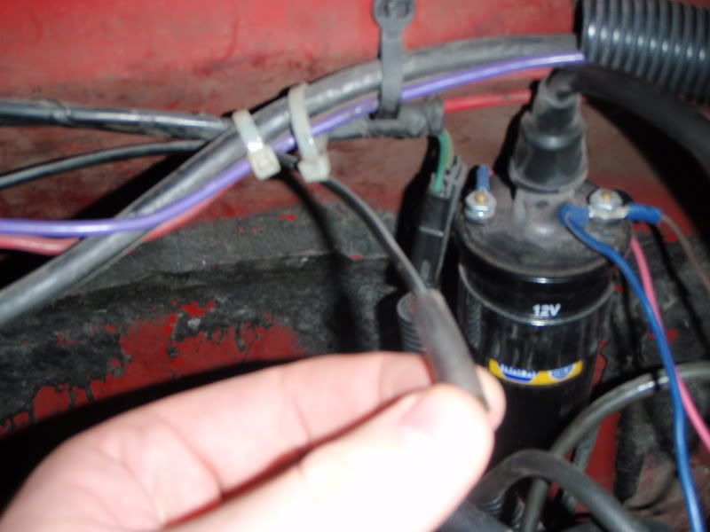

So, are you holding a wire or a spaghetti line vacuum hose?   ???

I'm holding a wire with a vacuum end that's half black and half grey?
Yeah mine runs just fine with 12 degrees initial. Pics of the wire/vacuum line? Is it a plastic tube that is supposed to run to the HVAC reserve can on the firewall perhaps?

It doesn't go to the black ball of doom. It goes thru the firewall on the passenger side. I believe below where a mess of other wires go, or maybe above??
http://i57.photobucket.com/albums/g207/hippiegohome/P4170096.jpg
