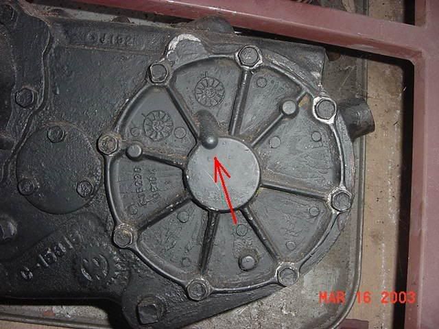

Here's a pic of the back of a 205. Ignore the red arrow and take note of the small 3 bolt retainer on the left side of the pic, a 203 will NOT have this.
John

Thanks for the replies; Not sure how to post a pic, but it doesn't have the small round with 3 bolts. Shifter has hi, hi loc, n, lo, Lo loc. Wanting to put this truck in the local "mud sling" is this transfer case/truck good for that? I'm not new to the 73-87 trucks, but am new to the 73-87 4 wheel drive version. I have some pics of the truck if I can figure out how to post them.

Sounds like you definitely have a 203. This is a chain driven case, if the chain is tight then it's a decent case but if you hear any popping from the case it'll need to have the chain replaced.
Also the shifter itself can be problematic and allow the case to pop out of gear.
