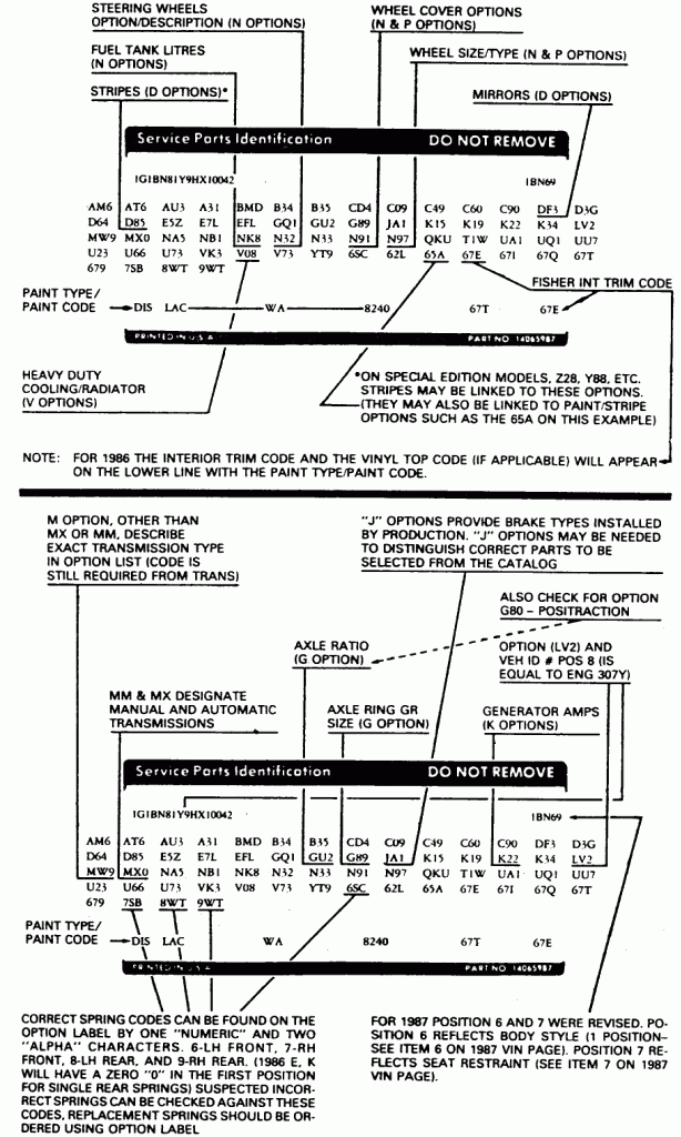

ok idk if this is already in the tech section but i found thins while at school when looking at alldata for the rpo labels so if this is helpful post if not its cool
LOCATION OF RPO LABEL
To find the location of the RPO label, you can look at the Carline chart below. Locations of RPO labels vary by "Carline." To determine the "Carline" refer to the 4th and 5th digits of the VIN label on 1985 to present automobiles, 5th digit for 1982 to 1985 automobiles and 6th digit for all trucks. See: Vehicle Identification Number (VIN)
TYPICAL RPO LABEL
A typical RPO label is shown in the accompanying image.

     So it doesn't help if your truck is older than 82 ?
Offline bigchevyc30
  • Posts: 456
  • the pig
Re: new info for the tech section
« Reply #2 on: April 13, 2013, 05:27:22 pm »
idk it might but alldata only goes to 82
