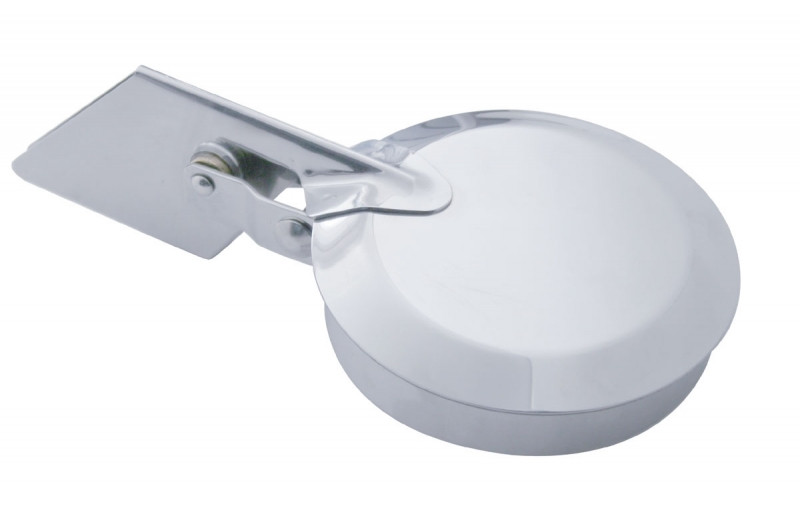

well some people say stacks are only for diesels and look bad/sound bad on gas motors, and other people are the total opposite. just kind of a personal preference i guess. as far as the water in the stacks you have a couple of things you can do here. one is that you can get stacks with flappers on them so that no water will get in, put cans over the stacks, or drill a hole in the bend and weld a nut to it and put a bolt in it then take the bolt out to drain the water.
imo when running stacks (i helped my buddies from school do it) on a flat bed it easier not to do a Y pipe and just run it like true duals, then just cut out two holes and run them behind the headache rack and use a flat plate and weld it at a 90* to the bed and use a couple of U-bolts and put them around the bottom of each stack. as far as the type of stack none of them really keep water out that much, some more than others but not alot really. the type of stack is personal preference really on what you like for the look of your truck and everything. imo i like the miter cut stacks and the big turned out bull hauler stacks!  8) lol

I lived through the 70s so I remember truck styles from "back in the day".
Don't know if you lived through the 70s or not, but since your rig is a '76 you can go full retro by using this:
werewolf this is what i ment by "flapper stacks"

I might wind up with the rain flappers, I really don't see my fire breathing (riiight) 305 thats in the truck now or the 87 TBI 350 thats going in the truck later offering enough exhaust velocity to keep the water blown out on their own.
