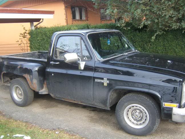

I couldn't seem to find a general thread about my truck and what all I'm doing for my build, so I figured I'd start one.  Got this thing back in September 2007, my first vehicle.  Got it running and free from a friend of my dad.  This is how it looked then:

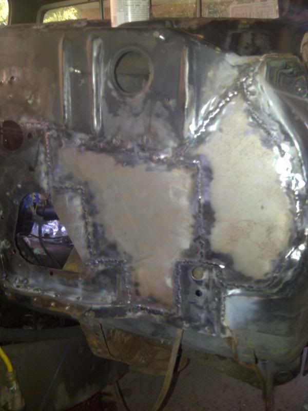

Firewall shaved (save for the wipers, booster, and column):

Firewall filler roughed in

Thanks for the compliments guys!  Not a ton of progress, just got the filler panels all tacked up on the driver's side there.  Now I gotta get all the welds smoothed out and throw some bondo on it.  If anyone else wants to shave their firewall, just know that on the driver's side there are some bends/curves/whatever in the metal, so if you want it completely flat you'll have to re-work some of the areas along with doing your filler panels.

Tiny bit more work on the firewall:

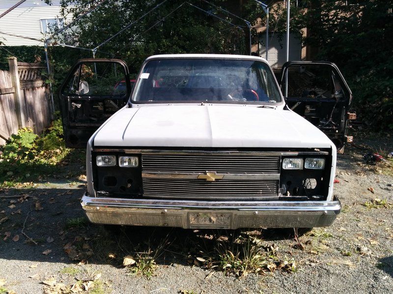

Got work done on the driver door. Still have to fix the sag on that side, as well as do the latch and such, but now both doors are backwards! Not the greatest pic, but you get the idea.
