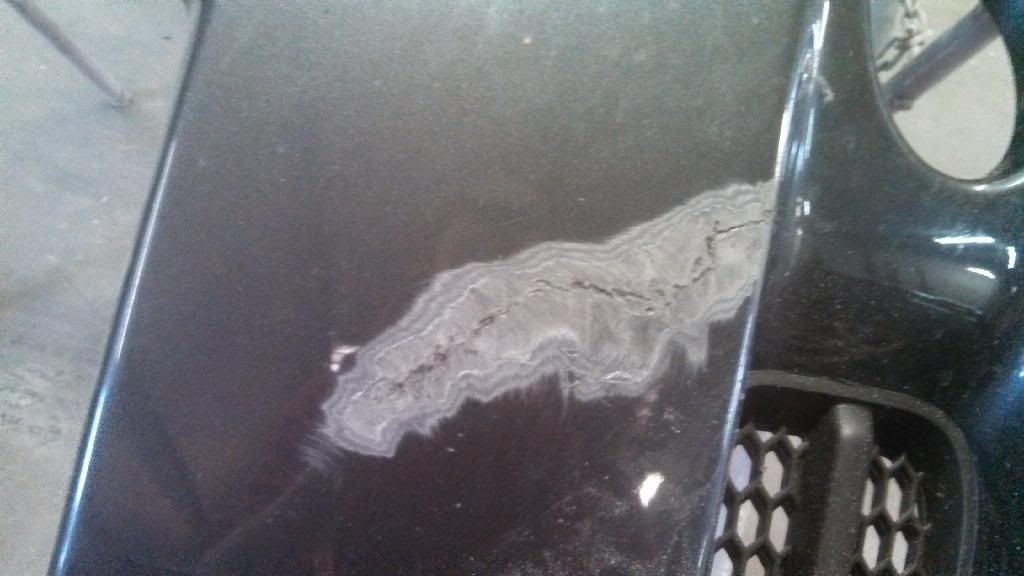

started doing body work about a year ago at the dealership, who would have guessed that would happen? lol. anyways i ended up having a pretty good knack for fixing ripped bumpers with my butane soldering iron. just thought i would post some pics and see what yall thought and maybe get some constructive criticism from fellow collision techs
rip "welded" up on front and back

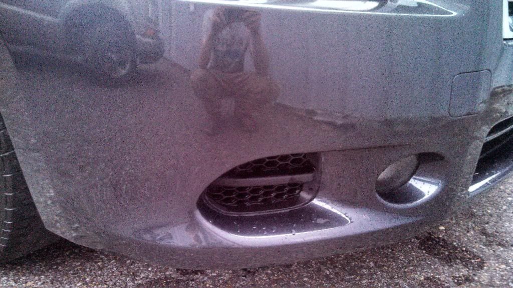

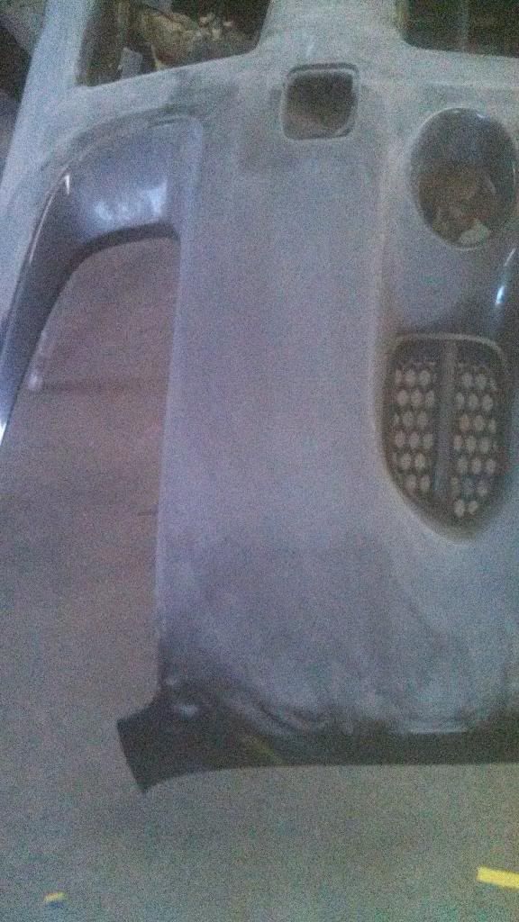

wiped some putty coat, blocked it then primed and blocked.
ready for pick up :)

Looks good. I have fixed a few over the years. There are a few good products out there that work well without a torch too.
