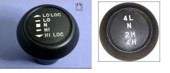

     Let me see if I can compile this correctly for pics.
NP203 shifter knob:
shift pattern:
np205 shifter knob and pattern:
np 208 shifter knob:
     The shift positions of the NP208 are as follows from the most forward position (towards the engine) to the rear most position: Two Wheel Drive High Range, Four Wheel Drive High Range, Neutral, Four Wheel Drive Low Range The NP208 shift pattern is not straight forward, it has to be pulled to the side and back to enter four wheel drive low range mode.
     Oh course there are variations of shift patterns on the knobs especially between vehicle manufactures and the after market guys.  But if you do a search on the OL internet you will or can see all the variations.

Thanks for the info. My shifter knob is the first pic of the 203. I had thought mine was either a np203 or a Dana 300 but that's a jeep case.
