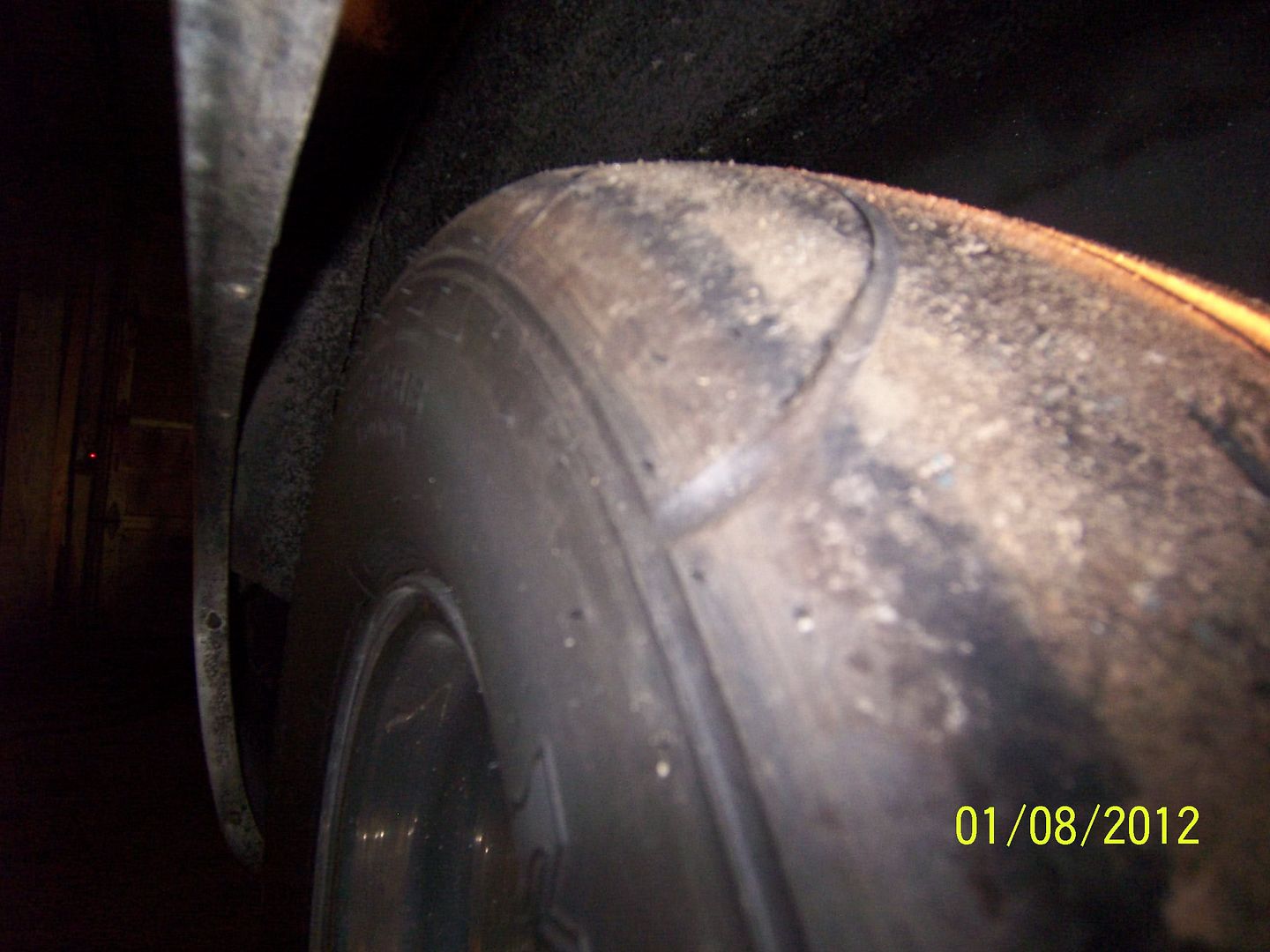

Mine are about 12" wide total & have plenty of room for another inch just by moving the wheelwell back flush against the spring. There is also another 2 1/2 inches in "wasted space" between the spring & frame (where the shock mounts originally) if you want to get creative thinning down the spring hangers to move them closer against the frame & just move the shocks to the inside.
Here's a couple pictures to give you an idea of my clearances. Lorne

Ya, I discovered that once I actually got the truck here where I could measure it. I've been running ideas through my head and some of them I knew would work because of other trucks I've done it to or seen it done to. I've never put wide tires on one of this type before. Turns out the springs are inside the inner wheel wells and won't interfere with the tires anyway.
