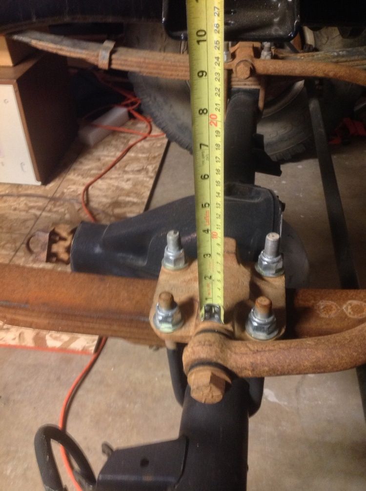

     The third pic of your sway bar, except it is chrome, is normal at least from the one side.  Here is the truck in my garage I am working on, it is a k10, it is a 77.
     As far as your lift goes, I measured front and back on this same truck, it has a Rancho 4" on it, but it is unladen, meaning no bed, cab, or anything on it or hanging on it yet, just the axles.
     Front:
     Rear:
     If you notice they are both sitting about 10" from sway bar/spring mount on the front and the same on the rear.  The rear has 4" blocks on it and the stock springs, if it was a all spring lift, that measurement would be for greater than 10" or so.
     Hope this helps out.
