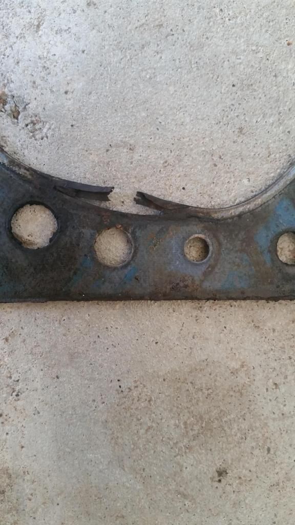

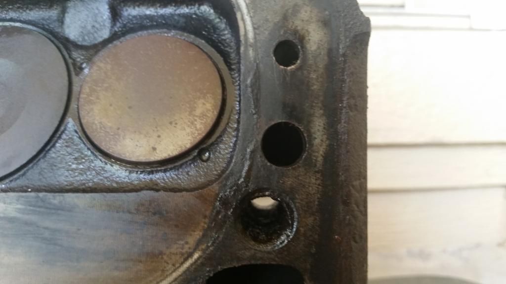

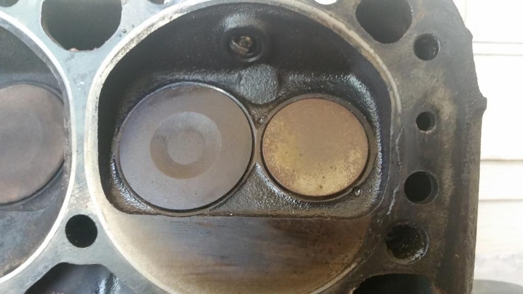

Alright, here's the gasket (Both sides of it), and the chamber for that cylinder. The only thing I see is some spots that have been LIFTED (Towards me when facing the chambers). Some of it flaked off, some of it seems to be stuck on there.

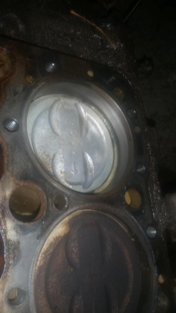

And here's the piston's. I'm fairly sure these aren't stock, and it's an .040 bore (It says 040 on the top of the pistons, anyways)

Clean up the head and block gasket surfaces using some 100 or 120 grit emery cloth wrapped around a hard, flat sanding block.  Then, check the gasket surface for flatness using a long precision straight edge.  If the fire ring surfaces on the head and block are not eroded (notice the shiny 'ring' imprint surrounding the combustion chamber that corresponds to the metal edge that tore and flaked away from the gasket in your image) then I agree with Engineer - you do not need to machine the head or block.  How do the bolts look?

When the head gasket failed, hot combustion gases blew past the fire ring into the coolant passages.  Over a long enough period of time hot combustion gases can etch (erode) the sealing surface of the head.  The sealing surface where the fire ring seats must be absolutely flat.  If there is a "dip" in the surface the new gasket won't hold.  So, after sanding the surface as described in a previous post, place the straight edge across the head at the location the head gasket failed and make sure there isn't a low spot or gap between the straight edge and the head surface.
