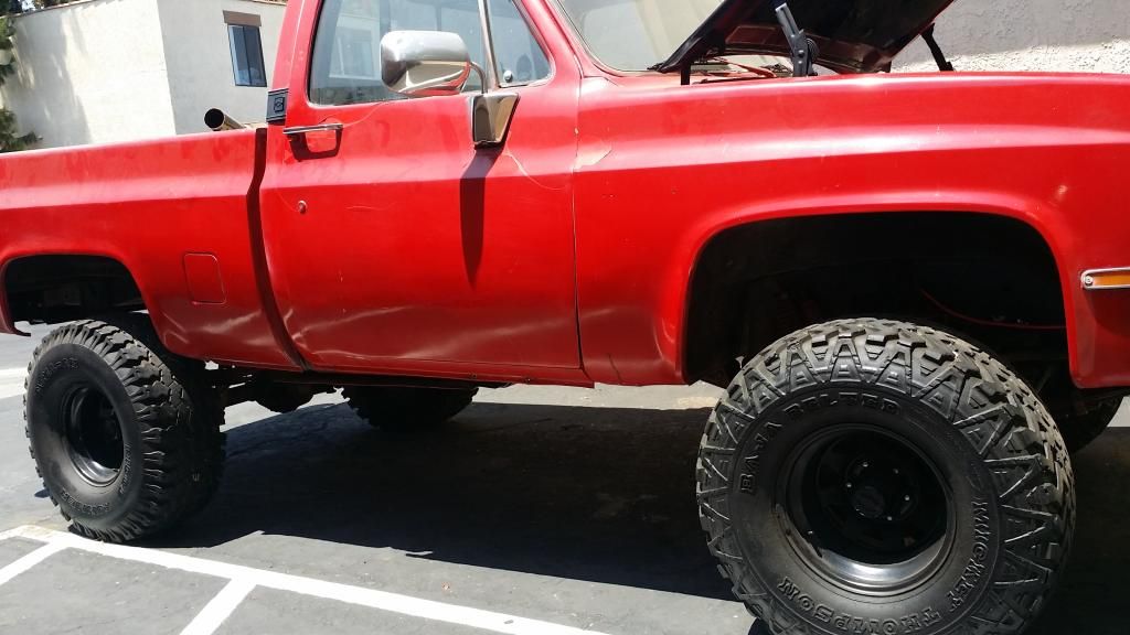

Hello everyone.!!
i have a 79 k10 with a broken frame, and i found another frame in way better conditions,
im just wondering:
-how much a shop will charge me to swap it?
-What if i do it my self. what im really getting my self into.?
-is it simple or is it gonna be a headache?
-Is there anything i should know before i start taking everything apart?!
"thank you guys, have a great night/day!
