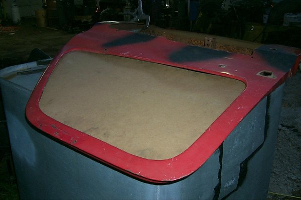

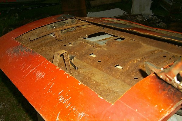

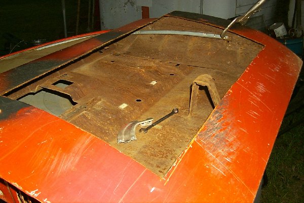

The amount of effort you are going to put into this isn't going to be worth it.  In 2000 I started the process of trying to determine how to do this.  There is no good way to do this yourself.  For the price, the kit is worth it..  If you price new vent windows and weather stripping this is going to be within the same price range.
This is from February of 2000.  I had them sorta rolling up but not great and the marguard would bind.. A LOT.  If I could have done these cheaper, you would see them in my truck, but OPP's is much more cost effective.

I cut them open to R&R the kit. That was 14 years ago.  WOW...
