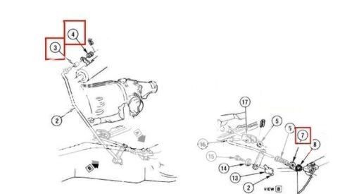

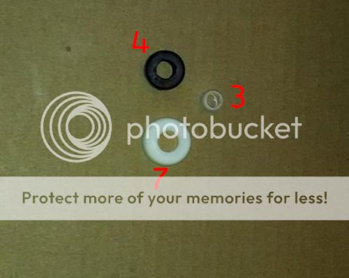

couple things make sure the rubber/plastic bushings on the shifter linkage are still intact and there

Great suggestions! I did actually replace the shift linkage and bushings (w/OEM parts from a local GM dealer) from the column to the bellcrank on the trans. Mine were all pretty worn or rotten from years of salted roads. So bad I could not manually select Low 1!
I also tried one of the universal linkage kits, but could never get it adjusted to selector gate in the column. Nice hardware, but a waste of $ in my opinion.
