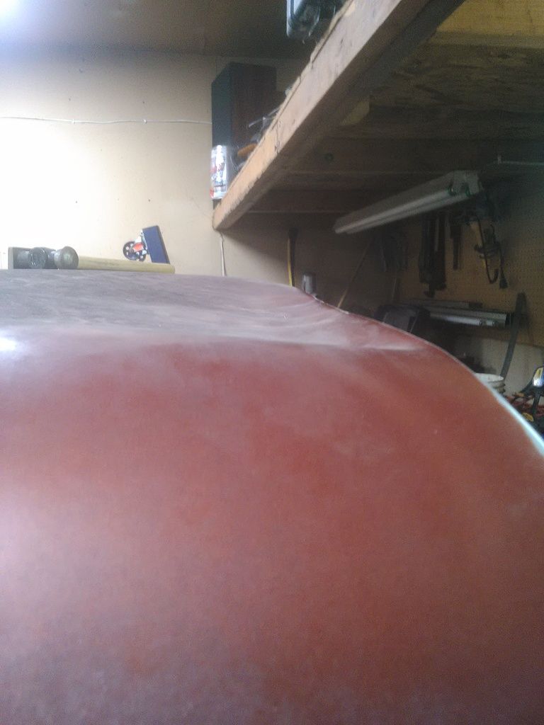

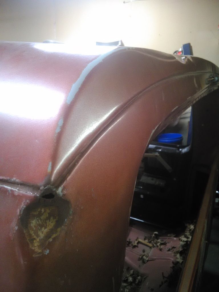

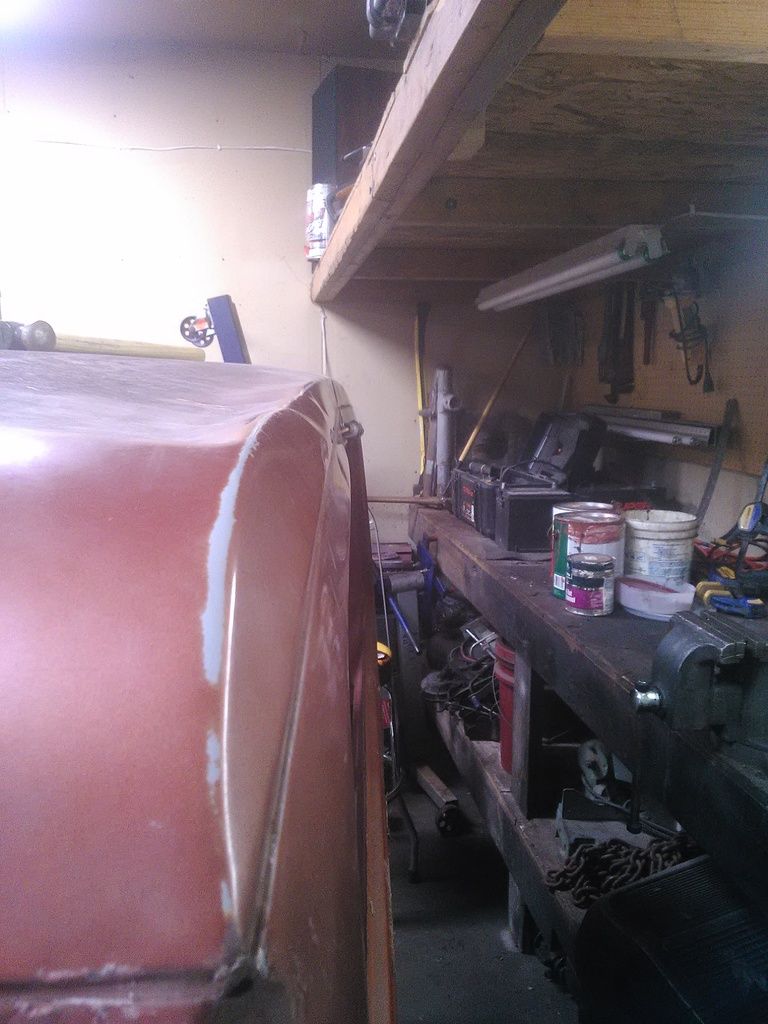

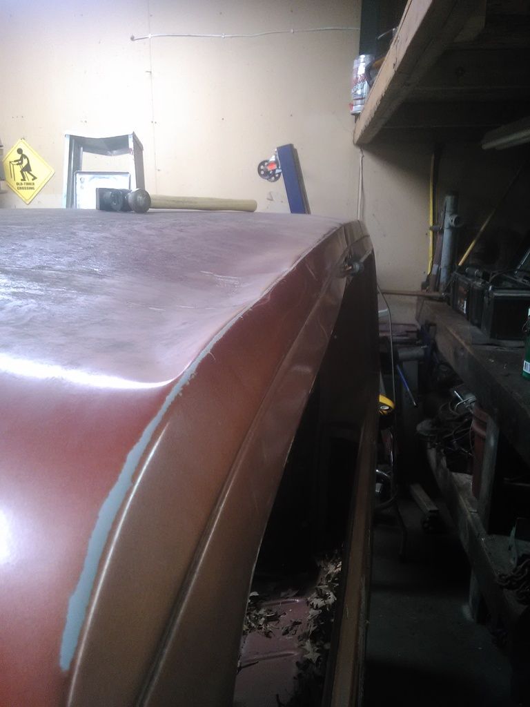

So, I bought a new cab because the rockers and and floor pan on mine are shot. The new cab has a few dents and dings, most noticeable on the roof.
If you can see in the pictures, the whole thing is pretty much bent in. How challenging would it be to cut out all that stuff, and cut out the same parts form my other cab? Or would it be easier to cut rockers and stuff off this cab and weld in to my old cab?
I was debating on cutting along this body line. Drilling out spot welds and such. But then im still left with a bent window frame. What would you guys do?

OK, without having both cabs in front of me, I would think about using the good floor and rockers on the old cab.
1. That hole in the corner of the roof will come back and haunt you.
2. It is going to be difficult to straighten the creases and dents along the back window.
Now, I would literally replace the whole floor, drill out all the spot welds, along the firewall, rear of cab, along the bottom of the rockers(the inner rocker is part of the floor). For the rockers and cab corner, get fancy, try to take the minimum from the old cab, and definitely try to measure alot, cut the "new" metal larger, then trim the old cab till they fit together.
That would be my approach if I felt fixing the roof would be too difficult to fix effectively.
