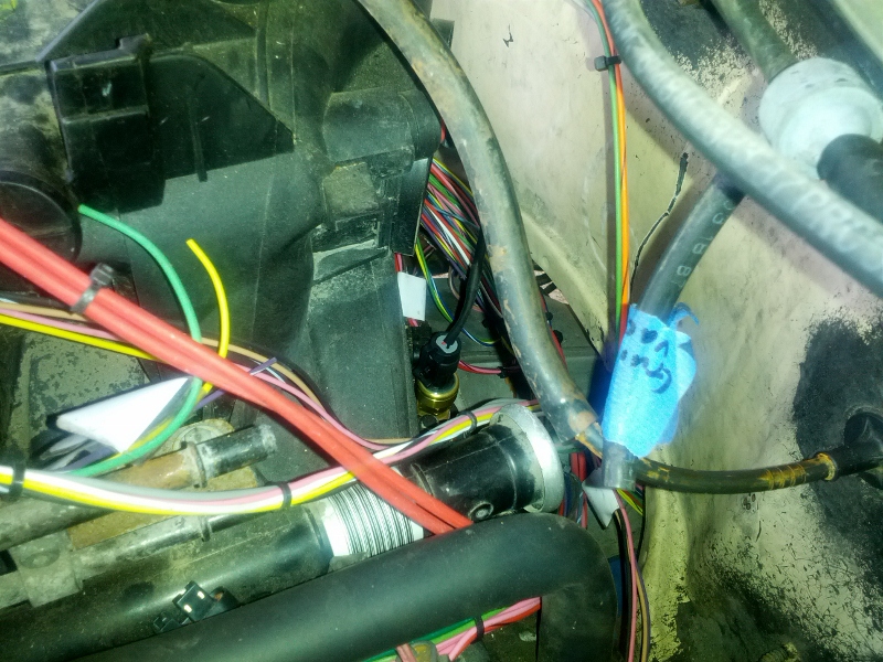

Who's harness are you using?  The one at the back of the intake isn't used on standalone setups.
Offline Colby
  • Posts: 43
Re: Swap questions - 74 K10 - LQ4 6.0L
« Reply #16 on: February 16, 2015, 10:32:44 am »
I had Adam at lsxharness do my harness.  It came back with those plugs intact.
« Reply #17 on: February 19, 2015, 08:21:01 pm »
It is here:
If you have a stand alone harness it shouldn't use this sender.  It would be for the factory setup...
