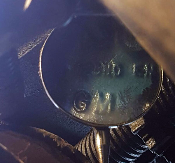

I looked at the back, behind the driver-side cylinder head, and all I see is GM, the number 2, 5.7 L, and Hecho en Mexico. Notice that it's painted a light blue, isn't that odd?
And I've looked at the engraving at the front of the passenger-side cylinder head: 1M0818 6G35

The head numbers are usually cast between the rocker towers.
http://www.mre-books.com/chevy/engines/parts_interchange/cylinder_heads.html
The block casting number is usually behind the LH cylinder head parallel with the bellhousing mounting face.
If all it has is GM and 5.7L you probably have an LO5 350.  The blocks with this cast behind the LH cylilnder head have the casting number behind the RH cylinder head.

LO5 goes all the way back to 1987.  It's the first TBI 350.
There are a lot more than two casting numbers.  Look behind the RH cylinder head where you found the 5.7L cast on the LH side.  The only way to verify a 4 bolt main block is to pull the oil pan.

Turns out I have this engine.
5.7L 350CID (LO5-K) 1987-1995 CHEVY & GMC FULL SIZE TRUCKS & "G" VAN - OVER 8,600 GVW

Cylinder Head Specs:
 - Casting number 14102193
