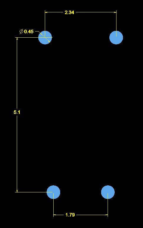

350 mount on left, 454 mount on right:
350 frame mount bolt pattern:
454 frame mount bolt pattern:
Bolt patterns laid over each other:

That part i understand what i mean is the mounts that bolt to frame i seen someone on here mention it i have new 454 mounts im just wondering about the ones that bolt to frame

that bolt pattern is the pattern that bolts to the frame side. If you have a frame that was intended for 454, you likely have the 454 mounts, but I am not certain that there are different frame side mounts. See attached picture. This is from when I put in the aftermarket crossmember. See there is an extra hole that might fit the 350 mounts? You would have to try it. The bottom center hole is the one that fits the 454 mounts.
