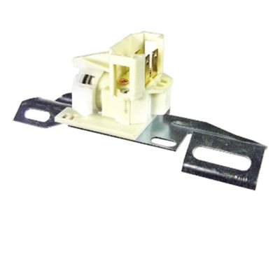

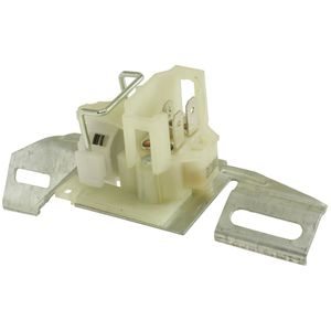

i just bought a 1984 c10 square body and im trying to get the gremlins sorted out before winter storage. the problem is my high/low beam siwtch down on the column is broken/not working correctly. i bought a new one off of amazon and the bracket does not line the pin hole for the rod correctly. my steering column is a tilt steering if that makes a difference? every site i looked up all gave this same switch so i thought it was right but it does not fit?
i am attaching 3 pics showing what i ordered and the OEM plug that failed.
i verified the part on amazon, rockauto and   before buying and all three show only this part for my truck?
as you can see in the 2nd pic the new bracket sets the plug lower so the rod can not reach the hole to push it?

not sure if that came out of chevy truck. all the ones ive seen look like the one they sent you. But i found similar ones
first contestant, out of an 82 g10 van part number UDS436
https://www.autozone.com/electrical-and-lighting/dimmer-switch/duralast-dimmer-switch/91163_0_1985
second contestant out of an 83-94is cars/van or s10 part number UDS424
https://www.autozone.com/electrical-and-lighting/dimmer-switch/duralast-dimmer-switch/129650_0_0_20775
i personally think its the first one the second one looks too long

What's confusing is the part I am trying to replace has a square area near the hole is for the rod to push..
The photo for the 2nd one you posted is round. Maybe it's an updated part? I wonder if the frame aligns the part for the rod?
Sent from my SM-G920V using Tapatalk
yeah sometimes they will come out with an updated part that looks a little different but functions the same
