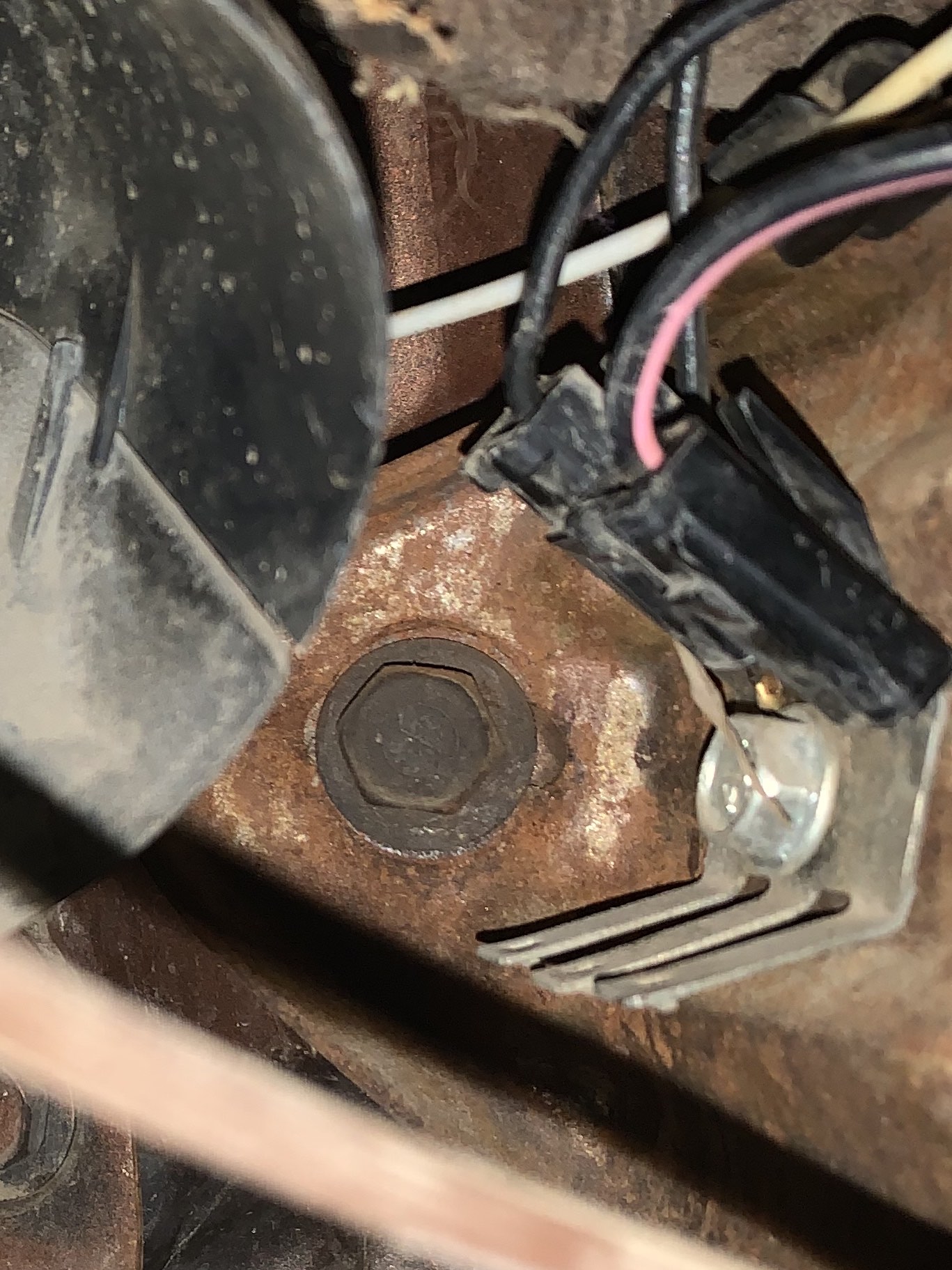

Imaged below is a typical ground bus bar mounted to the park brake pedal frame at the left interior kick panel that is used for cabin interior and instrument cluster ground connections.
Occasionally, the bus bar is absent and the typically black factory ground wires are attached directly to the bare metal frame of the park brake pedal or the kick panel sheet metal.
Ground connections are crucial for proper electrical functions and should be disassembled and burnished to shiny bare metal.  A liberal coating of antioxidant paste is an excellent idea to help maintain good connections over the long term.
