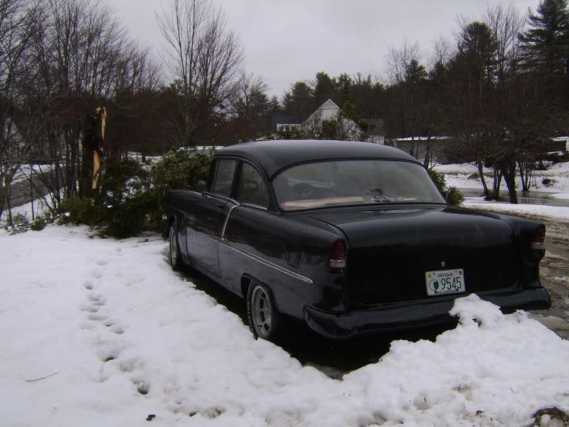

As you can see on my picture! I got a little surface rust on the bed.
Do I need to wire brush it, grind it, or sand it? Or all of the above?

I would sand it with 80 then 180 grit DA. Then use POR 15 or what I use cheaper version of POR 15 Chassis saver. BAout half the price. Spray or brush it on then prime right over it.
http://www.streetperformance.com/writereviewsp.php?sku=311
The roof of my 55 looked like that. I used Cjhassis saver, then 5 Star three part urethane high built primer. Sanded the primer, then top coated it with Omni Single stage Acrylic enamel.

I too agree with Blazin, if it is just Surface Rust with no or light scale, 80grit followed by 180grit should be more than enough to get down to a level of it being treatable... Would also suggest a DA(Dual Action) Orbital Hand Sander, just to make it easier, since there are fairly large/long surfaces you are going to cover... By Sanding by hand, it would take you way too long, and you would probably lose interest in your project fast!! When using an Orbital Sander, I would recommend keeping your movements in an X type Pattern, towards the front or rear of the truck, as it would make your sanding less noticeable when your new Paint Job is dry(Trust me, nothing looks more frustrating than seeing swirl sanding marks in a new finish, especially when they are in an up and down pattern that really makes them stand out!!!)...

Does it matter if I have a few small holes along the side where molding screws were removed and a few small dents?

You need to weld the holes up. Pull the dents if big enough, if just dings make sure there are no high spots around them and hit them with a touch of body filler. If the dings have rust in them you need to sand blast them first before grinding and filling them.
I agree with Dragon on the x pattern of sanding.
