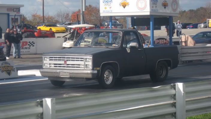

 I moved my front hangers up about 2 1/2" some years ago (I've since moved them back to stock & did a flip on the axle) will no real ill effects. With a 2" dropped shackle in the rear it sat fairly nice, lowered the back about 3 1/2". All of the holes needed to be drilled. Lorne
 Here is a photo when it had the front hangers moved & dropped shackles
