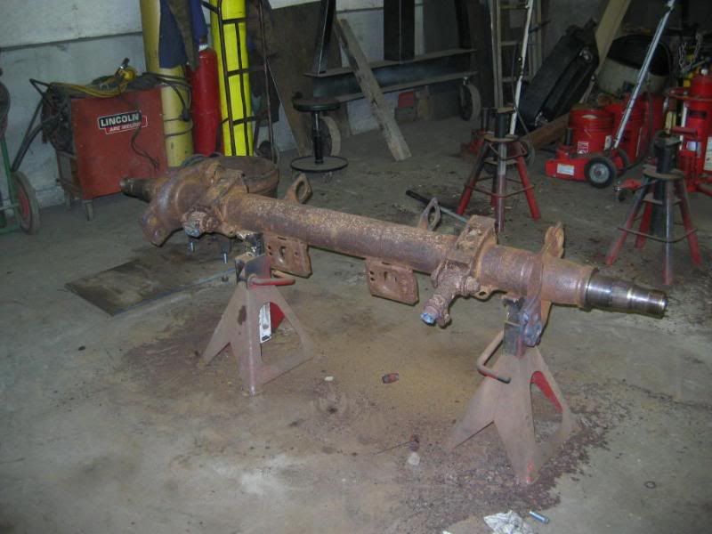

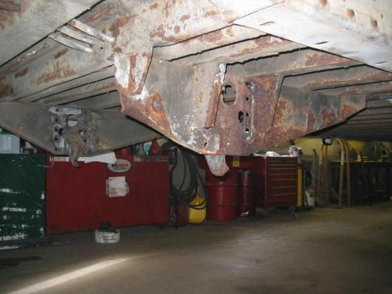

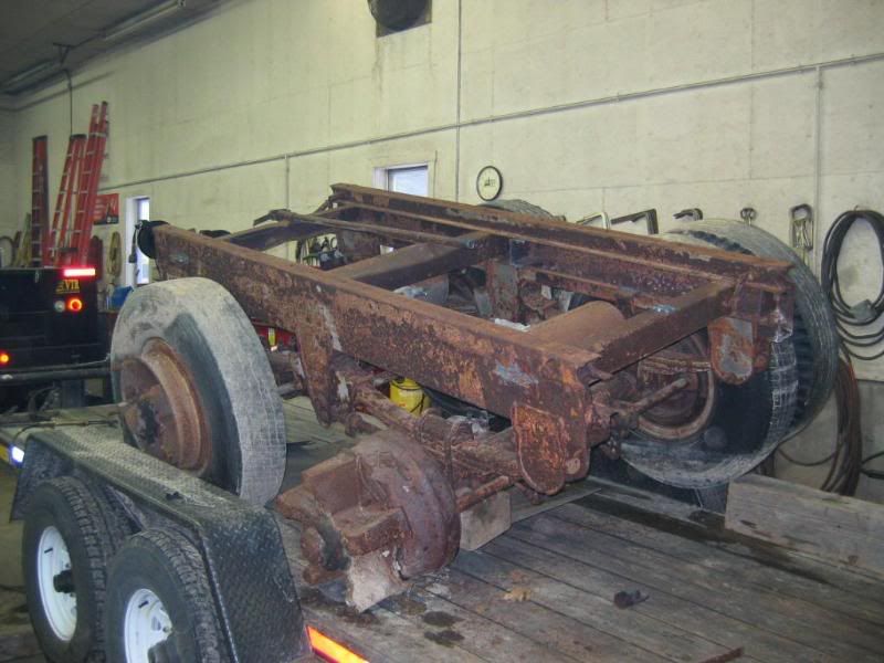

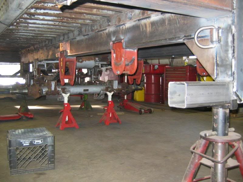

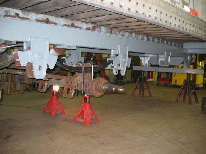

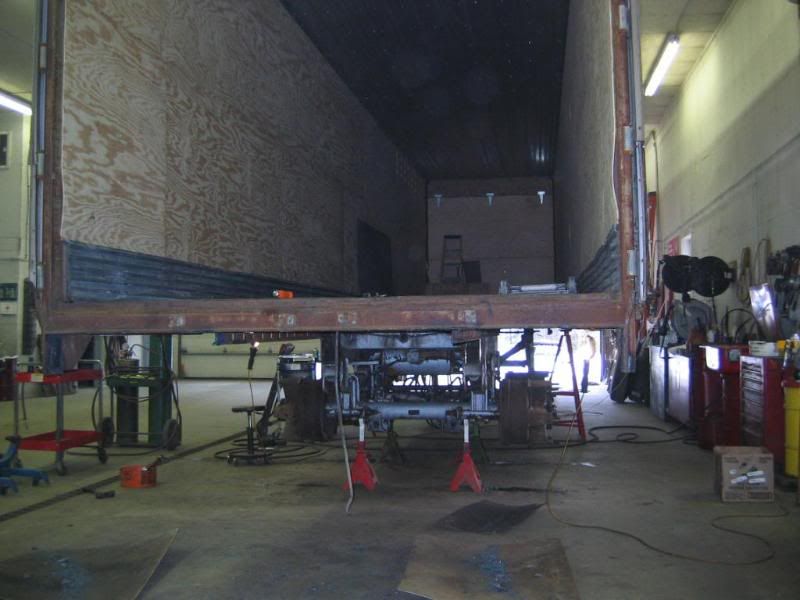

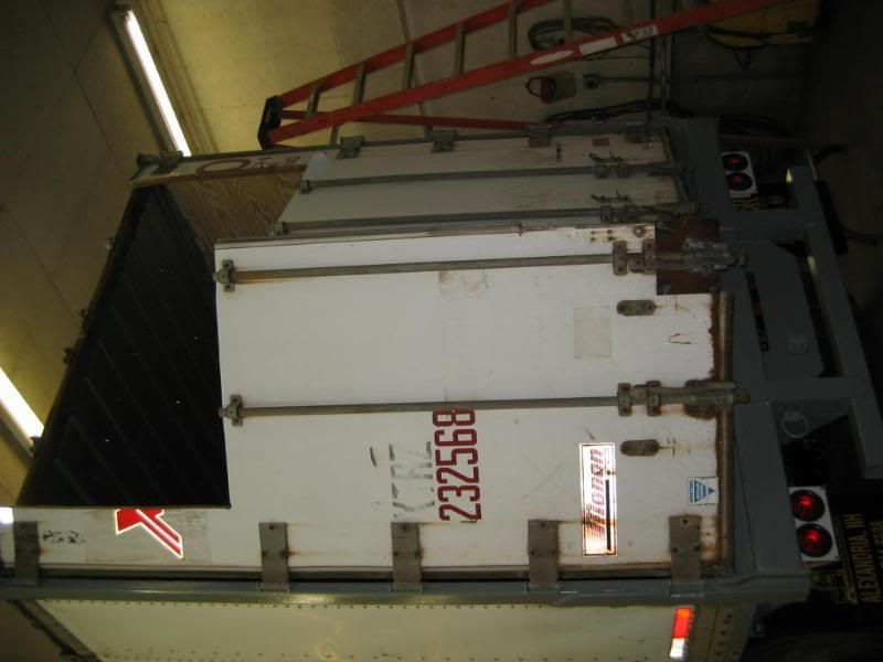

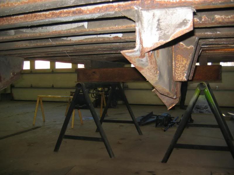

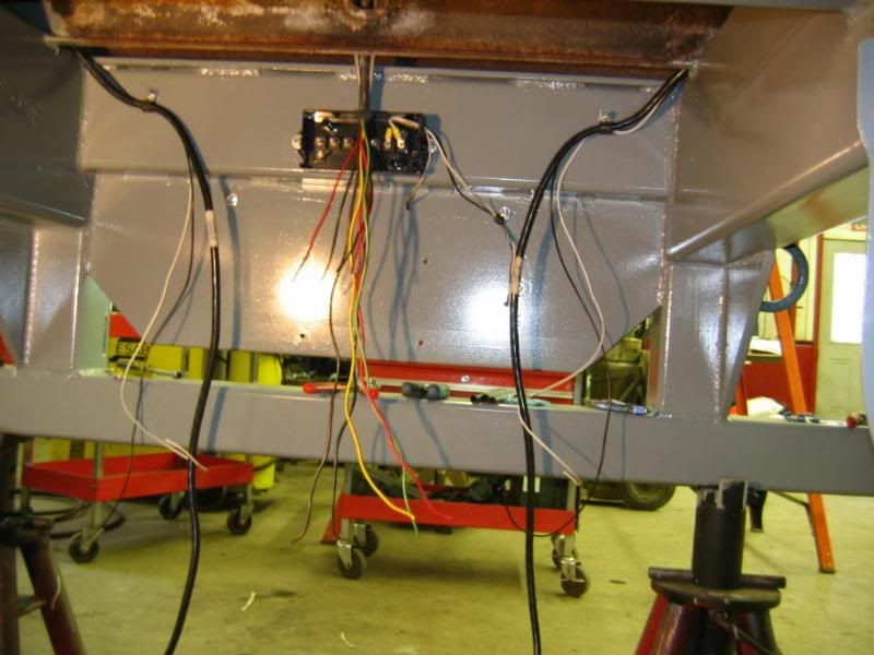

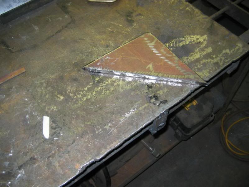

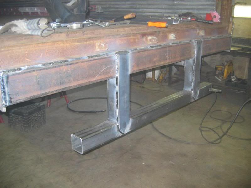

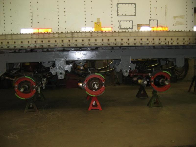

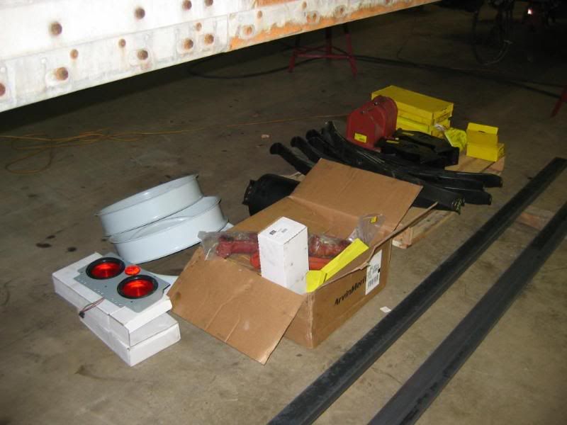

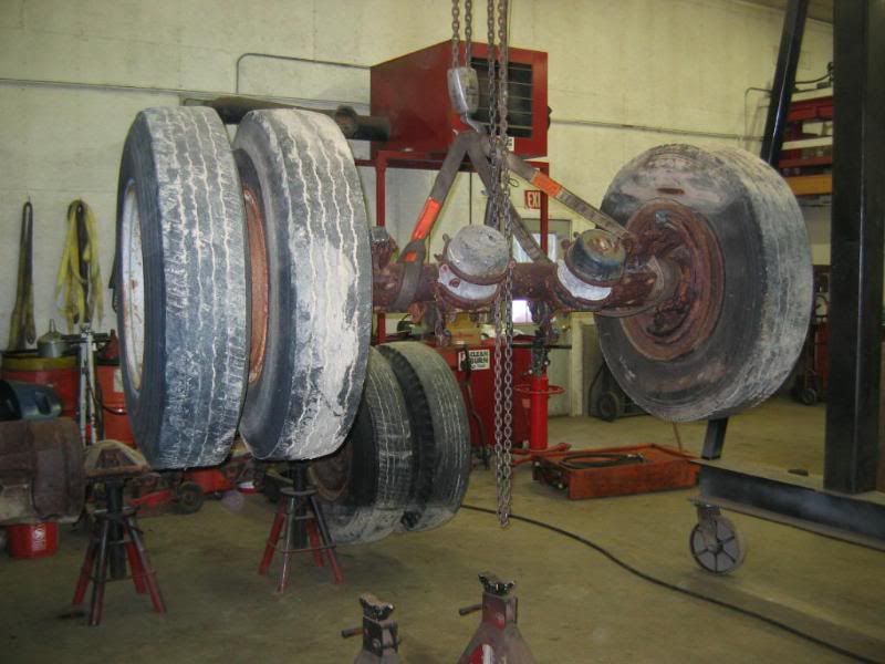

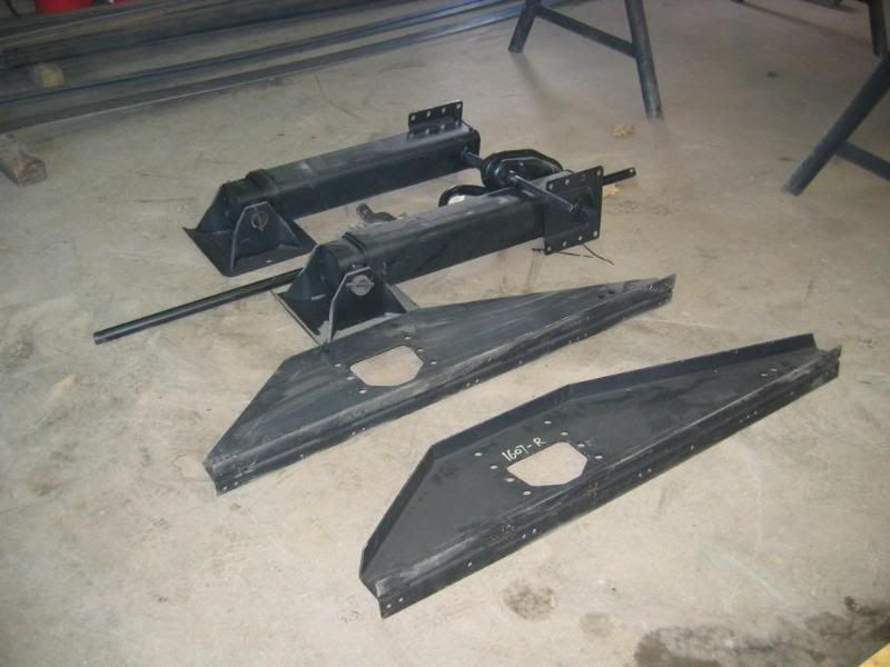

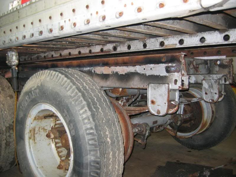

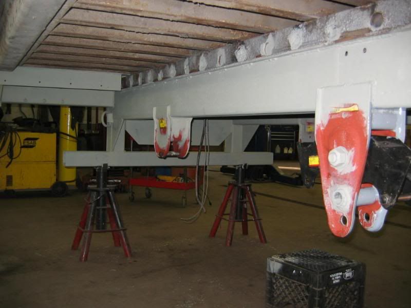

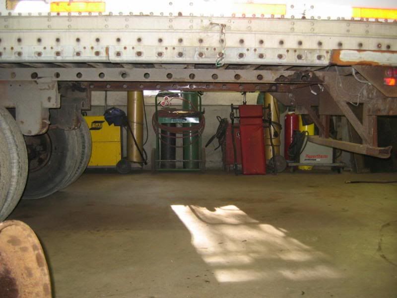

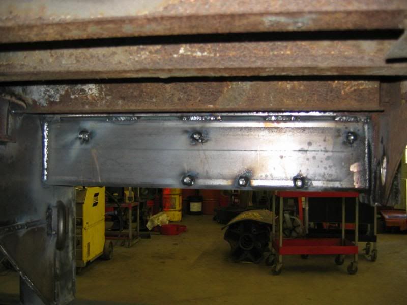

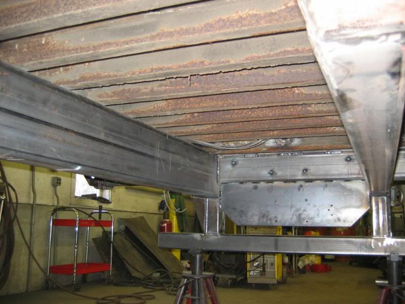

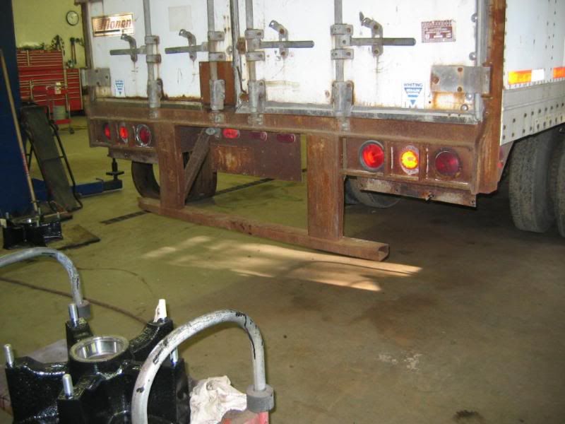

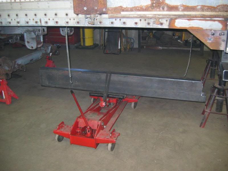

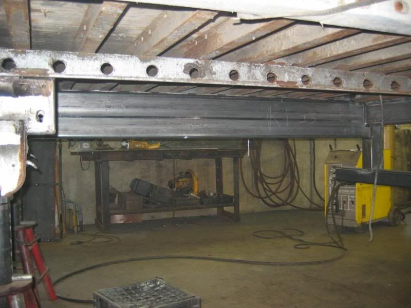

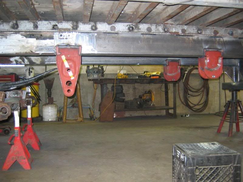

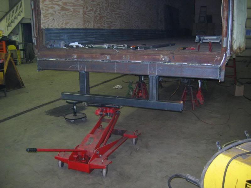

Another chip trailer, but this time we are building it from a railroad freight trailer. The others had allready had the third axle added.
Before:

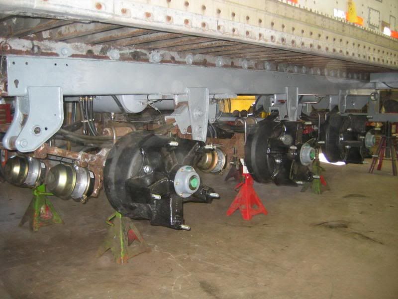

Our donor third axle:
Cutting all the old junk off:

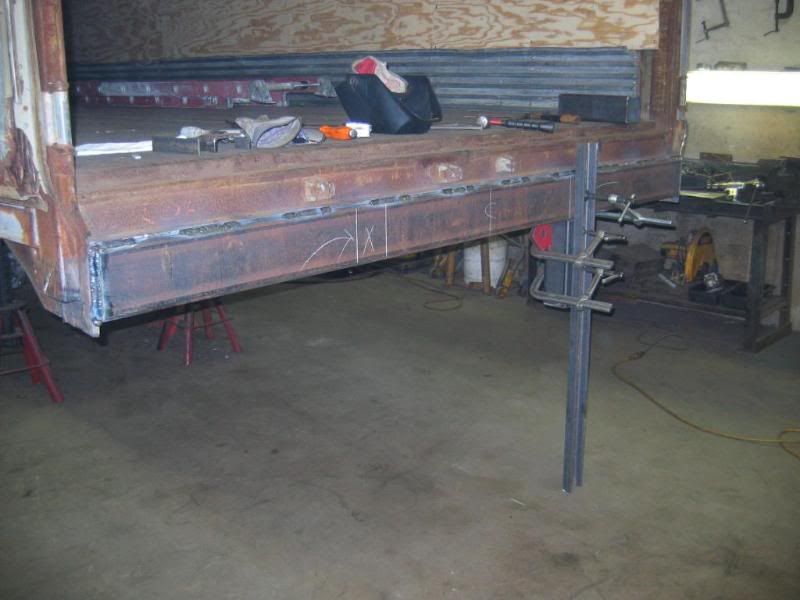

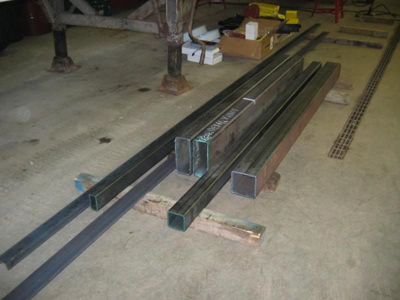

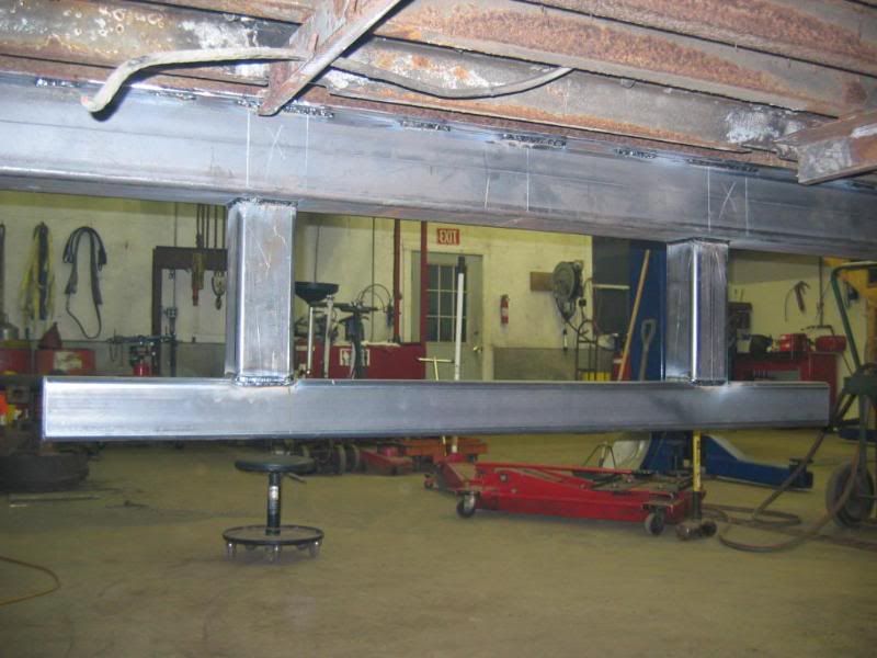

The new rear bumper, frame extensions, and landing gear steel:
Pile of money on the floor:
Starting fabrication:
Sliding the new frame rail in:
Frame welded in, making gussets:

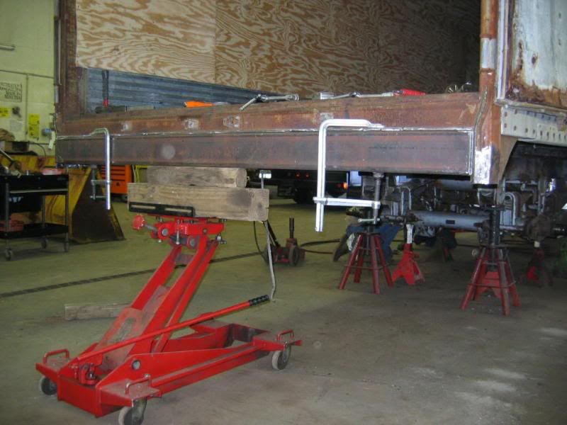

Lifting the box off the carrige to remove the nylon slide strip:

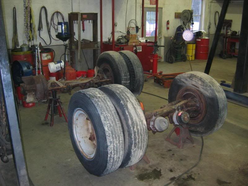

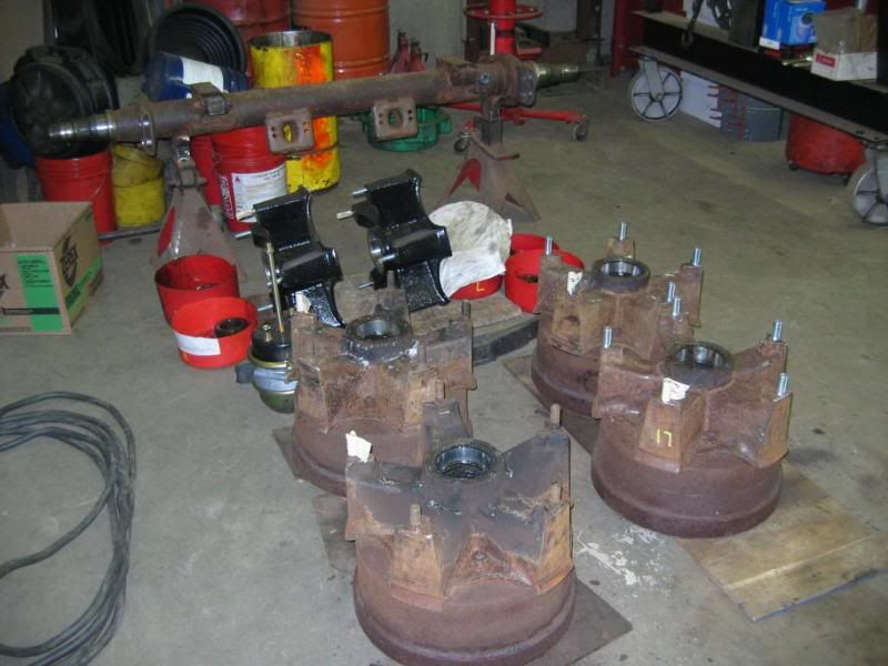

All the drums are removed, needle scale the spokes, and Chassis Saver them:

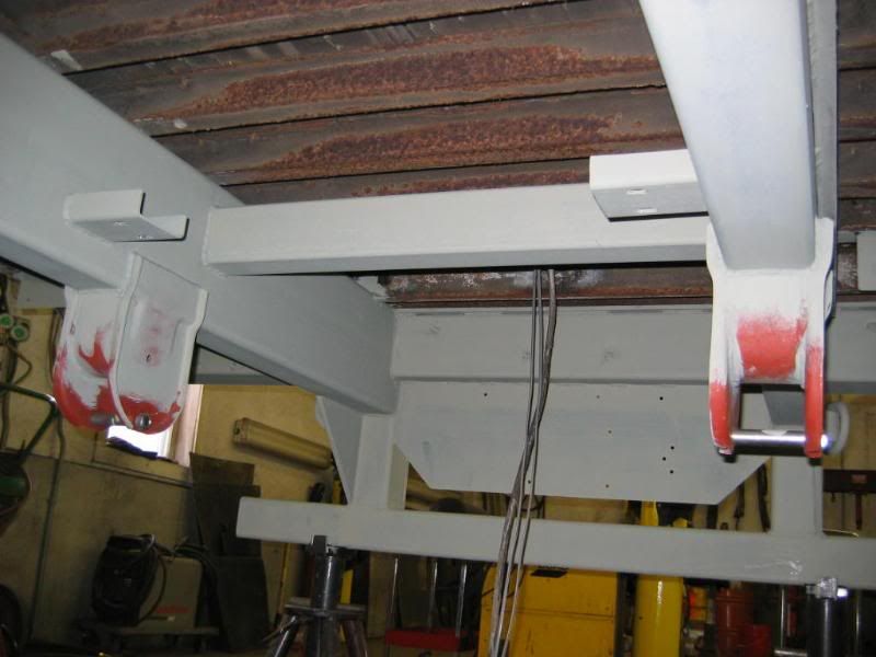

Getting ready to install air tank mount tabs, and cross members:

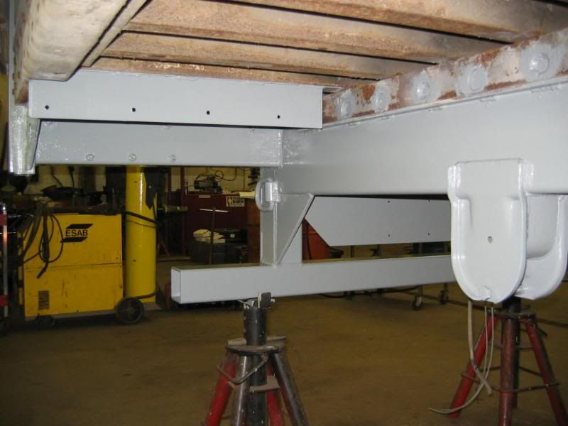

New spring hangers:
5/16 studs for lights, and wire hold downs:
Cross members, mud flap tabs, air tank mounts, and starting paint:
Fun with wiring:
Ready for thrid axle, and brakes:

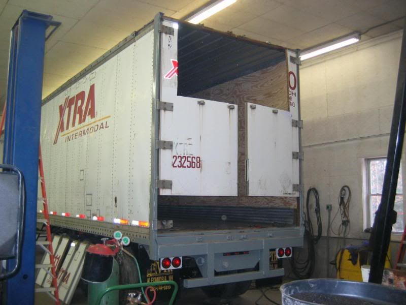

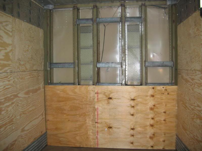

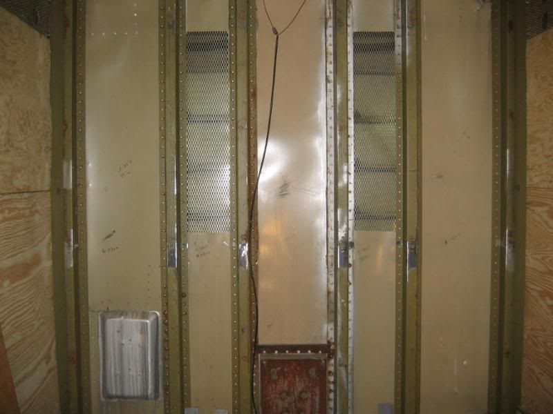

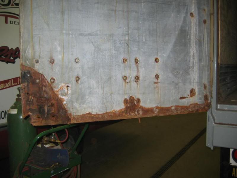

The owner of the trailer hired a no mind to cut the doors and do the interior work!. He just hacked a hole to small in the tops of the doors!
This is what he left for good on the bottom!
We cut the rotted out bottoms off the doors, and dropped them down a set of holes on the hinges:

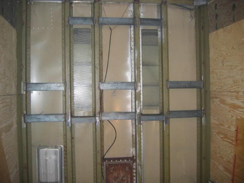

He also managed to screw the front wall up. Used very thin plywood witch the chips would have blown through in several loads. Made the vent door full width across. He also didn't run the plywood all the way into the corners. We tore that out. Welded fillers in at the bottom of the vent screens, so chips can't fill the wall. Installed backers for the plywood seams to land on. Made a vent door that only covers the vent holes.
Old landing gear partly cut off:
New landing gear and mounting plates:
Still working on this project. This week is getting the new landing gear on.
« Last Edit: February 22, 2010, 02:44:25 am by Blazin »

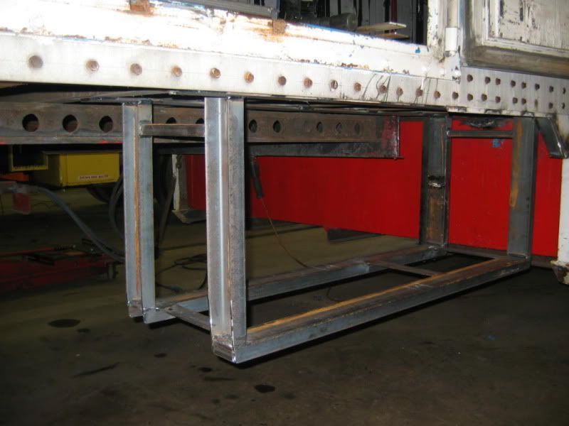

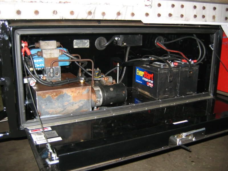

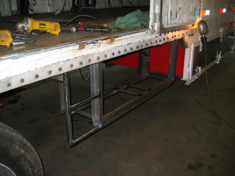

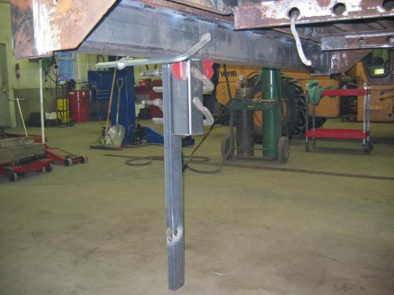

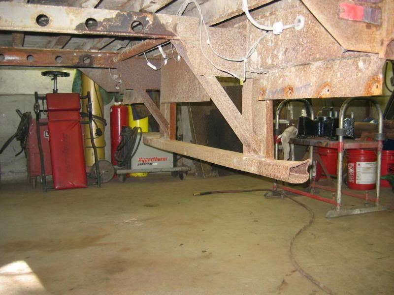

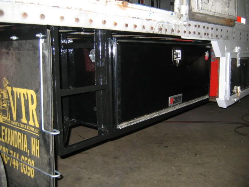

Well figured I would put a few pics up of a little project I did this week at work.
Old moving trailer. The guy uses it to transport bikes around the country for people. Hauls them to Daytona, Sturgis, Myrtle Beach. etc.

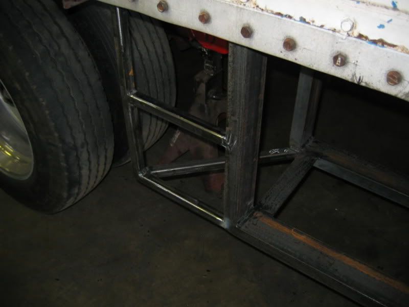

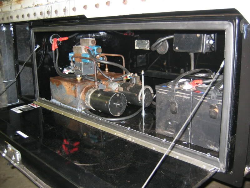

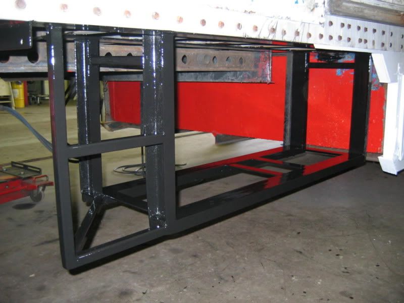

The batteries, and power pack for the lift gate were in a box under the trailer just in front of the tail gate. It was rotted just about off the trailer. I moved it up under the side door, fabricated a ladder to climb in easier. Extended the hydraulic lines, set it up so the controls are plug in, and can be 20' from the trailer while running the gate.
