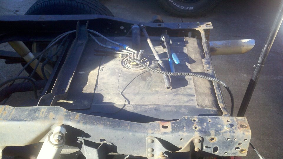

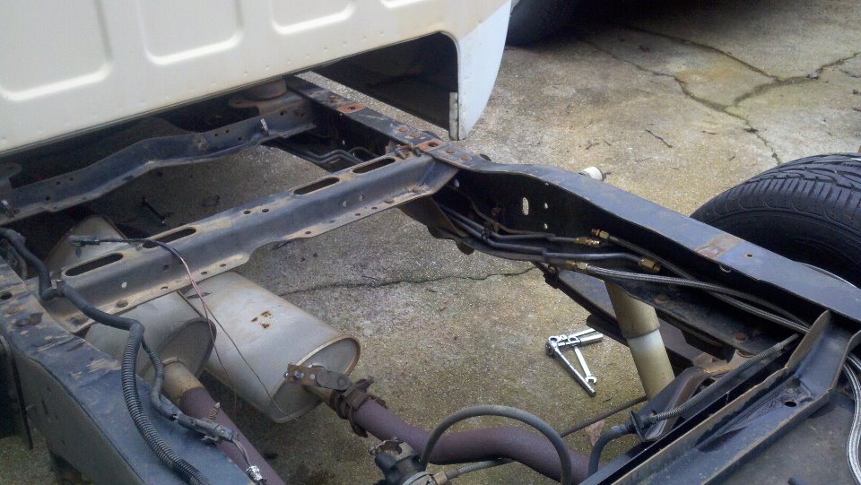

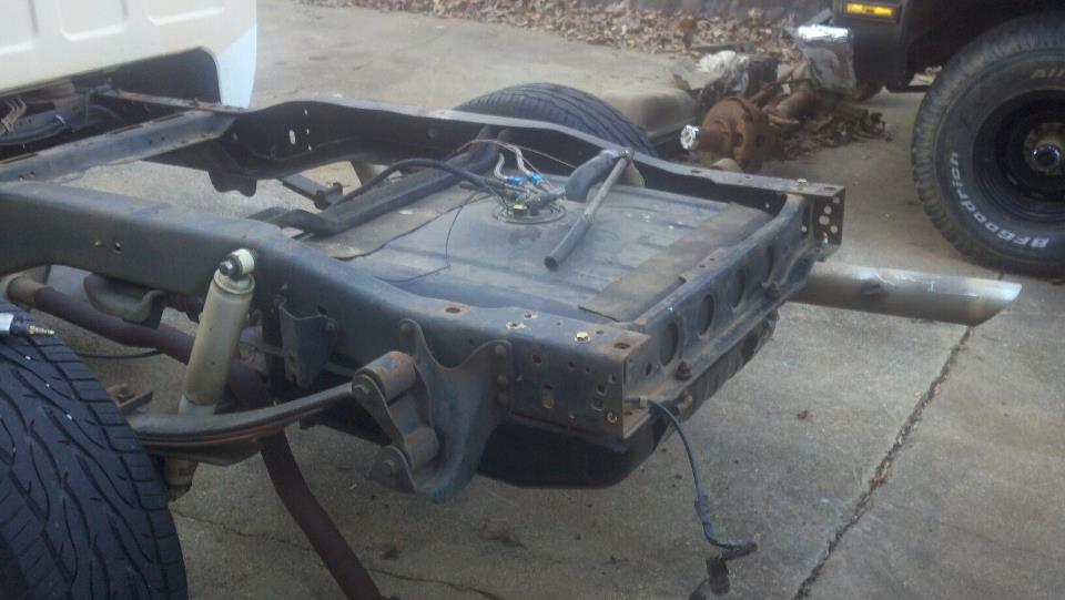

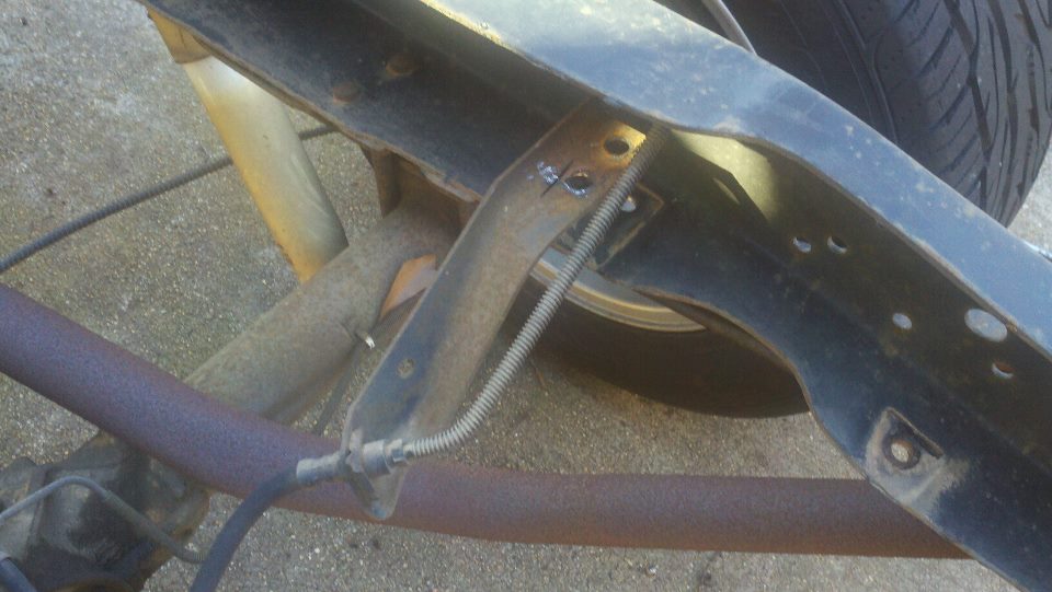

Saturday, February 11th, 2012:

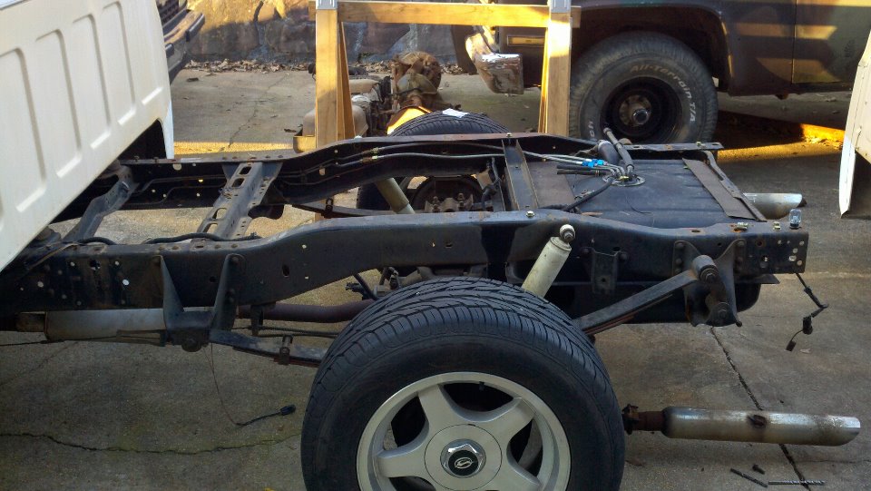

Removed the brake line bracket to make room for the Blazer tank
Got the Blazer tank and brackets mocked up, just got to center it all and drill some holes.
Drilled 2 holes in the rear brace for the tank straps, still need to drill holes for the front strap and upper bracket, but it was freezing and it's holding itself up...

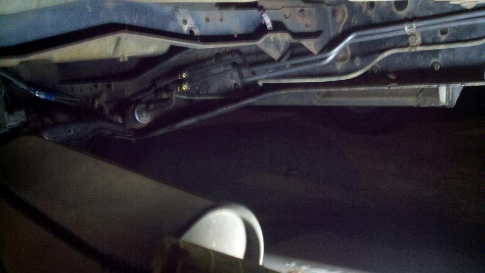

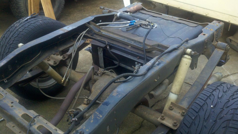

Sunday, February 19th, 2012:

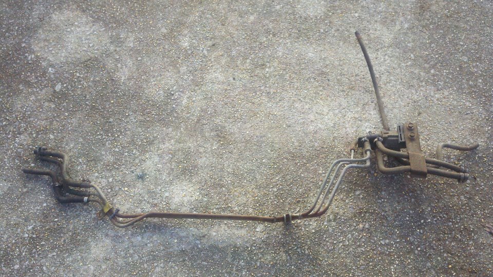

Finally stopped raining and I got the dual tank lines and valve removed. Tools: 1/2", flat screwdriver and pliers.
Fuel pump leads are going to be long enough to use as-is, just need to remove the switching wiring

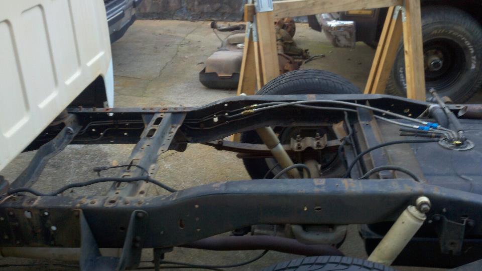

Probably hard to see, but the new feed and return lines are mocked in.  Need to flare the end and make a connection to the filter and return line.

Sunday, February 26th, 2012:
Can't see, but bent up and connected the supply line to the tank yesterday didn't have time to do the return. Tools: 45 degree flare and 5/8" line wrench.

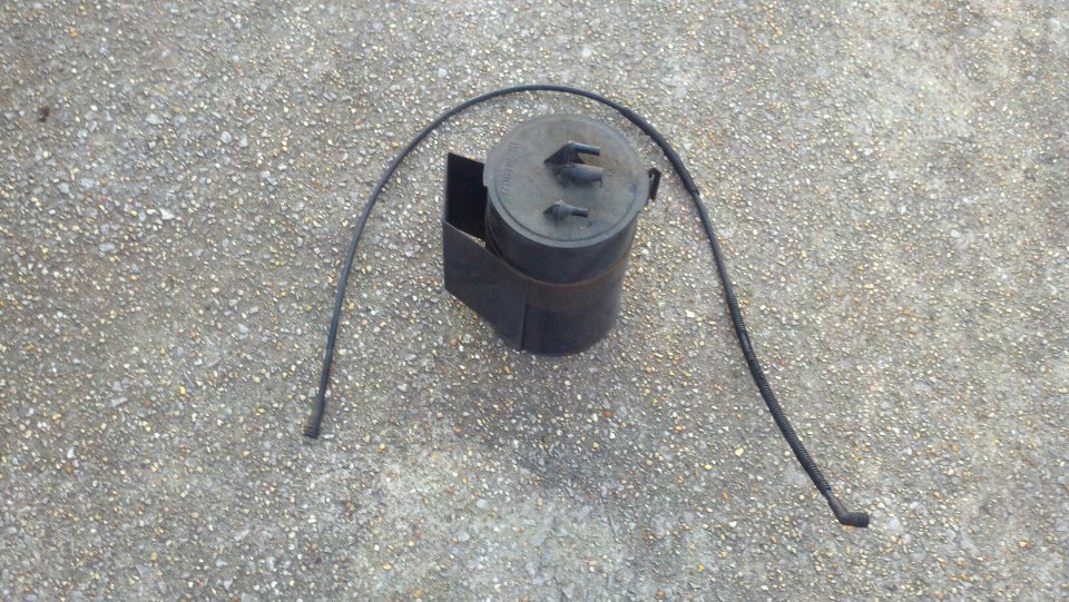

Removed the charcoal cannister working on removing the tank line. Tools: 10mm, 1/2" wrenches, pliers
Fuel lines from the Blazer tank to the intake is done. Still need to tweak some bends and add a few frame clamps, but 99% complete

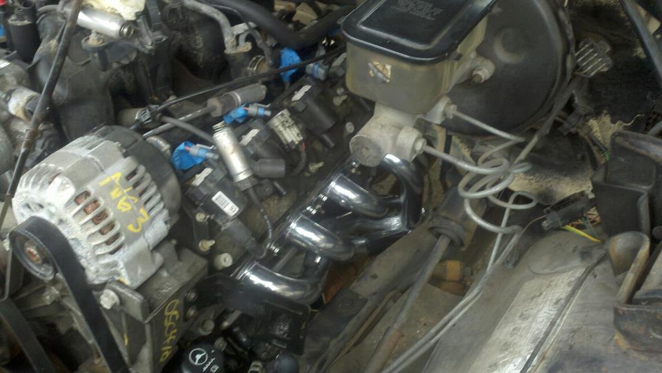

Saturday, March 3rd, 2012:

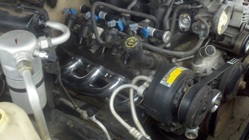

The correct S&P headers showed up Wednesday, got them installed today. Tools: 10mm
« Last Edit: March 20, 2012, 05:12:36 pm by Captkaos »

Blazer tank is mounted and lines are done. Tools: 9/16" wrench/socket, 1/2" drill bit.

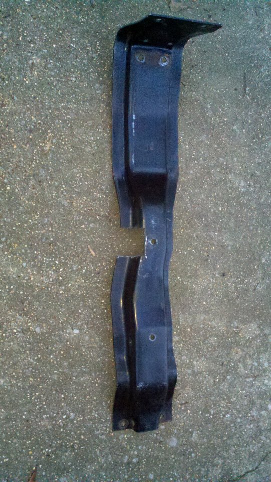

Sunday, March 18th, 2012:

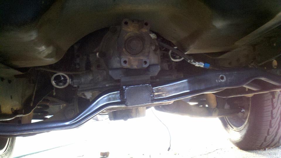

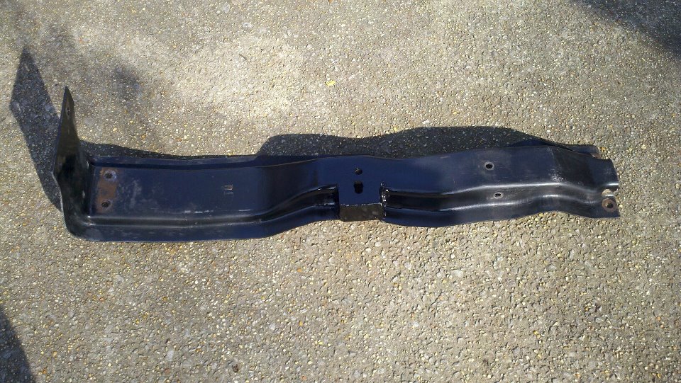

Hacked up the crossmember to make a hole for the extra length on the 4L80E.
With help from a friend, got the new mount fabbed and the hole located. Painted it and it is ready to go in.
Transmission is bolted in. Tools: 5/8 and 11/16 wrench, 15mm, 11/16 sockets.

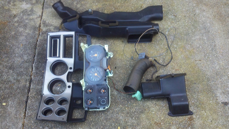

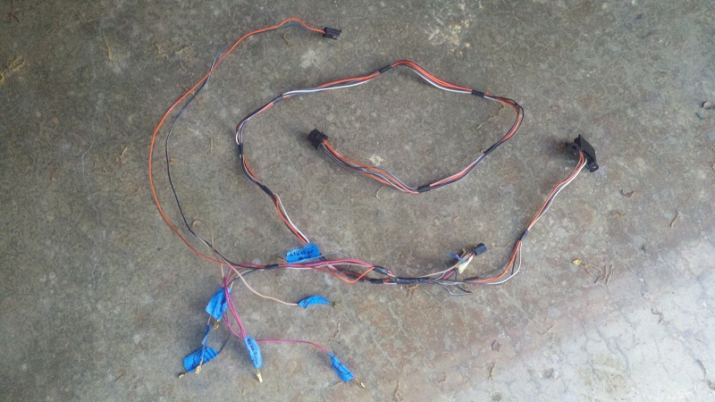

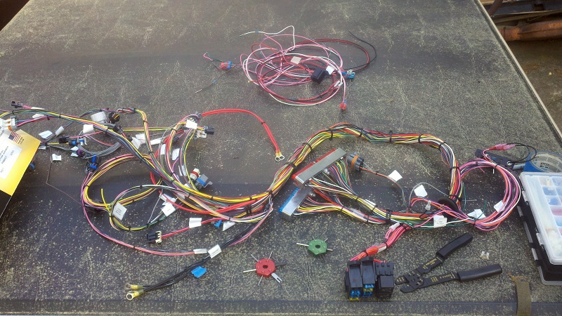

Sunday, March 25th, 2012:Made my painless wiring kit a little smaller and less painless by removing the AIR wiring. Tools: Lysle 56500 and a small flat screwdriver.
Started gutting the interior for wiring in the harness and Dakota VHX. Removed the dash (phillips, 9/32") the bezel (phillips), the cluster (9/32) the AC ducts (9/32, 5/16) and the dual tank wiring.
