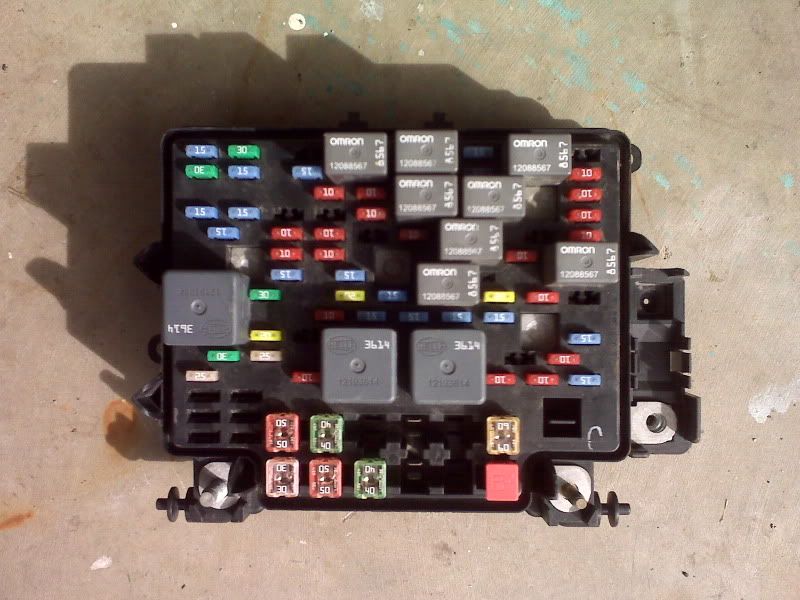

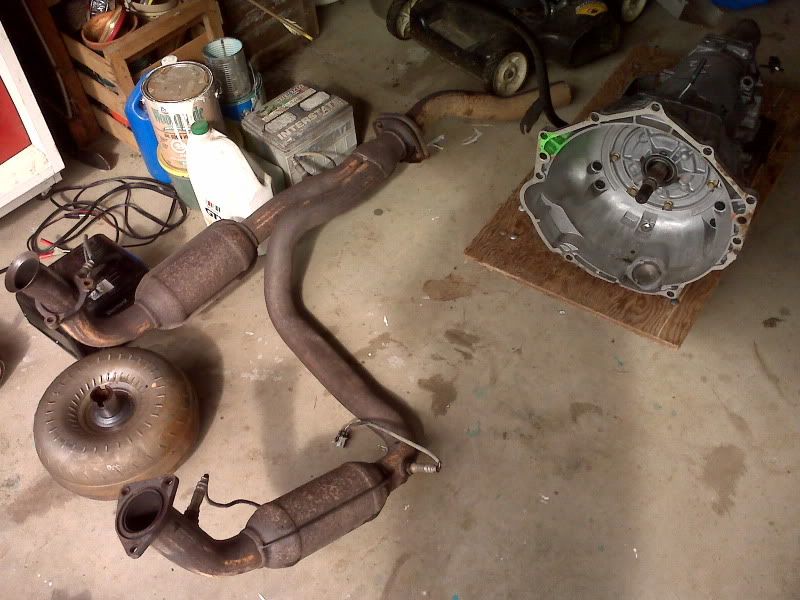

Went to the wrecker this morning and got myself a 4l60e, y-pipe, and fuse box for $925 Canadian.  I'll post pics later when I get home from work.

Here's the pics as promised.  Anyone have a guide or map or whatever as to what each fuse is?  The fuse box is also from an 03.
Re: 5.3/4l60e swap into my 1981 C10 Stepside
« Reply #21 on: September 18, 2010, 11:41:53 am »
I don't have one for that year, but you can get a tech at the dealership to print the schematics out.  I got a Painless harness for mine.

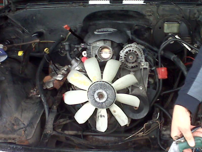

Anyway here's a pic of the engine in.  Didn't take too many cause I don't have a camera, just a BlackBerry.
Offline heavychevy91
  • Posts: 322
  • '86 Chevy K20
« Reply #24 on: September 20, 2010, 11:19:01 am »
not a problem. Looks like you making some pretty good progress
