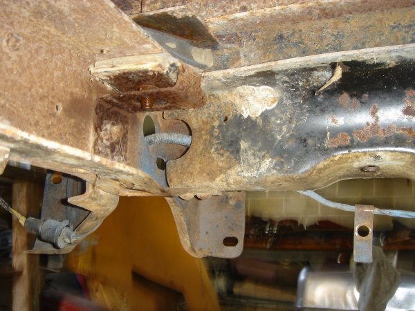

I'm finally finding a little time to work on the Blazer. (I'll post a few pictures later.) I pulled the old, rusted-out, broken-in-half tailpan, and discovered that the the frame rails are rusted through at the rear body mounts. (Generally, the frame is in excellent shape, but water must have gotten trapped between the mounts and the top of the frame rails.) I can fabricate a new section from plate and weld it in, but I need to find some steel that's the right thickness.
The frame rails seem to be 0.150" thick, which puts them half way between 1/8" and 3/16". Does anyone know if I can buy steel in that thickness, or is the only option to find a junk frame and cut out a patch piece? I could just use 3/16, it would just be a little thicker than the rest of the frame.
Thanks.
- Charlie
cbgrant74
Posts: 15
Re: '77 Blazer Project
Reply #31 on:
July 13, 2011, 11:41:24 am »
Here are the photos.
The old tailpan:
Out she comes:
This is a problem:
Cut out for patch:
