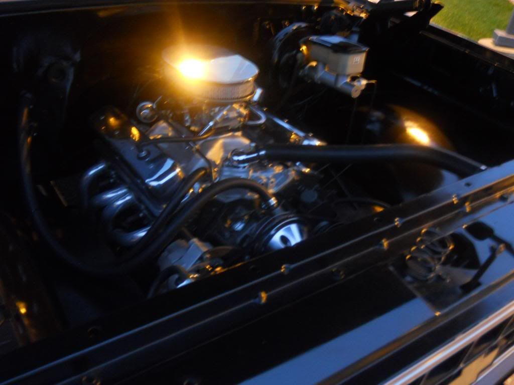

So is this your new motor?.
It looks great.
What are the specs on it?.

« Reply #28 on: May 15, 2011, 04:33:24 pm »
It looks great.
The six is out, Thanks,
It is in my project thread here
http://forum.73-87chevytrucks.com/smforum/index.php?topic=12330.0

Oh that truck is turning out NIIIIIIIIICE!!!!!
