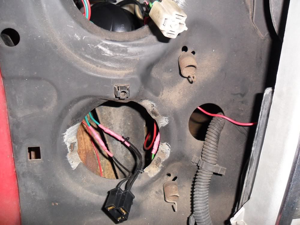

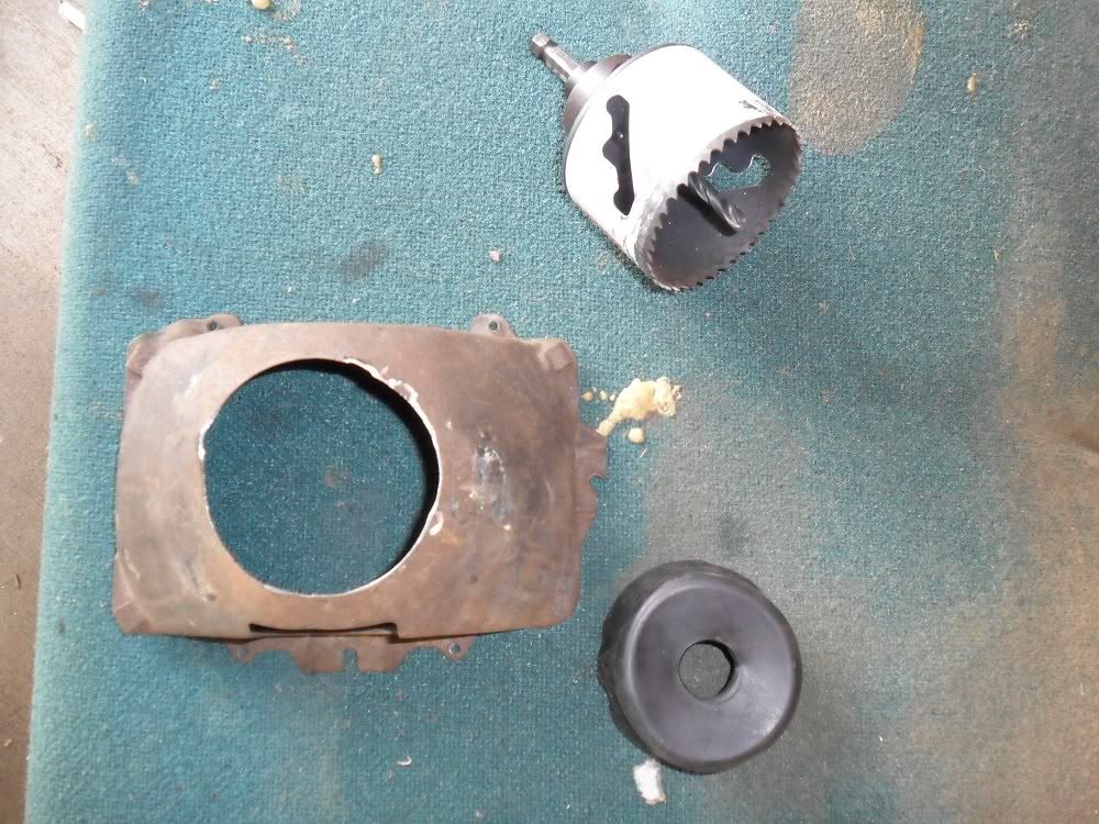

Couple more pics. Ended up having to use a hole saw on the factory headlight buckets to get the new headlights to fit in there. No big deal there. Just used some ebay H4 connectors for the lower 2 lights. The stock upper two lights already fit H4 bulbs so no need to buy anything there.

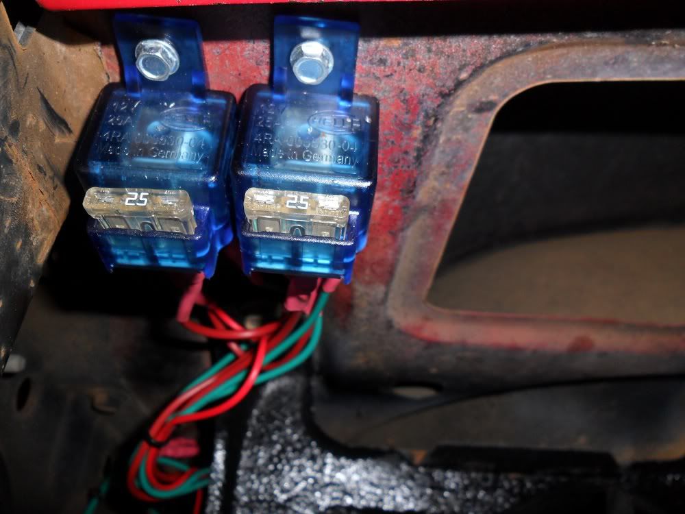

Only thing is, the bottom two lights still just barely glow when you click over to the dims. Which is the top two lights. I got it wired up correctly so that when you turn on the dims, the correct filament in the H4 bulbs light up. Then when you turn on the brights, the correct filament in all 4 headlights light up. But for some reason, the bottom two are still getting power and just barely glow orange.
But this is nothing new. The factory headlight setup did the same thing.

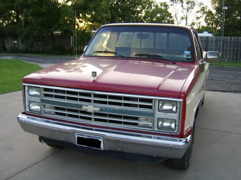

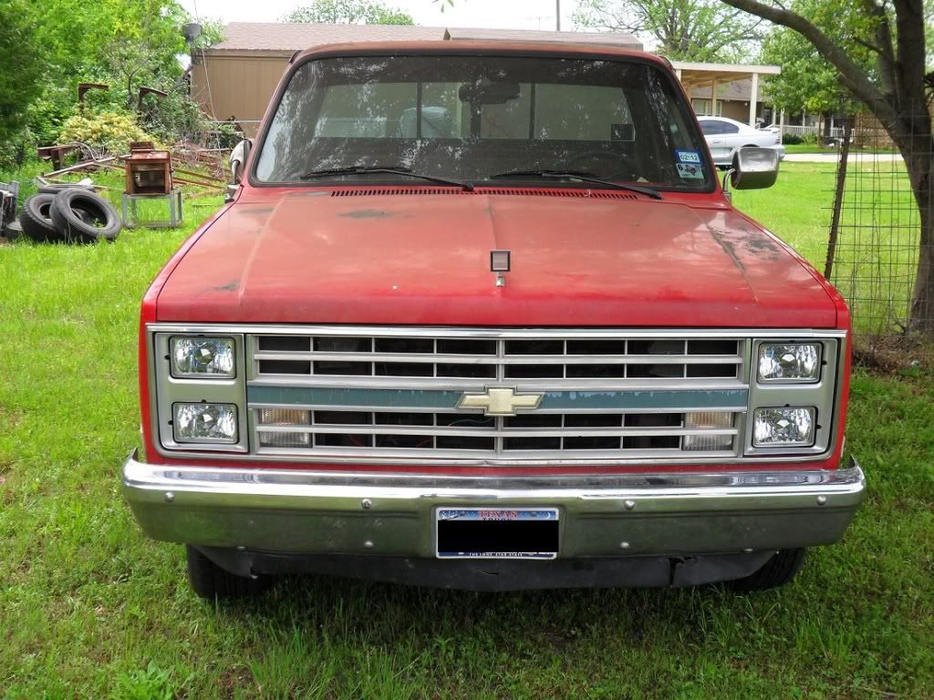

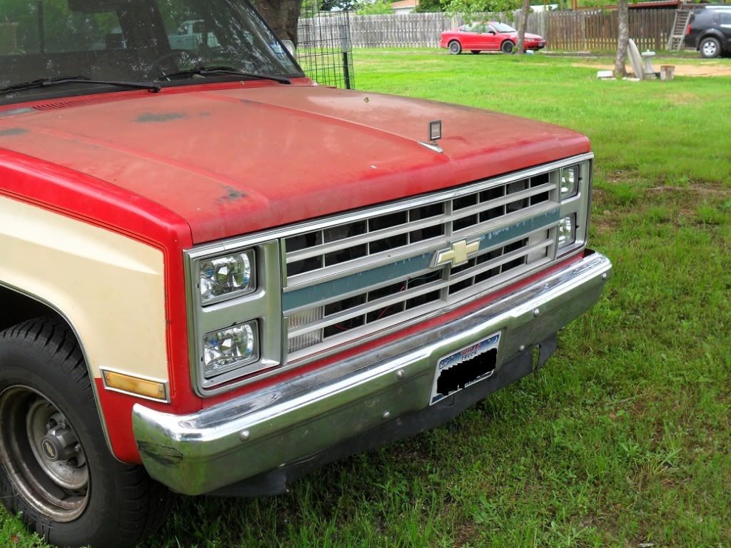

Here's a few before and after pics. Look pretty good imo and are a LOT brighter than those dangerous old style ones I was running. Even so, I'll still probly do the projector/HID project eventually. But not for a few years.

Next stop.. new grill and lower spoiler. Look how tore up it is.
Already got the new headlight bezels though. If you look at the passenger side in the first pic, you can see the old ones were broke. Ordered some off ebay and sanded 'em and rattle canned 'em.
