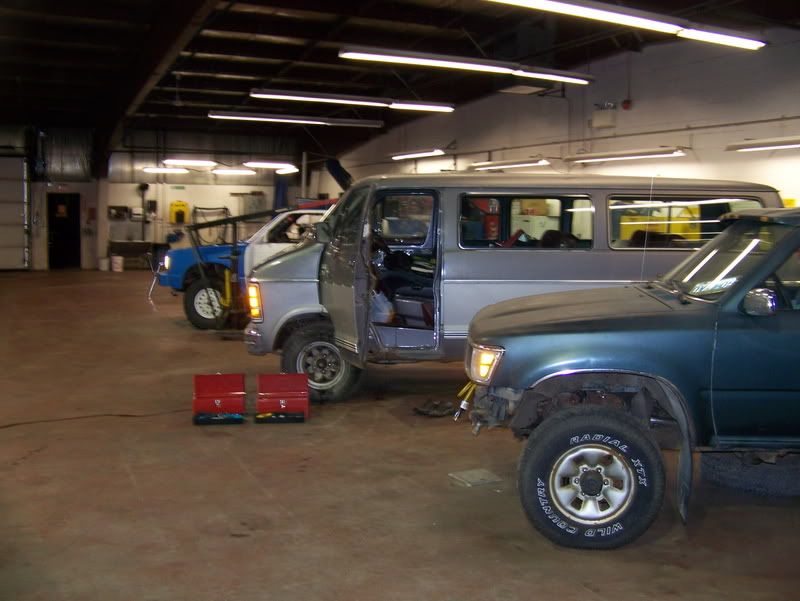

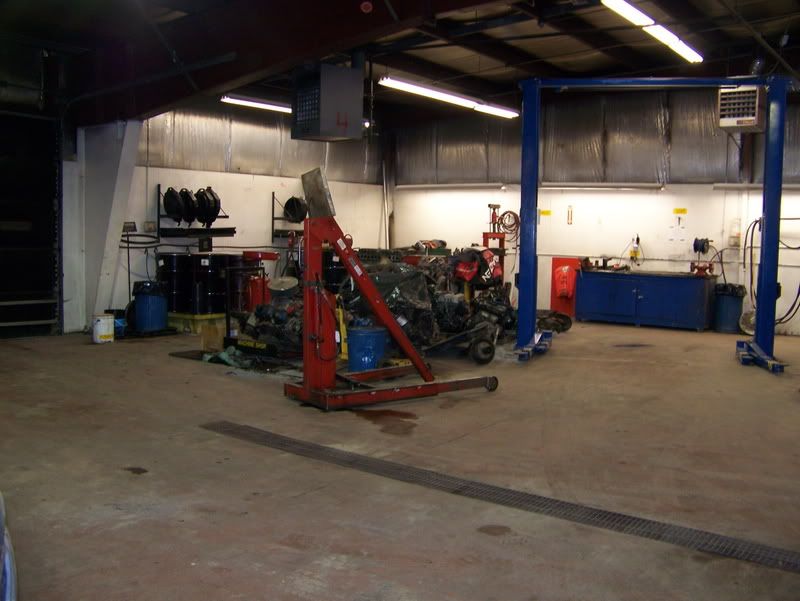

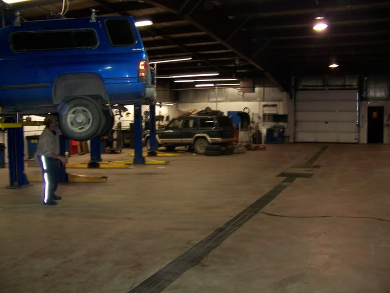

Thought I'd post some pics of my work space, I work at the base auto hobby club so my personal hours there are free. 5 hoists, 3 floor bays, tire changing machines, plasma cutter, welders, everything you could ask for except a paint booth... I'll cross that bridge when the time comes...
The grey van was a donor for my old dodge shorty van V8 conversion.
