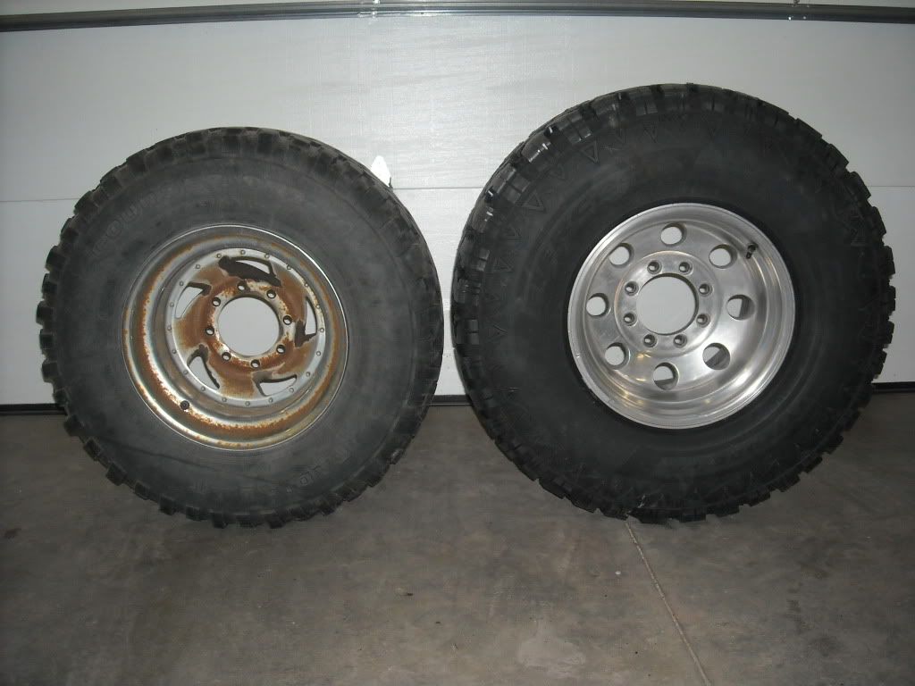

I did find some used aluminum wheels last Sunday so last week I went to my local favorite tire store and got 4 new tires on the way. I ended up buying 315 (35") 75 16 Dunlop Fierce Aggression tires. $1100 later I brought them home. Wow, tires cost a lot !!!
I've attached a few pictures of my old tires and rims along with the new ones, below. The new tires are 3" taller than my last tires (which were worn out) so I was thinking I'd have to do a little fender trimming. I was right.

Here's a few pics of my old and new tires comparison. I like em'  !!!    ;D

     Those are some nice looking rims and tires.  Yes tires are expensive.  I do have to say the older trucks, (second generation) do have better fenders, I like the round fender on those trucks, I just don't like the way the rest of the truck looks.   8)

Nice looking tires and wheels!

Im loving the wheels and tires. Cant wait to see them on the truck

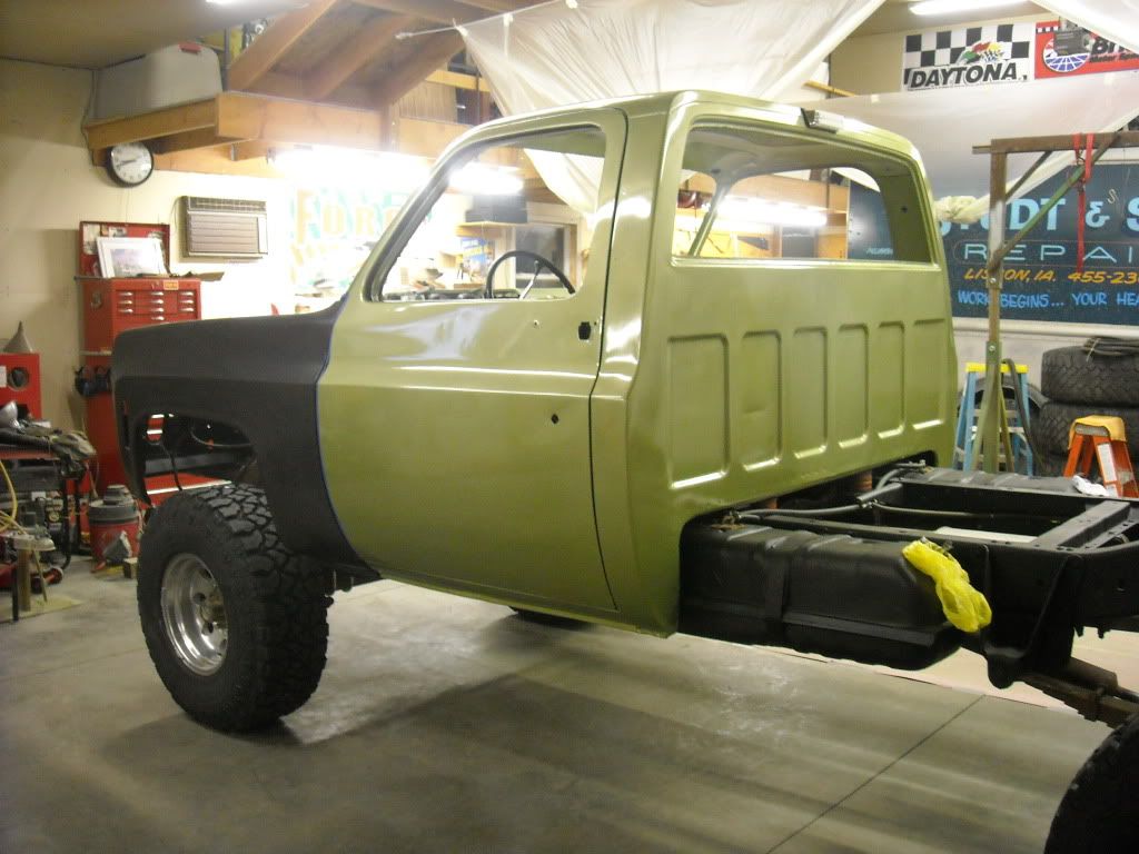

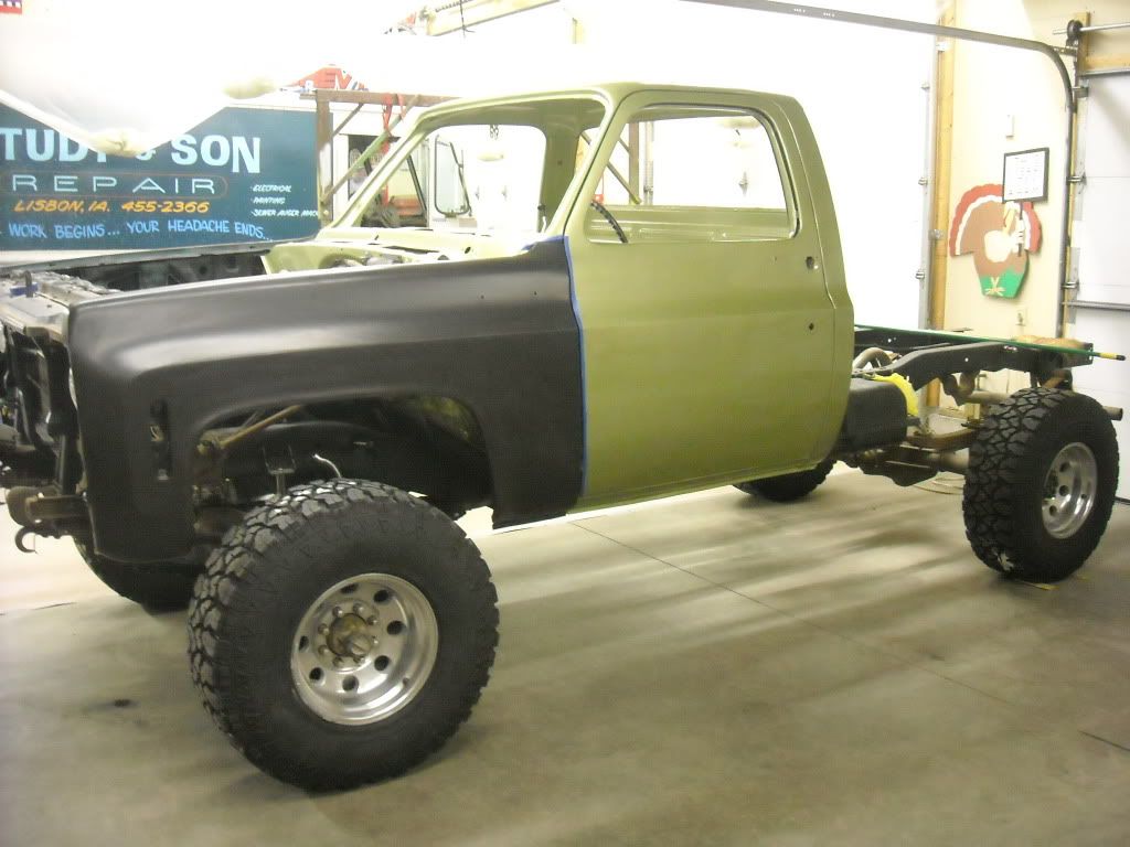

Last night I put the drivers door back on. This was easy because I'd already aligned the doors to the cab before painting either one. All I had to do is just tap in the hinge pins (now remember I have the top pin in upside down with a retainer in the top so it can't fall out).
Then I nervously attempted fitting the fender (aftermarket fender) to the door. I put a double thick layer of painters tape on the front door edge so I wouldn't chip anything.
Since I didn't have a helping hand, I loosely held the front of the fender up with a strap and overhead support. I shimmed and gapped the top of the fender to the door and then had to lower the front of the fender to close the gap on the bottom of the fender to the door. The gap was awesome.... until I had to try and flex the front of the fender enough to raise it the 1" it was sagging in the front.
I now know (with the help of the guys here) that I can shim up the front of the cab to help with this issue. I'll be readjusting that fender so it isn't so torqued.
Anyway, I was happy to have them both on the truck together.
I'll be working on the passenger side this evening. I hope it goes well. This side has original GM door and fender.
Here is how it looks currently.

It's starting to take shape now! Everything looks awesome so far. I like the way it sits and those wheels and tires are perfect for it.
Are you going to put the hood on also to check the gaps with that too?

I will at least set the hood in place to make sure the front end is square, parallel and level.
Before I took the fenders off last time I took some specific measurements that I have been rechecking now to make sure everything was very close to where it was before.
I'm getting pretty excited because shortly I'll be painting the fenders and putting this stuff together for the last time.
