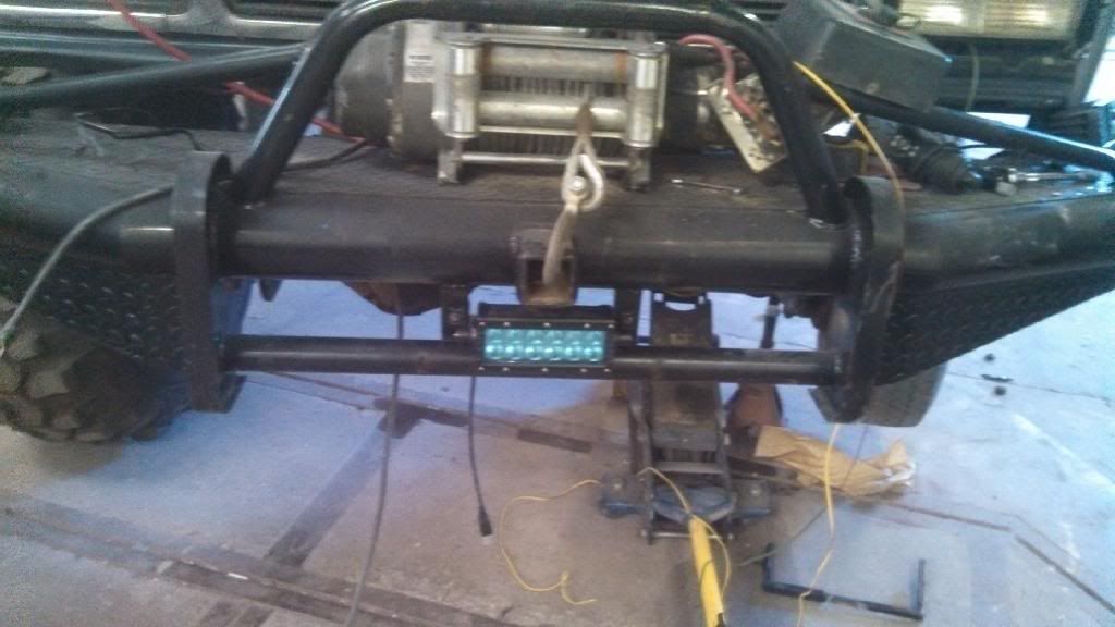

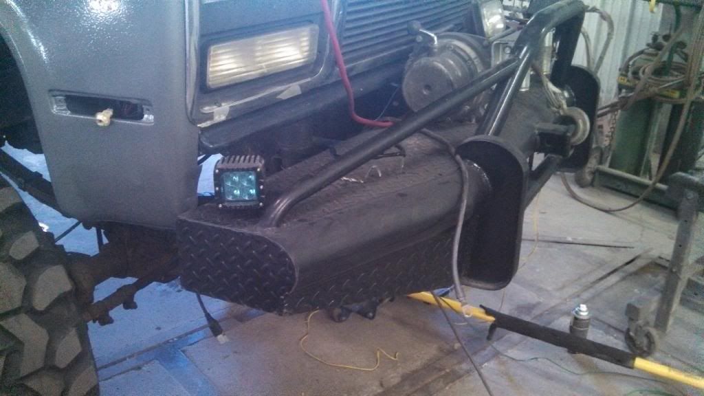

got the lights on the bumper mounted today.. thats about all though. we got slammed at work :)
lol... my friend didnt believe that you could drive on these lights.... soooo... i showed him :D got a little heavy on the gas when pulling up on the light and shot it across the parking lot haha... just some slight concrete rash the second time around i pulled up on it no problems at all took it into the shop hooked it up and bam! good as new.
