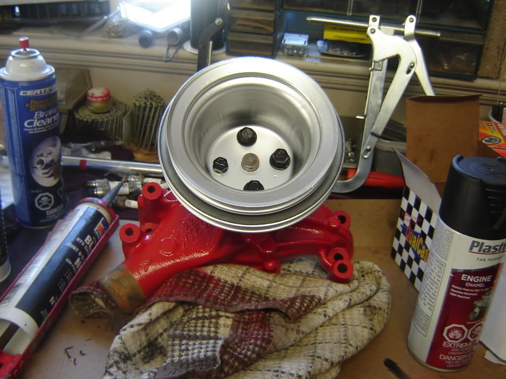

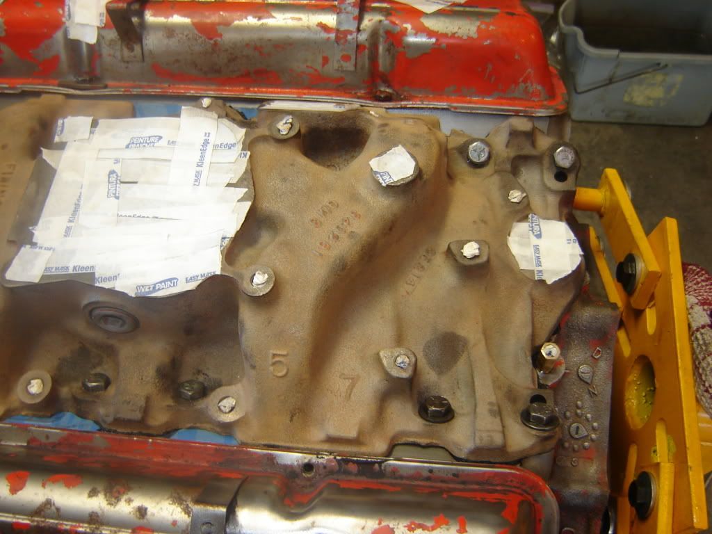

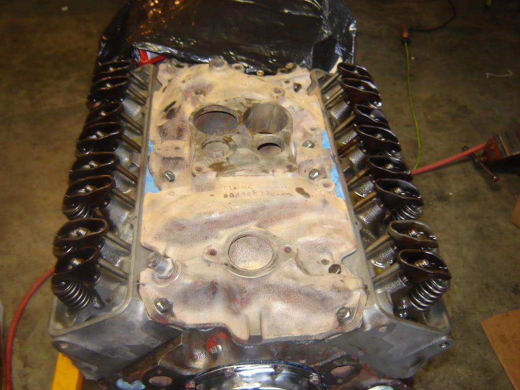

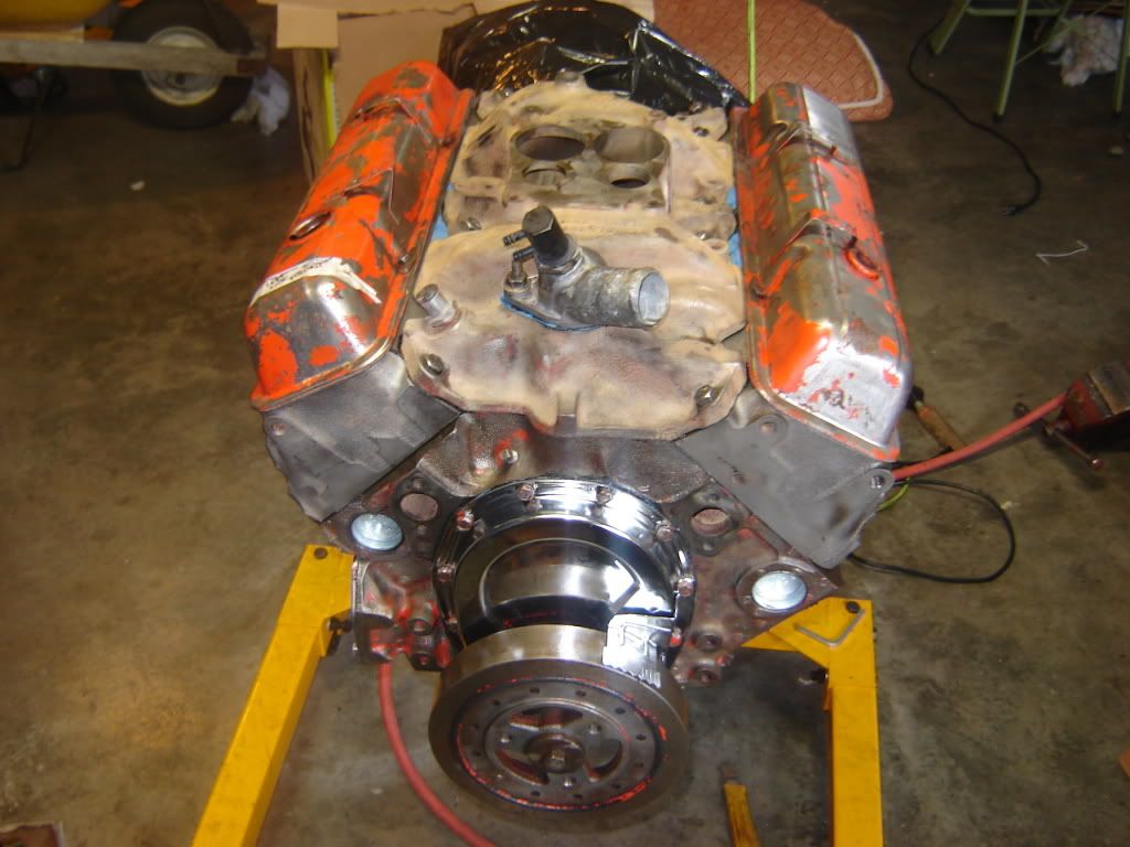

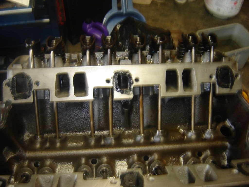

i didnt get anys pics of it but when i was putting the intake on i first tried the little rubber seals for the ends but once i tightened the bolt down they were actually pushing out and i could tell there was going to be some serious seal issues. so i ended up getting permatex rtv and layed a bead of it all the way along instead and it looks much more promising.
when i was putting the intake gaskets on i first put some sealer around all the coolant holes on the heads and on the other side of the gasket aswell
here is the intake on

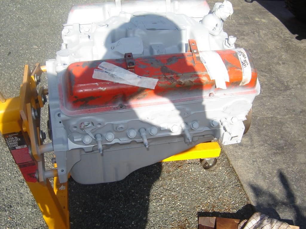

put the old valve covers on for painting purposes
masked off all the holes on the intake, for the little bolt holes i just balled up some tape and stuck it in there

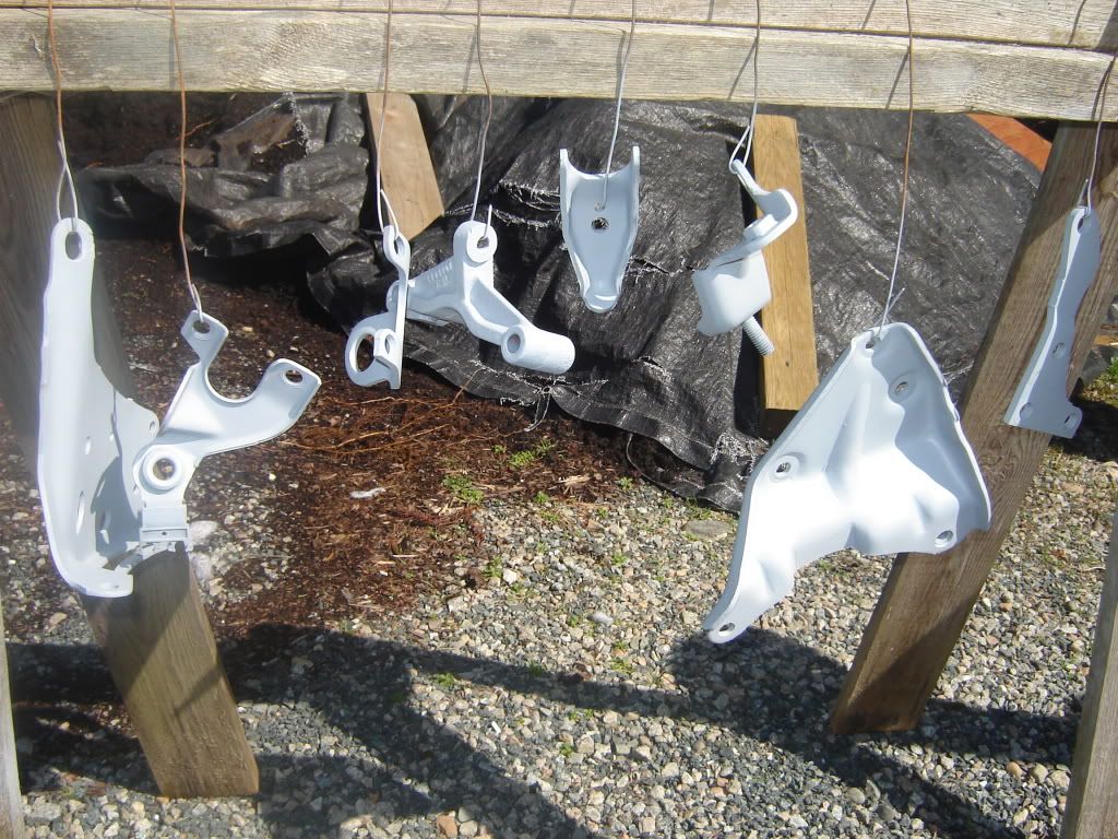

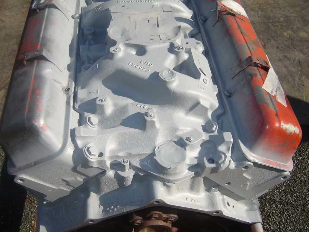

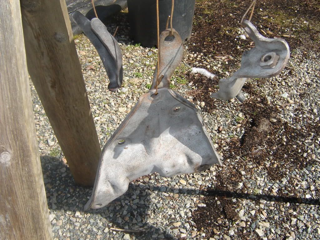

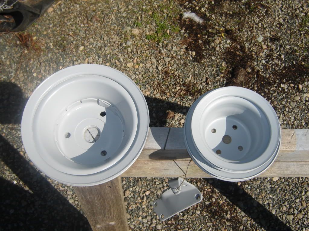

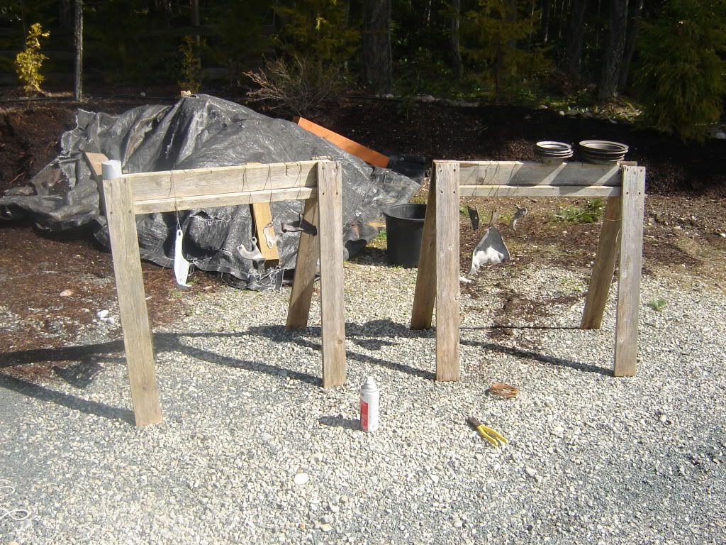

sand blasted all the pulleys and brakets
primered up

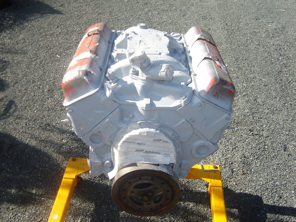

also primed the engine

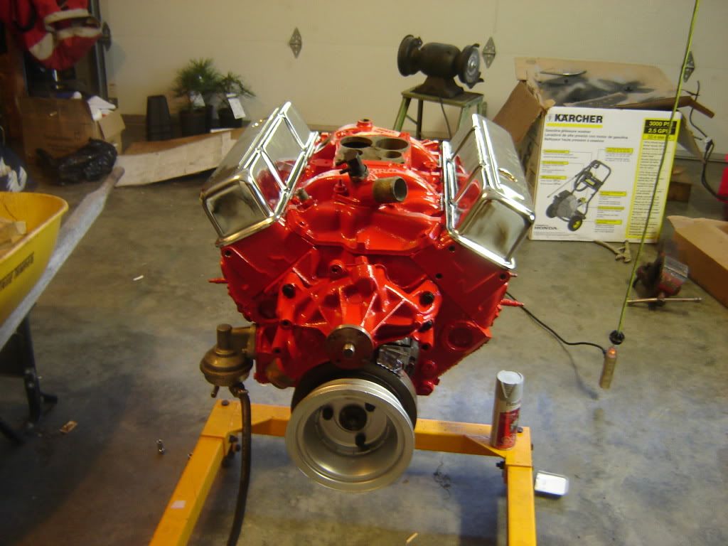

it was a last minute decision but im going with red and i painted all the pulleys and brakets aluminum, and im painting the bolts flat black so hopefully it doesnt look like a dogs breakfast when im done

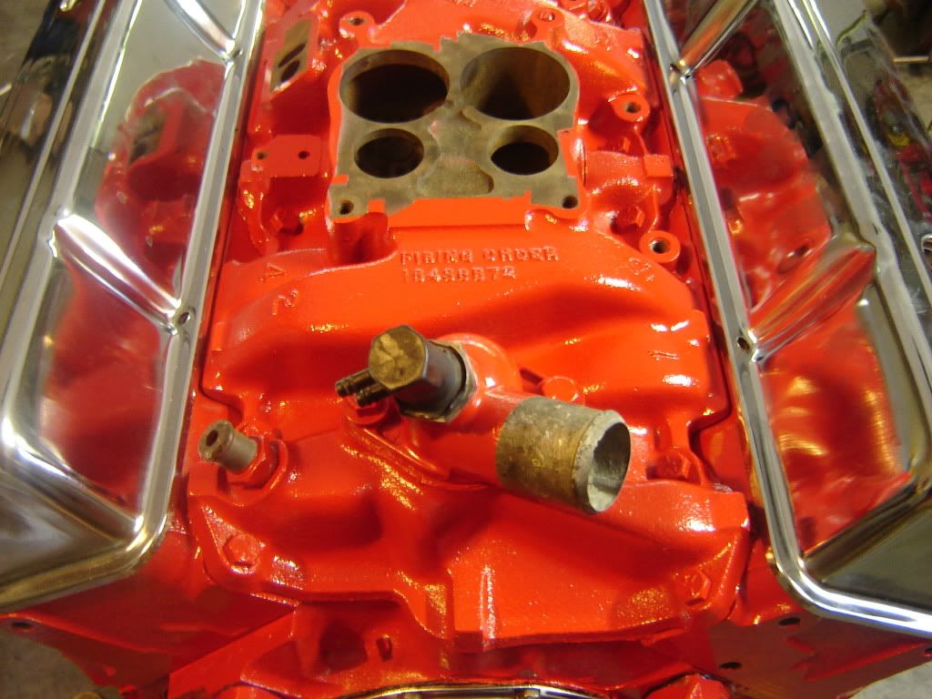

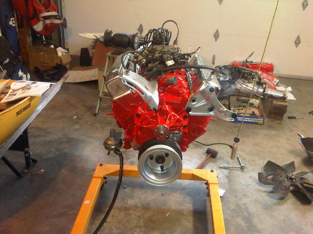

been a while since i've updated, mostly because its been going slower. got the engine painted and hopefull will be able to drop it in the truck this week

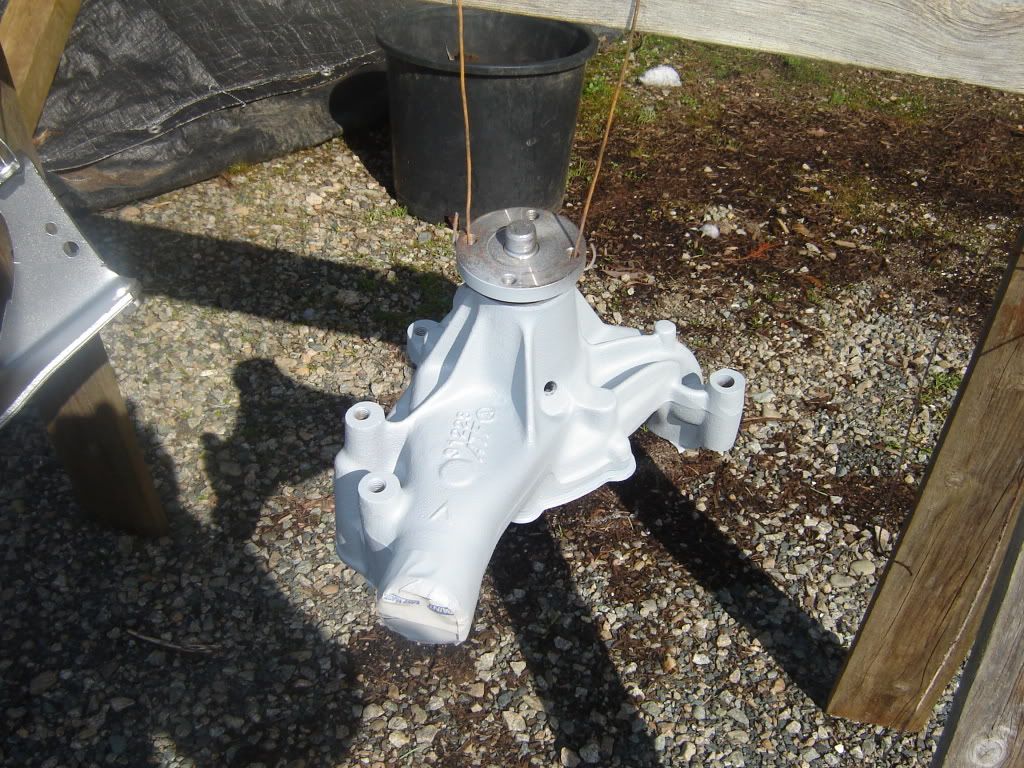

water pump, i like the contrast of the aluminum and red paint, the paint looks more orane then red in the pics but it is red
close up of the intake
and here's what it looks like now

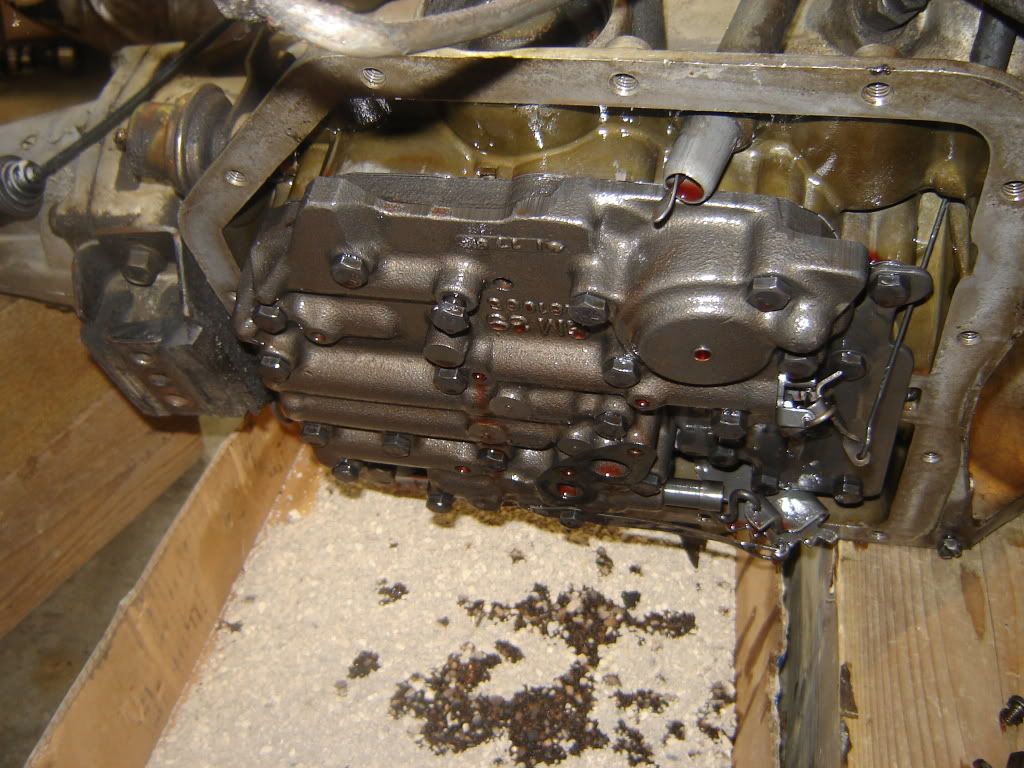

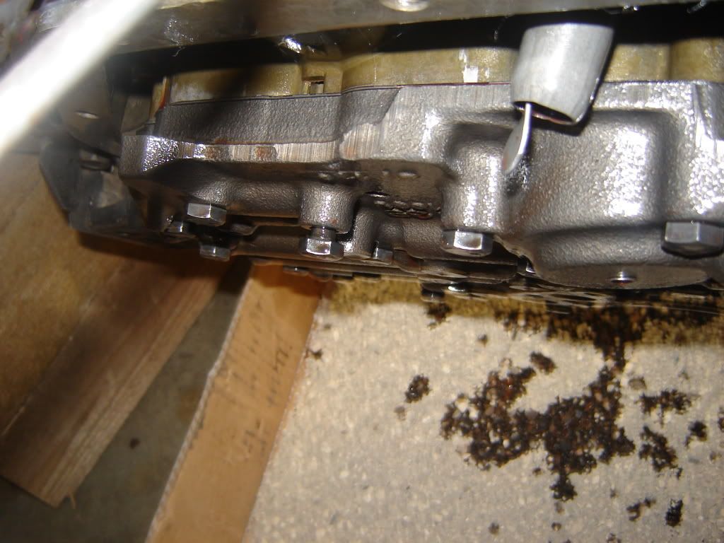

also when i went to change the gasket and filter on my tranny i noticed one of the bolts was super loose, you can see how loose it was in this pic
so i just tightened it back up and threw it back together. i dont have any experience with transmissions so im not sure if this is a regular thing or what?

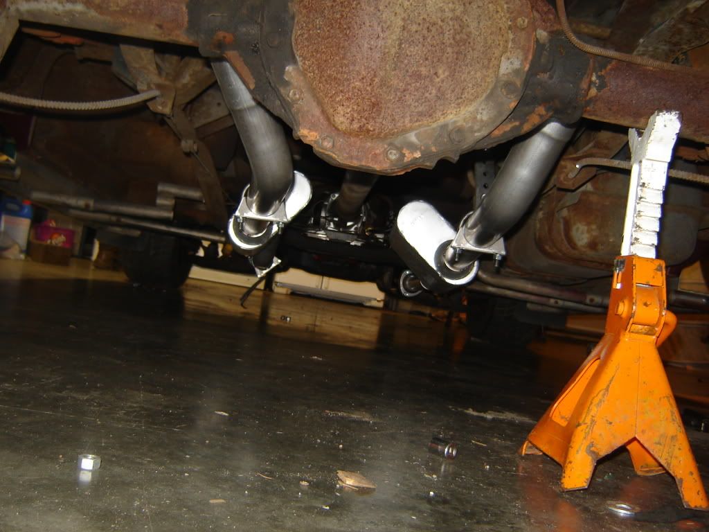

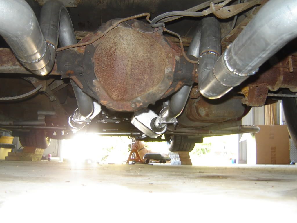

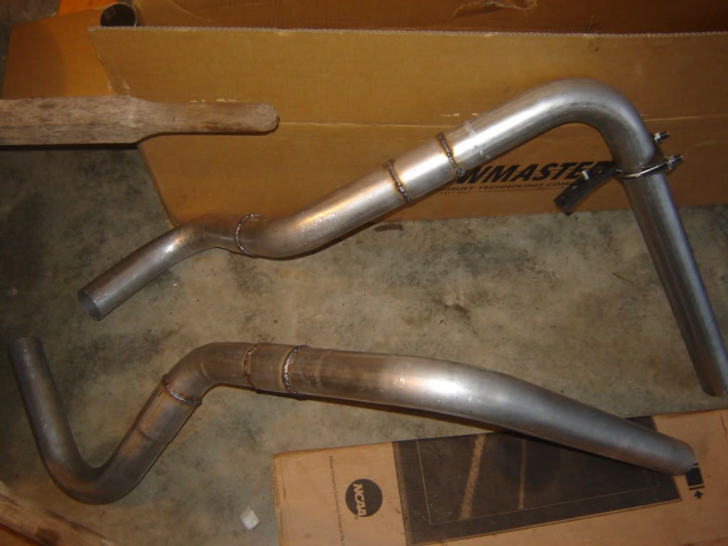

got the exhaust tacked up, dont mind the drivers side i took the pic when i was taking it off so its twisted
and fully welded the over axles portions, im going to only clamp the connection between the end of this portion and the rest of the system so if i need to get it off there wont be any cutting

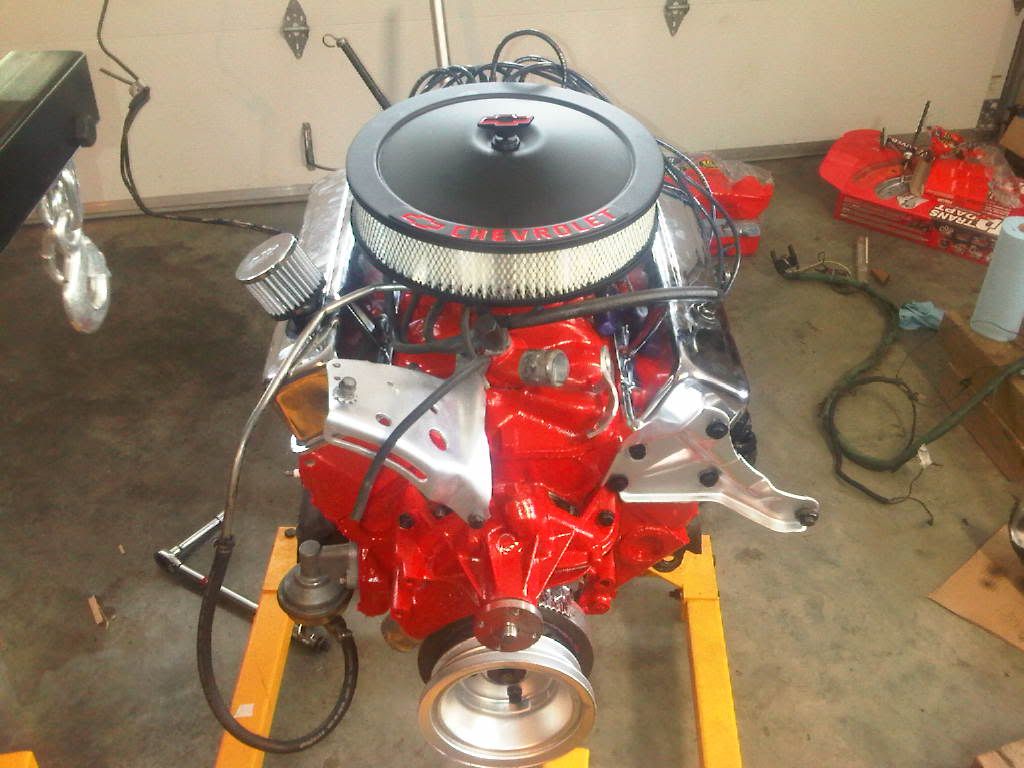

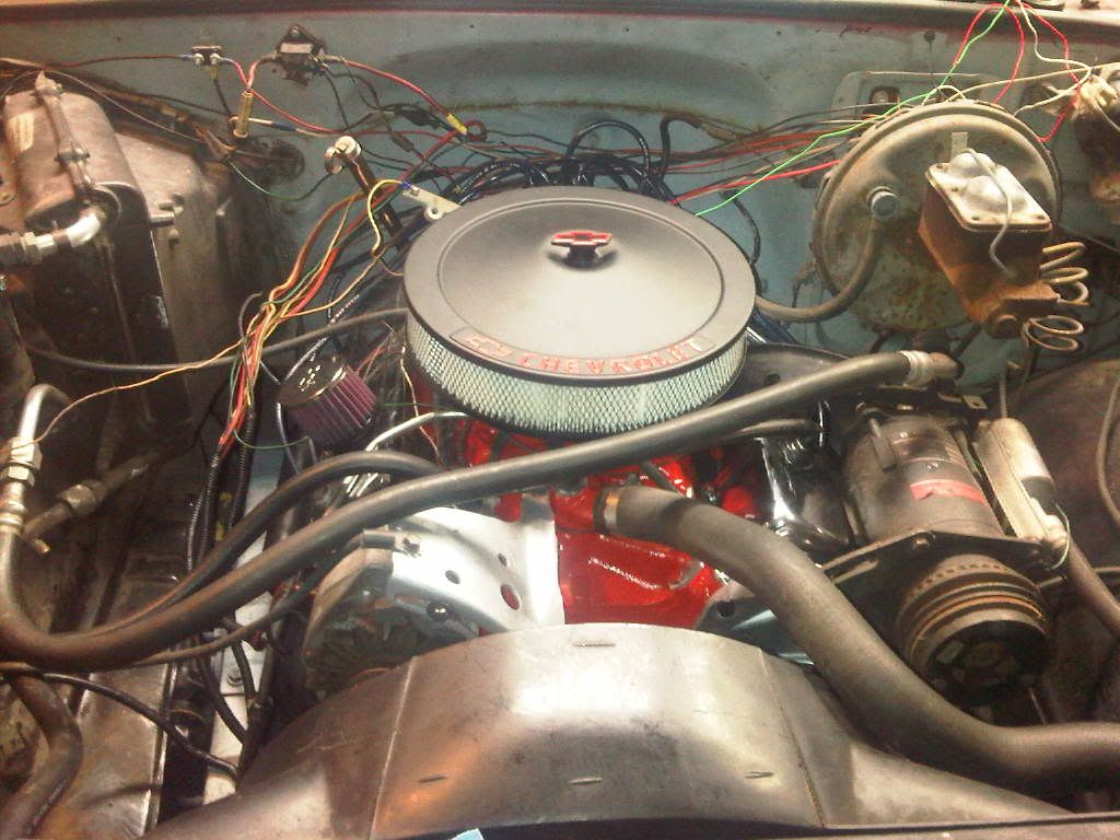

pic of the engine right after i got it in

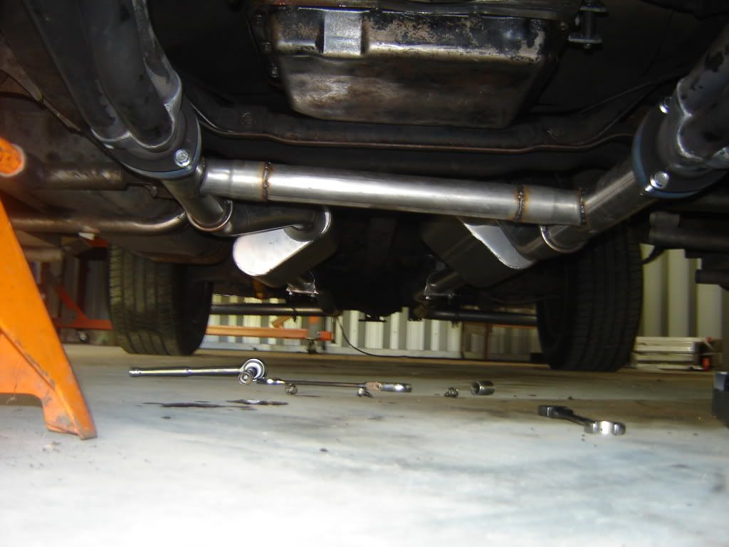

heres a shot of my exhaust after it was fully welded, its not the most symmetrical looking system, but it still took a long time to get it to fit so i was just relieved to have it finished

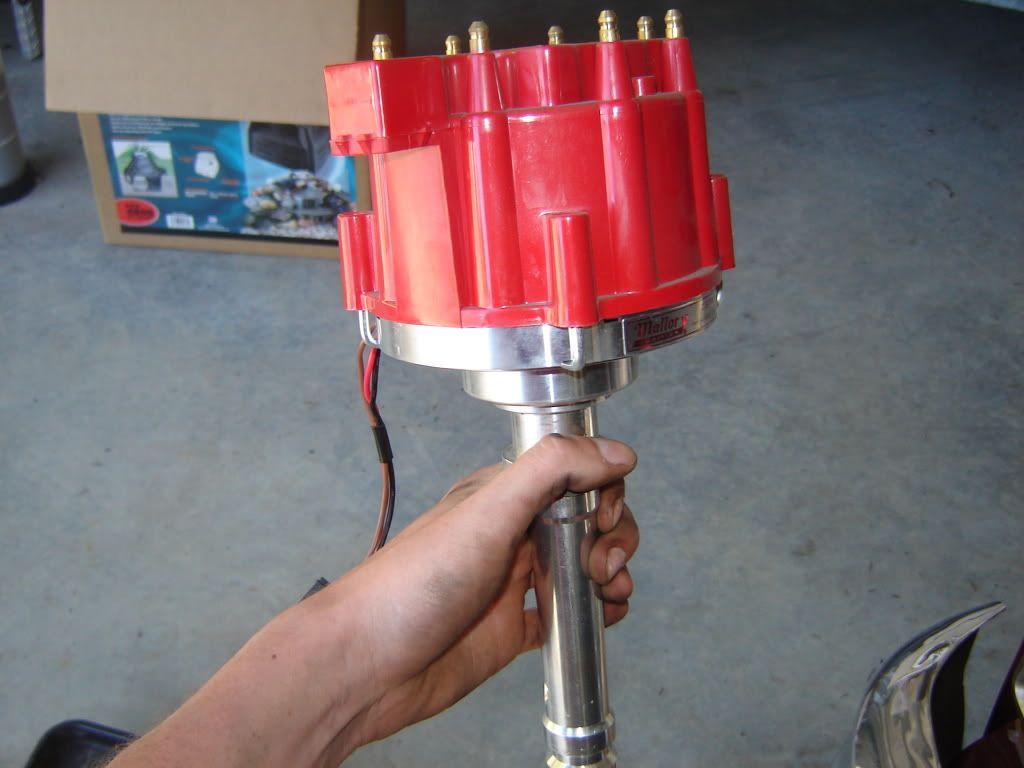

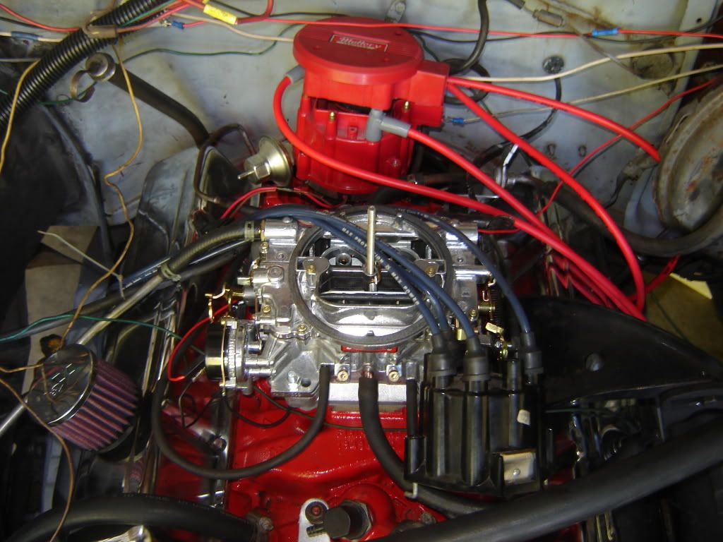

so i couldnt get my truck to perform quite the way i wanted it to, it kept stumbling under load no matter where i set the timing. so i went out and bought a new hei distributor. my theory to buying a new distibutor was that under the rotor of my points dist it was nice and rusty so i was thinking that mayb the curve was not functioning properly, mainly because it only stummbled on higher rpms. idk if that was the reason for my troubles or not but either way it runs like a dream now.

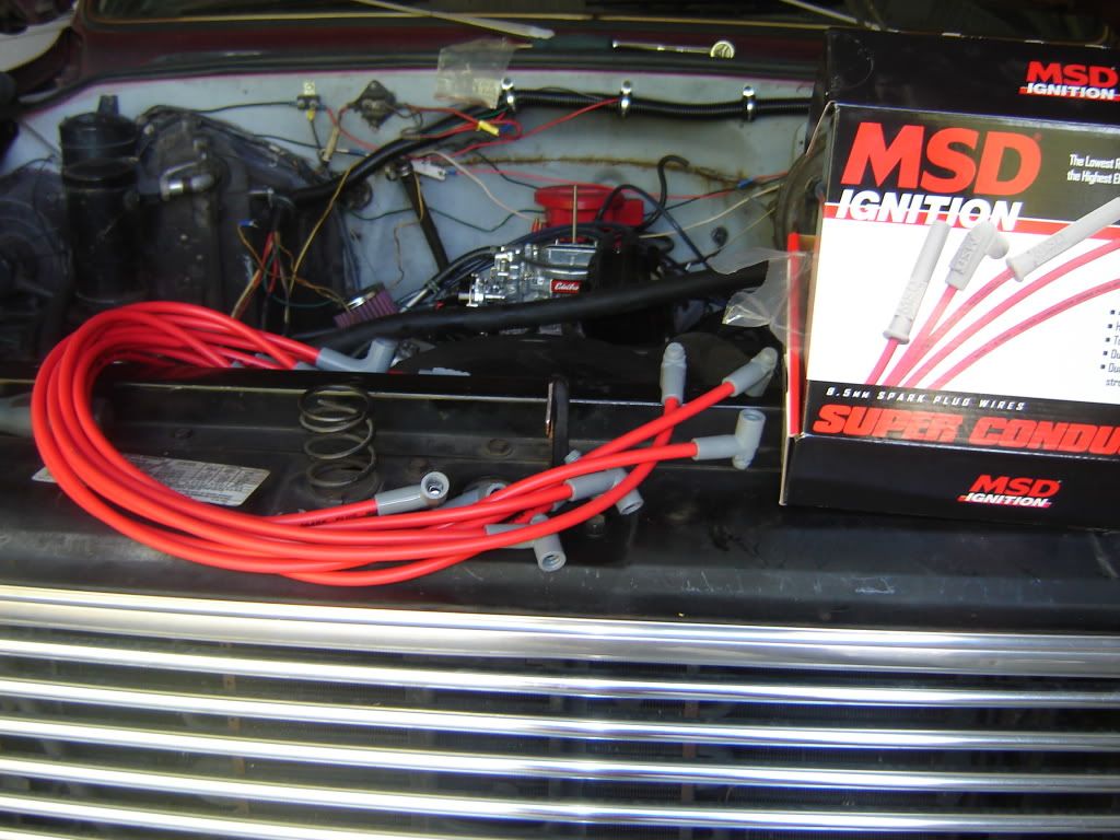

got some new wires that dang near cost me as much as the dist.

With the new Dist. you have a way hotter spark, so it should run better. Glad to hear it is almost ready for paint and then you can cruise around in a newly painted truck.
