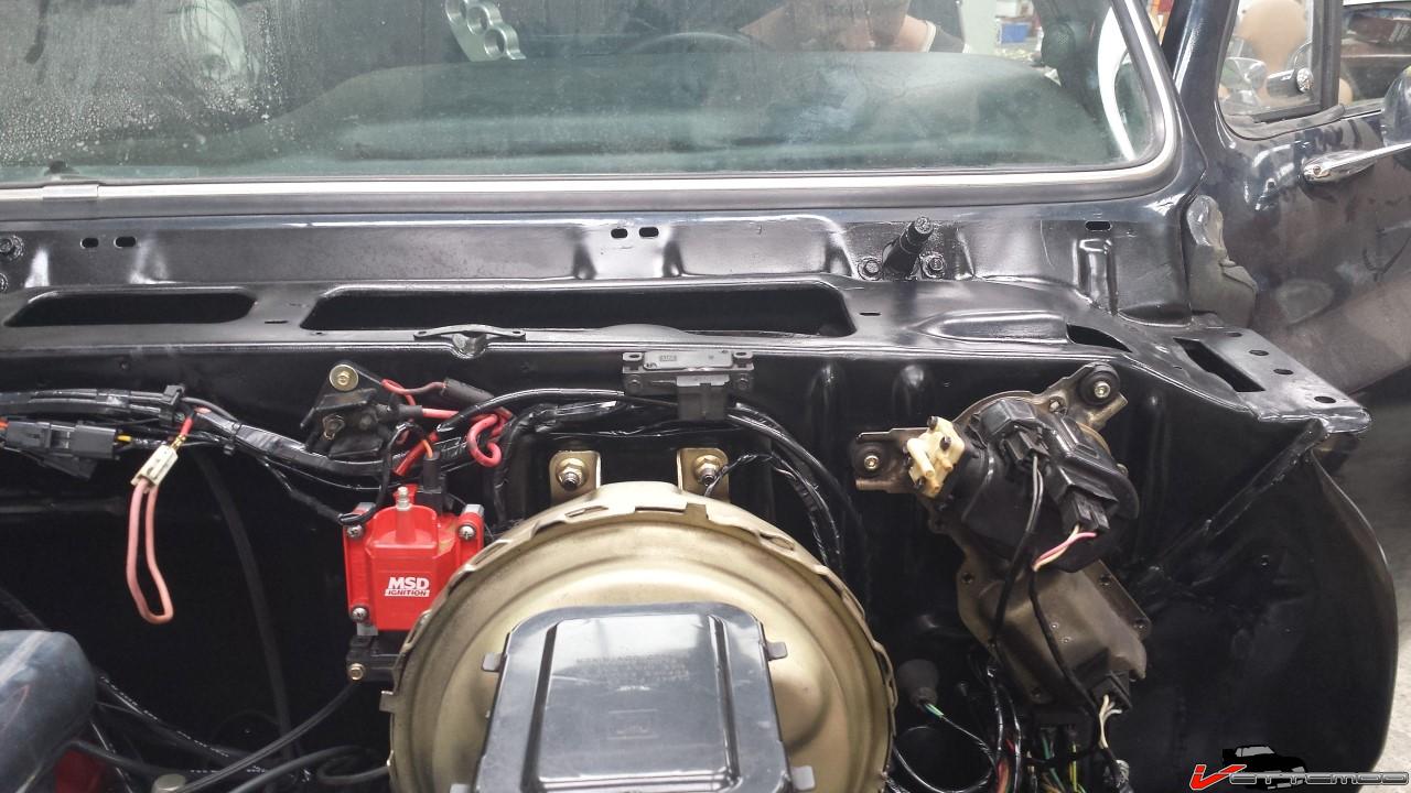

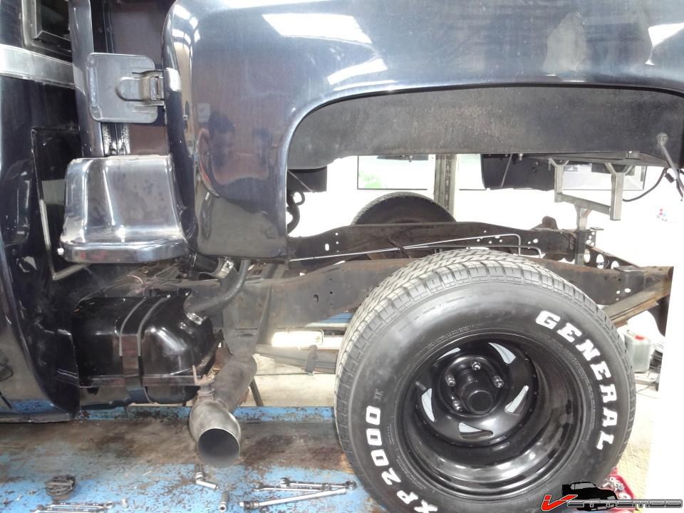

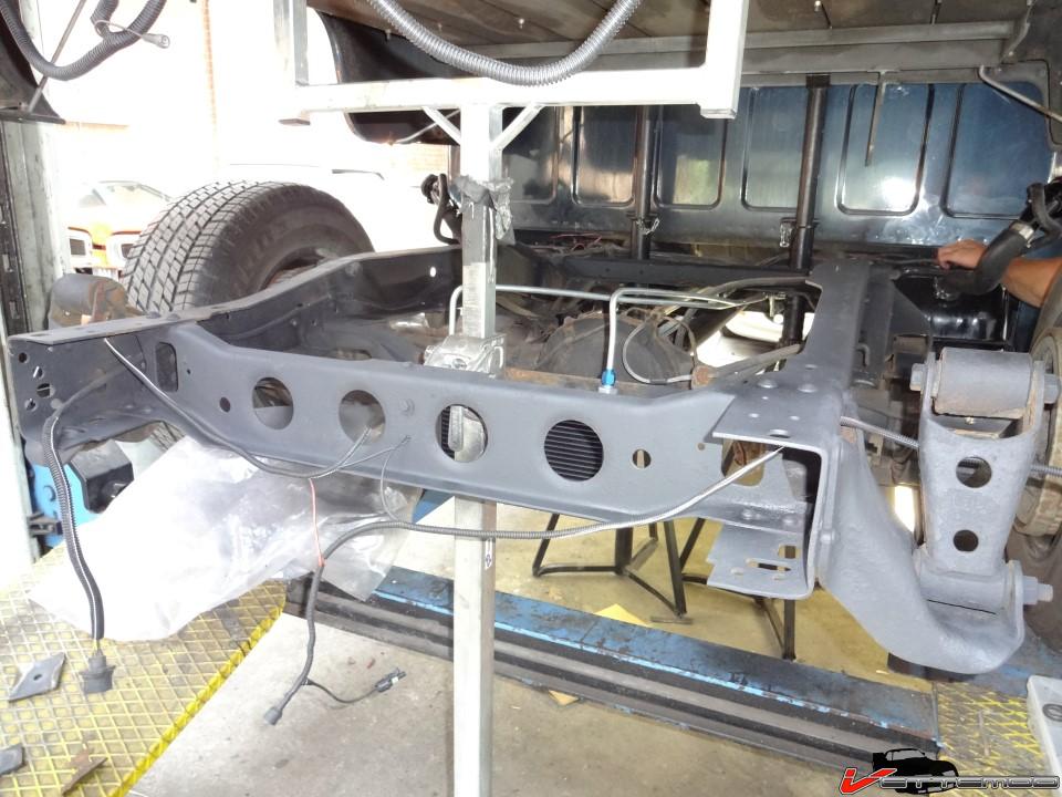

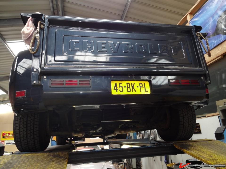

Tanks are in. Boy what a wrestling match getting these in without scratching them uo. These things are made to go on with the cab off. Not a fun job at all. Also when I had 1 in I realized the rear brackets were not the same and sure enough I had them mixed up :(
complete tank with sender retainer ring this time :)
installed... glad I had them done in black and not gunmetal or argent silver like I normally do. These show and that would have messed up the blacked out look
inner fenders back on. Soon I will fire this thing up for the 1st time

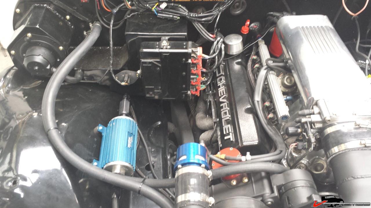

This is the fuel system as I will run it. A 550HP capable mech pump filling a surge tank.  The surge tank feeds the large electric pump for the EFI (it's a paxton branded aeromotive A1000) This way I can retain the stock pickups in the tank and the stock switching valve (which works flawless on mine) without having to source one of those hard to find higher pressure models and having to baffle the tanks and run 2 in tank electric pumps.

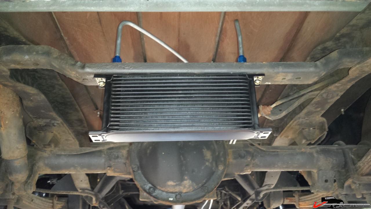

Next was the tranny cooler...
Decided to install my tranny cooler here because I have no room up front. For a moment I contemplated drilling large round holes in the bumper and mounting it behind that but I figured this was easier and I have some other cars where I set it up like this, a rear mounted cooler and they work just fine

pump & surge tank
coil, 3 bar map for trc-2 retard and some other stuff

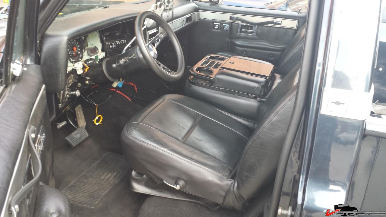

interior going back in

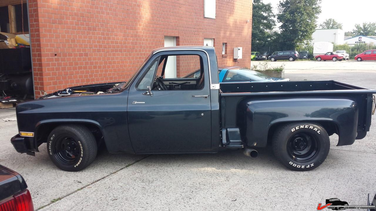

Well, it all went too smooth. Crap was bound to happen. Sure enough I had no fuel going to my surge tank. After checking the hoses, the pump and everything I decided to do a test on the tank lines and sure enough blocked and partial blocked. The reason is I took the tanks off but there is no room to work there so I left the hoses a little longer to be able to connect the hard lines with the tanks dropped down a little. This kinked the hoses when the tanks were back in place because the hard lines are pretty close together. With no room to work I had no choice but to lift the bed and redo them with the little cramped space under the cab available. Took some cussing and swearing but got it done.   Also painted the rear lamp frames black because the aluminum was oxidizing and I hate polishing stuff.
^%$#^%^#%$^#$%^caramba!!
blacked out
Now the pressure remains nice and constant and the surge tank is always full
1983 Chevrolet C10 Stepside Supercharged - YouTube
a little test drive...not much traction from these junk tires (peg leg)
http://www.youtube.com/watch?feature=player_embedded&v=OLp5zuI2x8k
