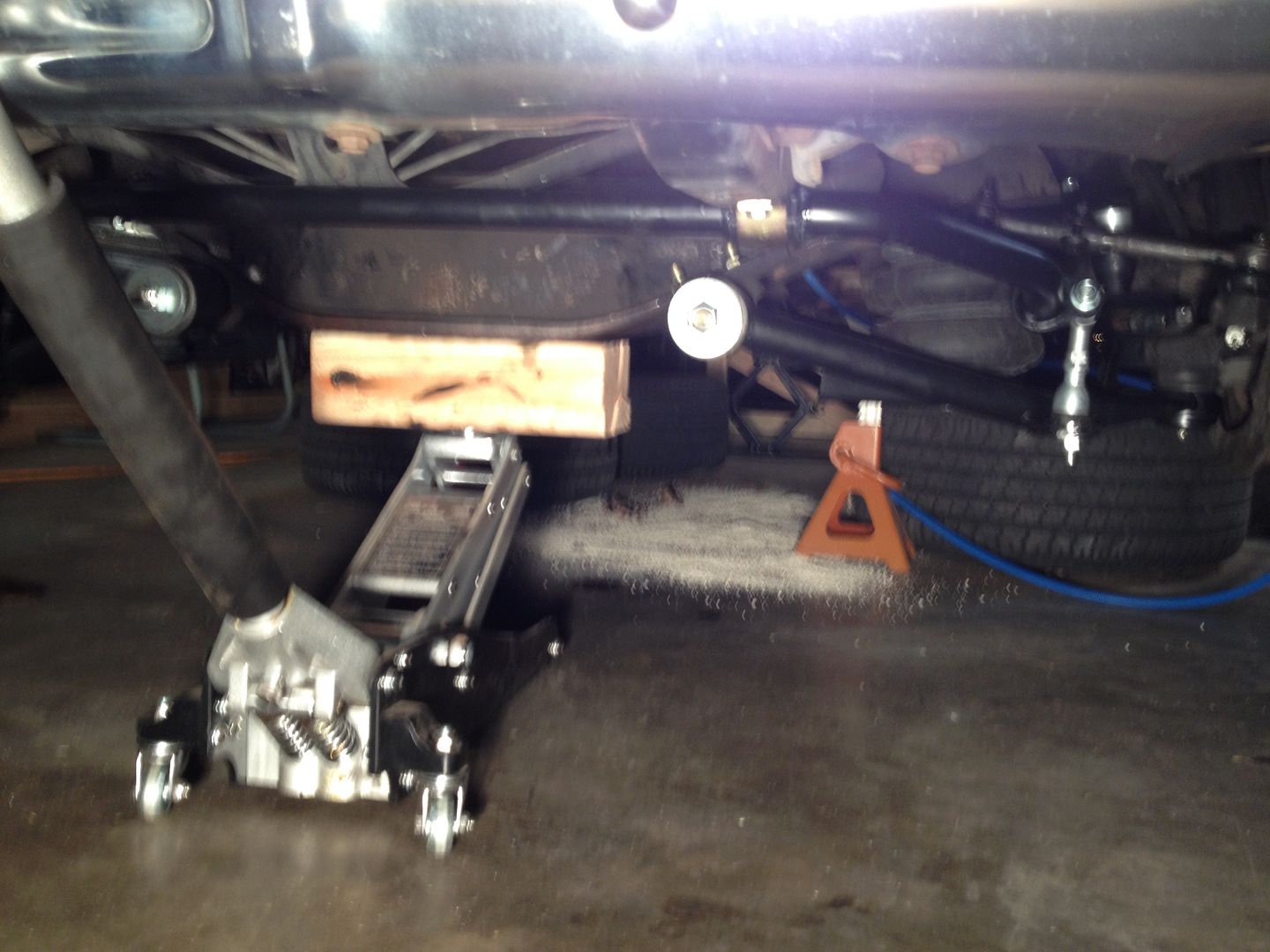

A rookie mistake almost cost me a lot. I was just thinking about the rear end install I was not thinking about everything. When I started removing the front shackle bolt for the leaf springs when I removed the second one my entire truck tipped forward. We have all felt that sinking feeling well somehow I got lucky the front jack stands were far enough forward that nothing hit the ground and the truck did not slide on the jack stands and cause a catastrophe. The rear end did slide back and the driveshaft did slip out of the transmission leaking a good size puddle by the time I got my jack under the front end like it should have been in the first place. Sorry no pics of the truck teetering on front jack stands.

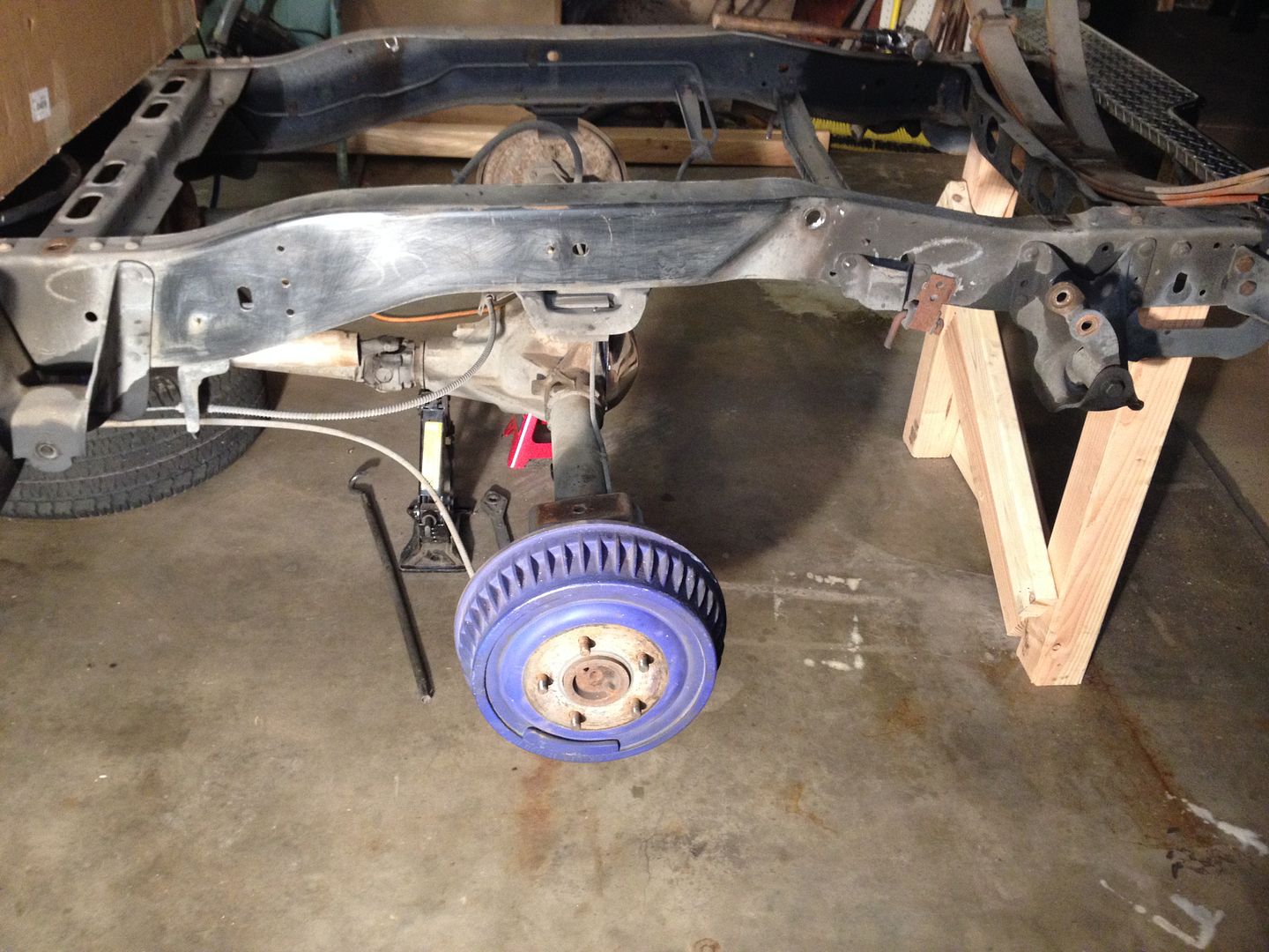

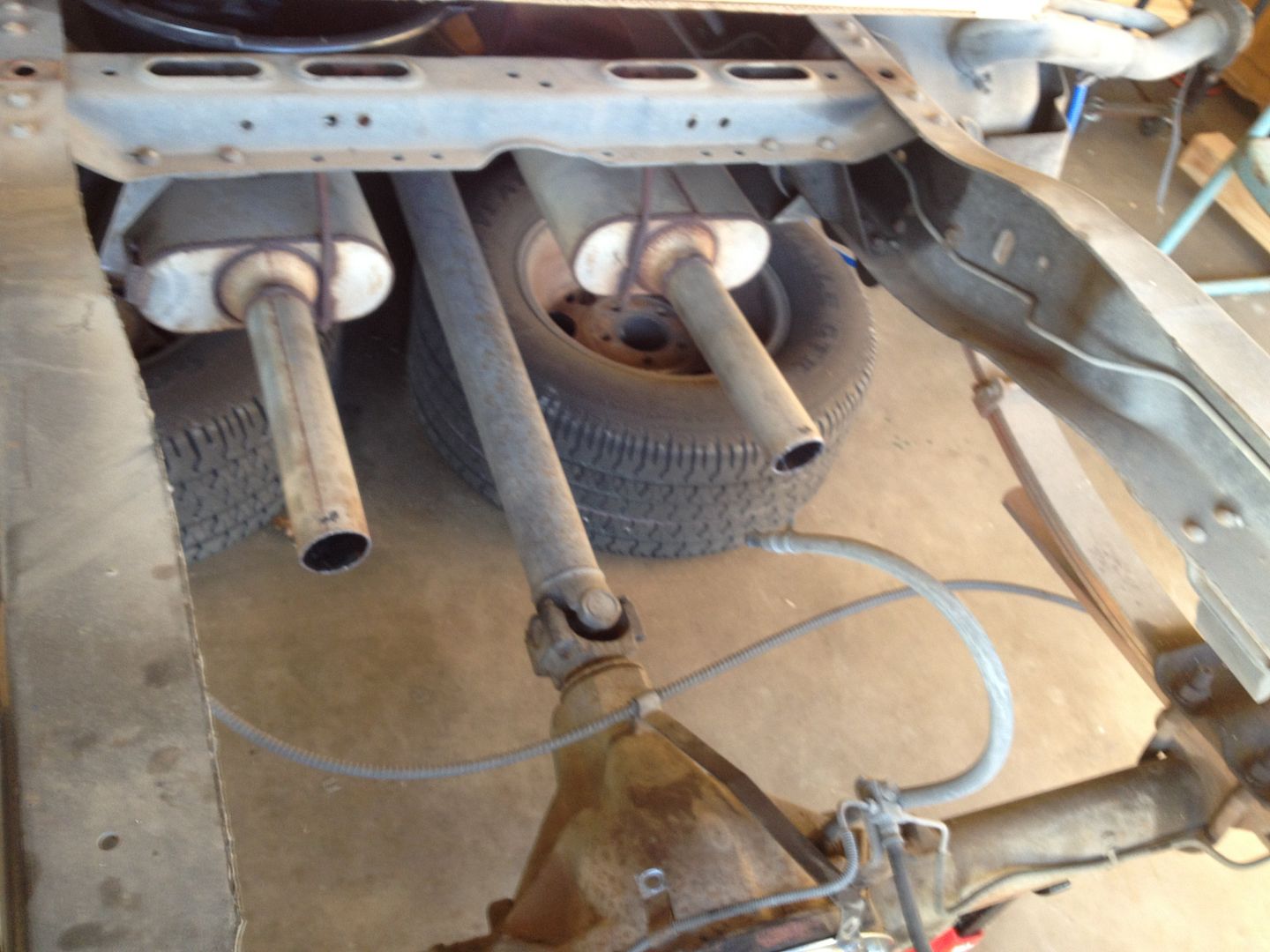

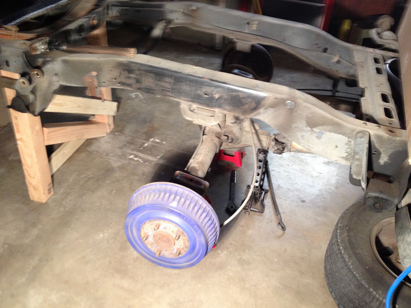

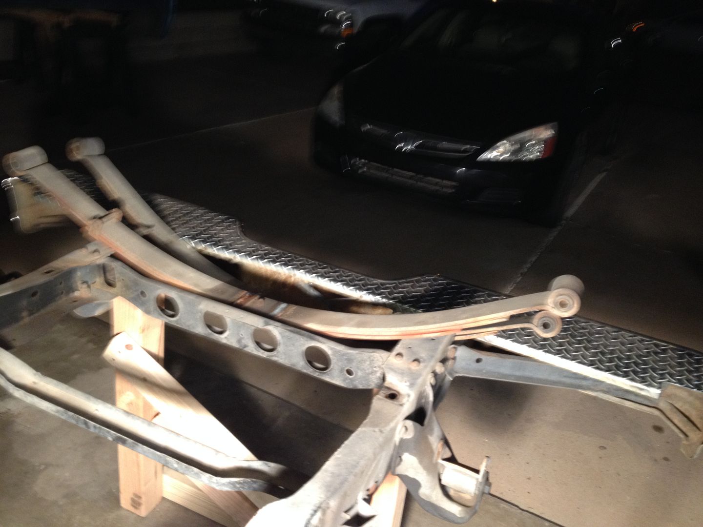

The pics are of the tear down so far. Other than remembering that the front end is heaver than the rear no big problems. Just when the truck tipper the rear end shifted back and the driveshaft came out of the transmission leaving a big mess while I was getting my jack under the front end.
Can someone tell me what the hose coming out of the top of the rear end housing is.
Still nervous so I left the leaf springs on the rear bumper.
bake74
Posts: 5871
Re: ridetech install 86 c10
Reply #35 on:
March 28, 2014, 10:05:39 pm »
I can see why you did not get any pics when the truck was teetering,
. The hose coming out of your rear pumkin is the vent hose, it should have a 1-way valve on the end of it, it is usually mounted up on a cross sill rail above the pumkin.
