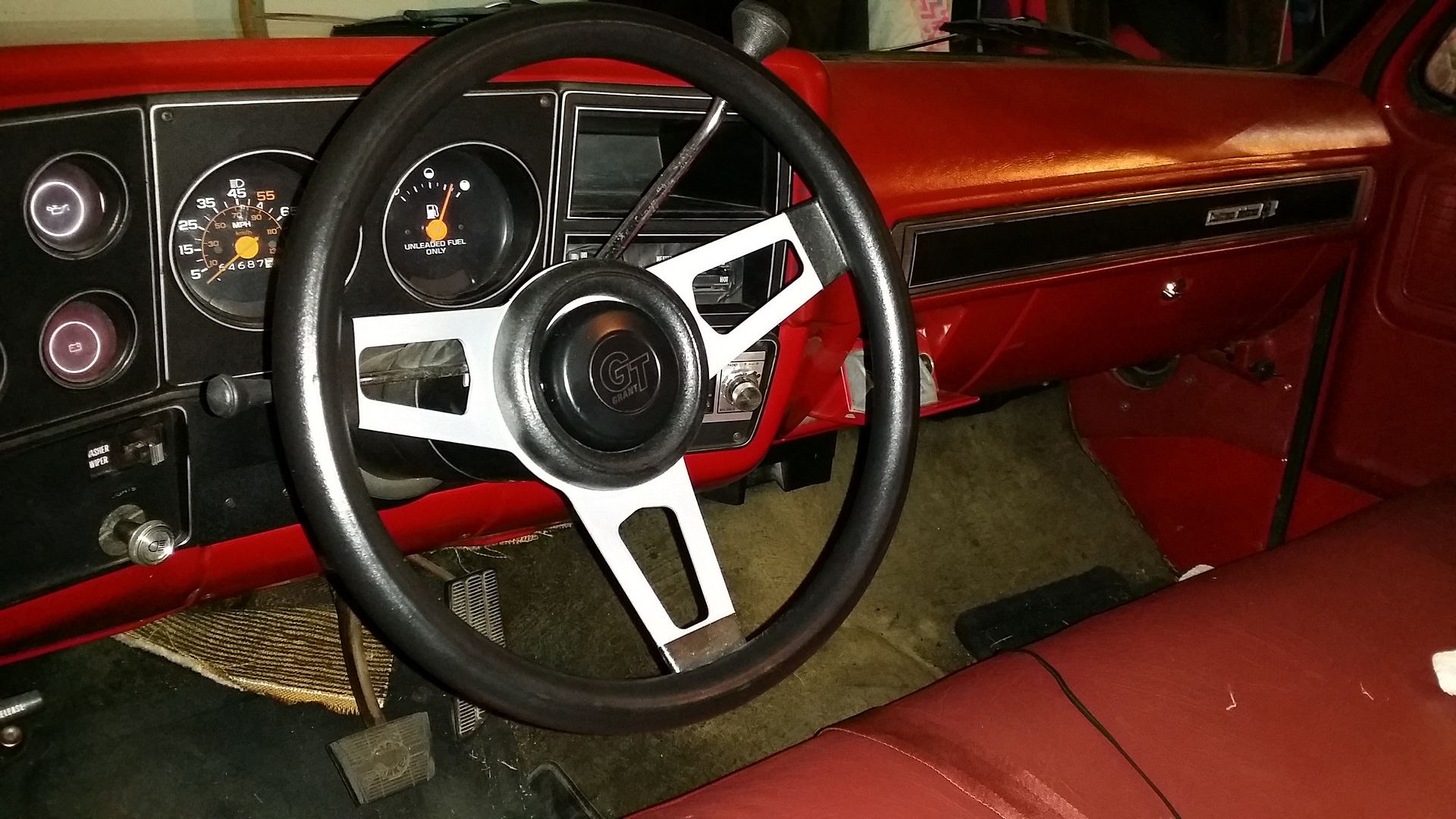

Tonight's project.  13.75" Grant Challenger wheel.  I like it a lot but it is pretty much right in front of the speedo and fuel gauge.  I also installed a new ignition key cylinder.  The old one didn't like to turn to start.

 That is one beauty of a truck sir!
 The steering wheel looks good.

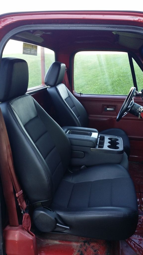

Here's a little peek at my latest additions.  Corbeau seats and a 2015 Tahoe jump seat.
The Corbeau seats were straight bolt ins.  They don't allow for a lot of reclining at all due to the truck being a standard cab.  Since I have short legs, I can lean them back enough that I'm very comfortable though.
The Tahoe console was pretty straight forward.  It required no welding but I did have to put 10x1.5 threads on a couple of locating pins to mount the rear bracket.  The original rear mounts needed trimmed as did the black skirt.  Otherwise, all I bought was a 3' section of 1-1/4" steel to make some pretty simple brackets.

That looks great. I want that same console and the bucket seats to go with it. I would prefer the brown leather seats from a High Country Silverado.
LTZ Cheyenne C20
