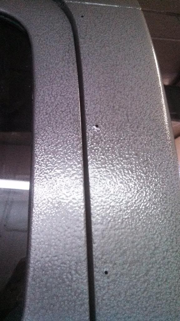

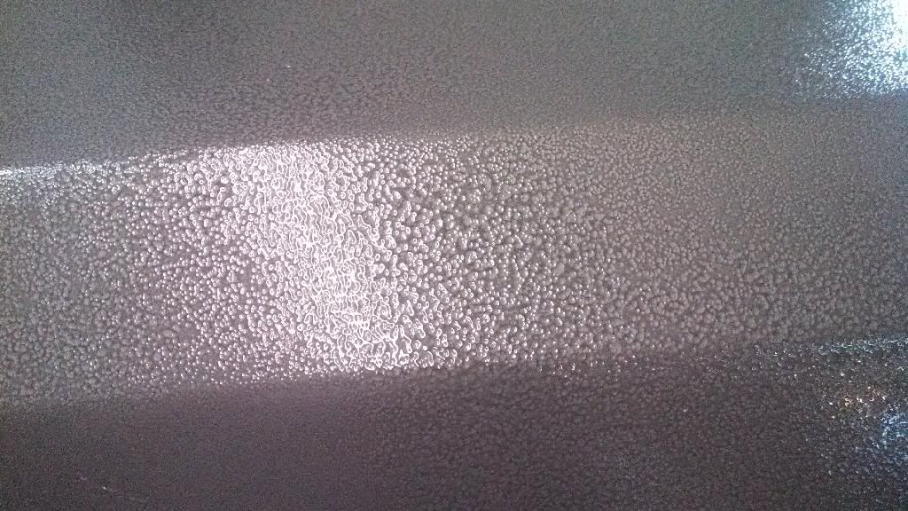

I spent somewhere around $75 including paint and thinner. i had to spray the truck with grey as a base coat to keep the different color panels from bleeding threw then i applied the hammered grey. its definitely not easy to spray unless you have a controlled environment... I just eye balled the thinner each time and also had moisture in the lines. That coupled with the thinner wanting to separate from the paint unless you constantly shook it cause me to have a some what hard time keeping the texture consistent. The hammered metal is a unique look and gives it a rough looking texture. The reason i chose the color i did is because i didnt like the plane colors... the hammered look breaks up the color and in my opinion helps it not look plain.
Here is the grey sprayed
Rear fender, as you can see the texture is tighter than it is on the cab ( next pic)

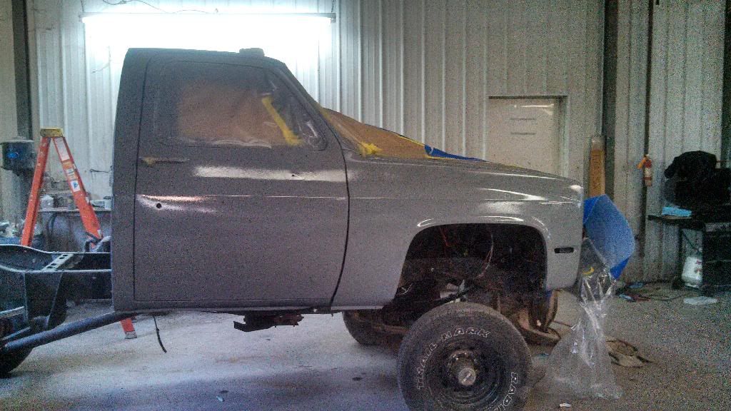

side of cab
3 years later... i should have waxed it but ive done nothing to is and its sat in the sun all its life. im sure it will shine back up some if i do wax it
no clear coat was used just sprayed with my primer gun. I do body work for a living so if you have any questions holler at me, ill be more then glad to walk you threw the entire process

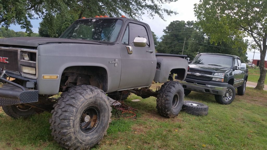

I did end up getting the 18.50/44 ground hawgs this past weekend and I mounted one to my wheel.  I am actually suprised I thought the fender would look a lot more stuffed but it doesnt.  I also picked up a brand new set of zero rates made by ORD from my cousin who bought them and decided he didnt need them.  So that was a great deal.  I will be putting them on this next weekend.  But I know that this tire measures to right over 42" and 15" wide.  I will have to cut the fender but that wont be a problem.... here is a few pics with it on the truck its front passanger.  The old tire measure a little above 35".  Pictures actually dont do the new tire justice it is a big difference!  Also on the side shots the wheel is turned in towards the fender
