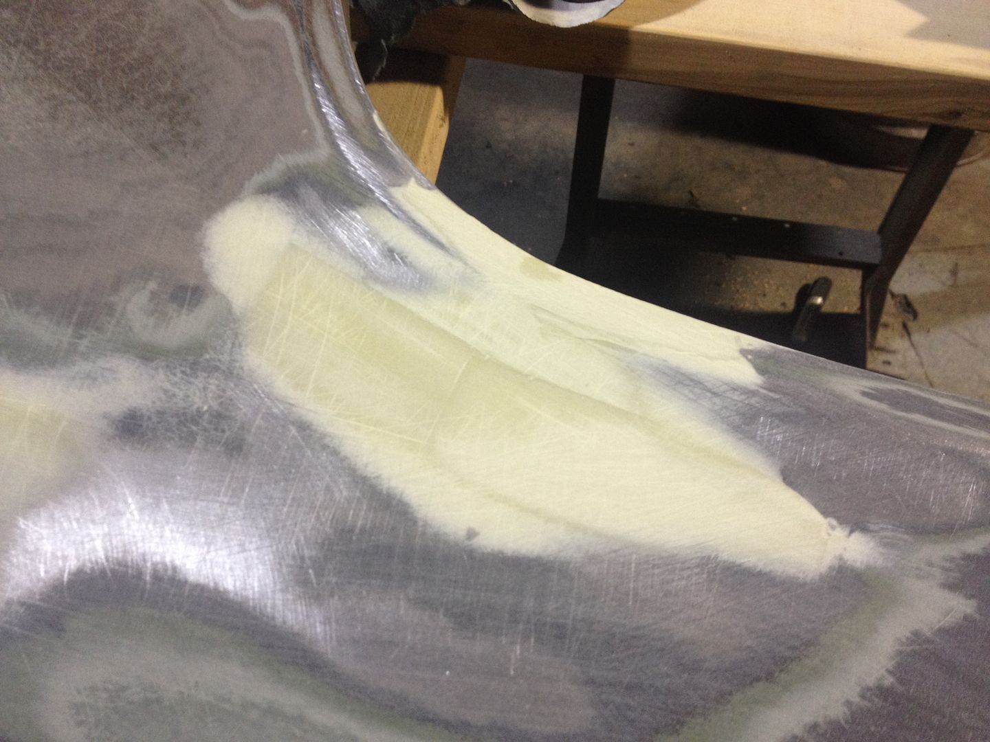

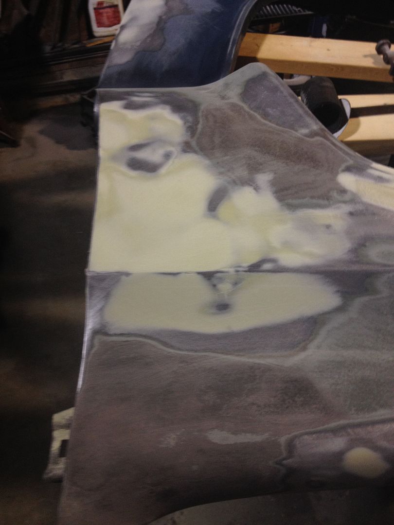

And more Body work, getting there, the CUCV door and Fender were the worst, and although I pulled a majority of the dents, the few stubborn ones were also in the worse location, still need to fill a little more in some areas.

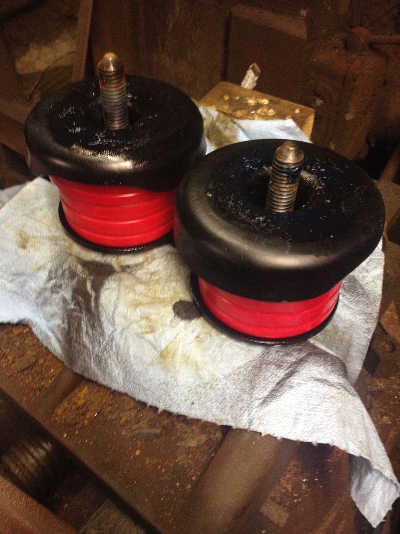

painted the oil cooler, need to get some lines for it. truthfully it doesn't look that much different, only a few small areas were starting to oxidize or rust.
and two body mounts ready for the cab, all four are done, only put 2 together for a picture. I do need 2 more cups and 2 washers for the radiator support, they were beyond help.

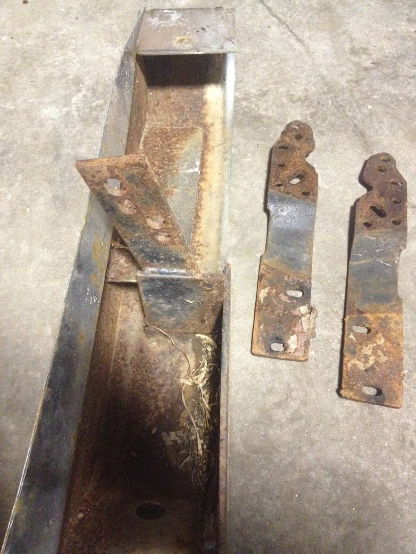

and finally what I need to do to the bumper. it looks like it was for a 90's chevy, 36 wide VS. the 34 of our trucks. so I took the old bumper and grabbed the brackets, and now all I need to do is cut off the current brackets and install the other ones.

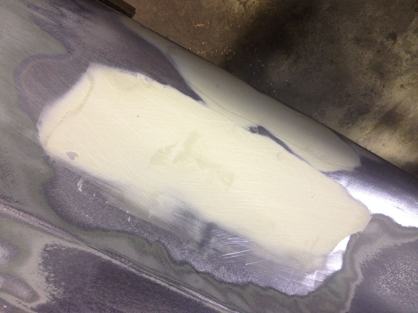

Little more sanding, and filling...and so on and so forth.
And while I wait for the filler to dry enough for sanding/filing I do other small projects.

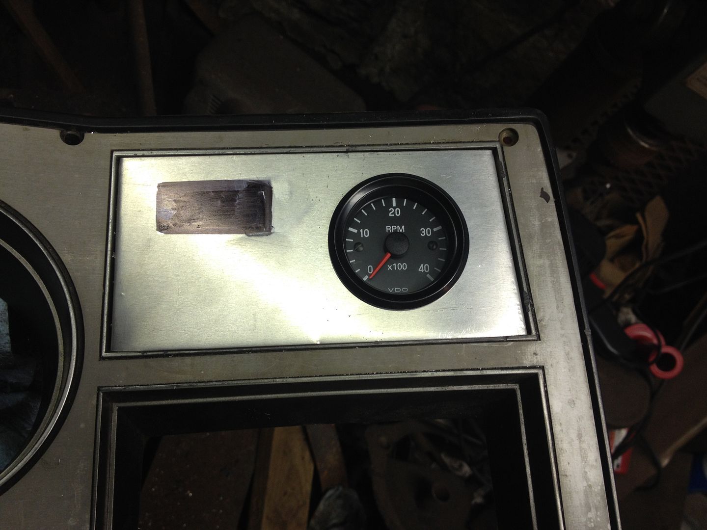

Tonight I managed to get a plate made up and mounted to the bezel to house my tachometer, and EGT gauge. I eventually plan to do a fuel pressure gauge too, as loss of fuel pressure could mean several things, but most importantly having proper fuel pressure reduces wear on the injection pump.
The black rectangle needs to be cut out, and then my Auber EGT gauge can go there. The panel itself is held to the bezel by three screws, I cut the cubby off so the gauges would fit.

EGT gauge in, and pulled the frame out into the sun. Hoping to have exhaust welded and cab sitting on frame by Sunday night, I plan to do all the body work while it's on the frame, plus it'll be nice to not have to worry about scratching the paint dropping the cab on after the fact.

It all looks nice, it really does. BUT, your tach is upside-down.

Yeah, noticed the tach was upside down later, but I only threw it back on for the picture.

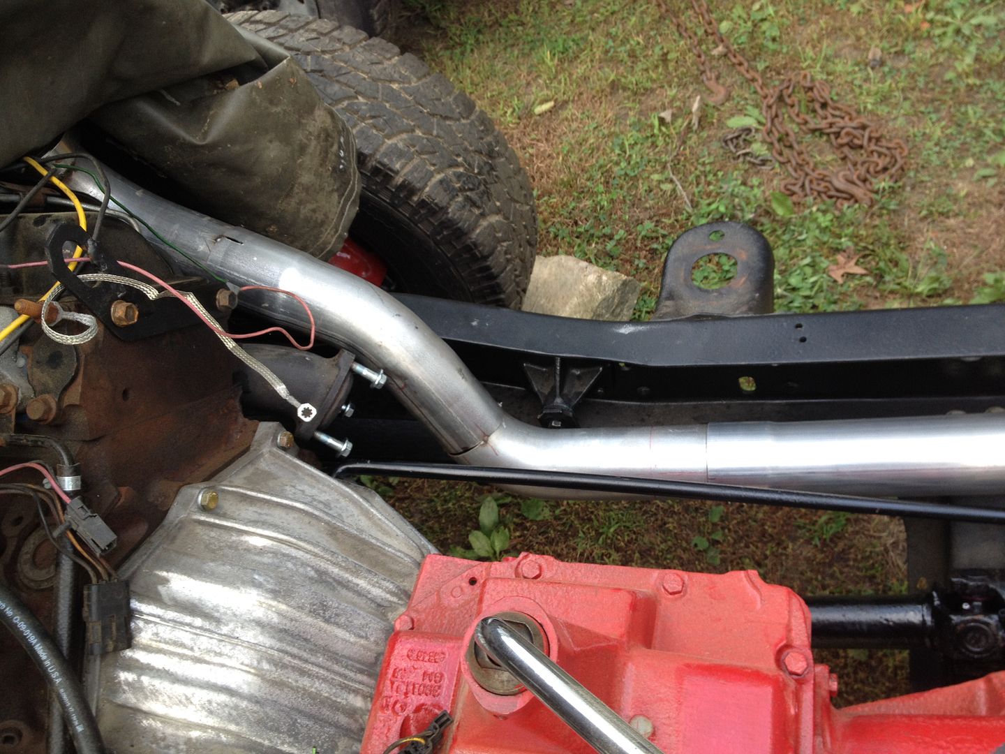

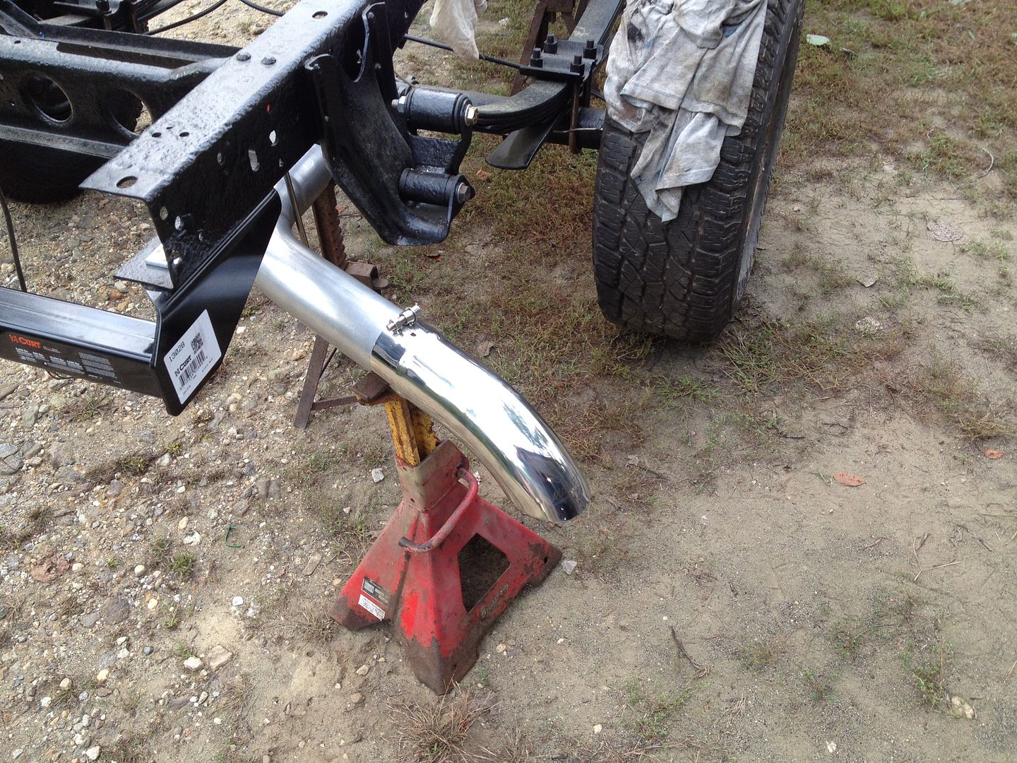

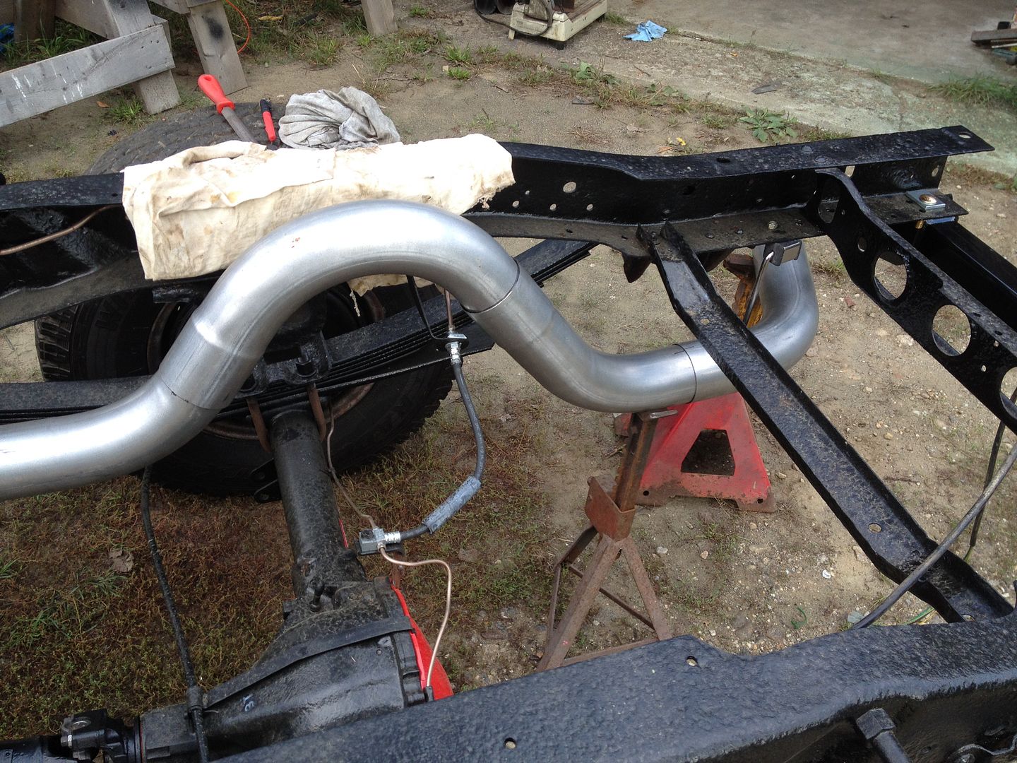

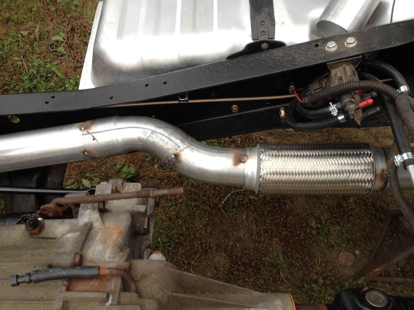

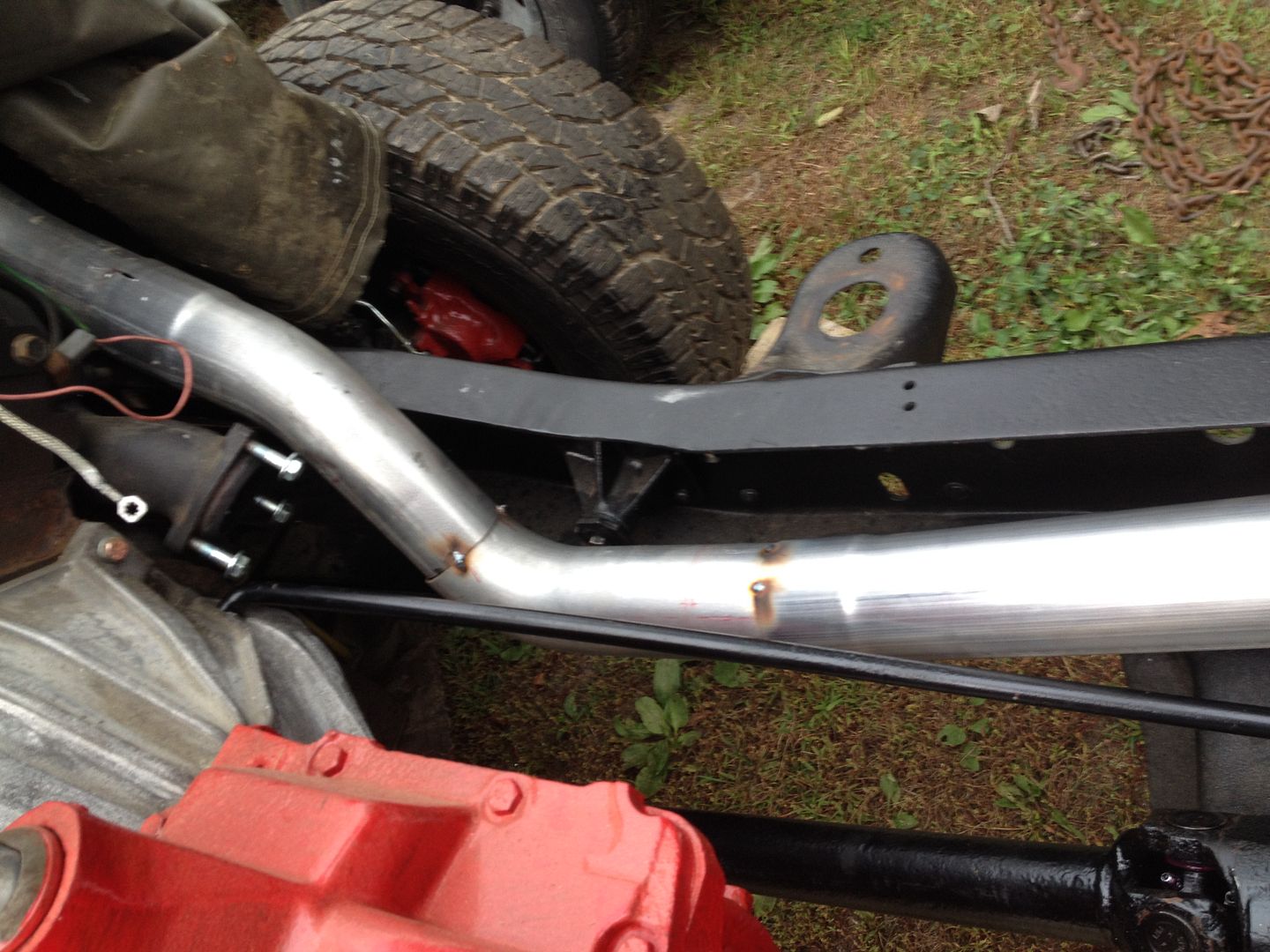

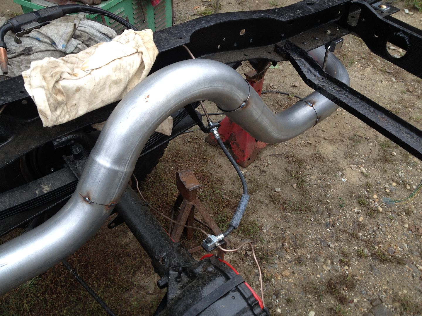

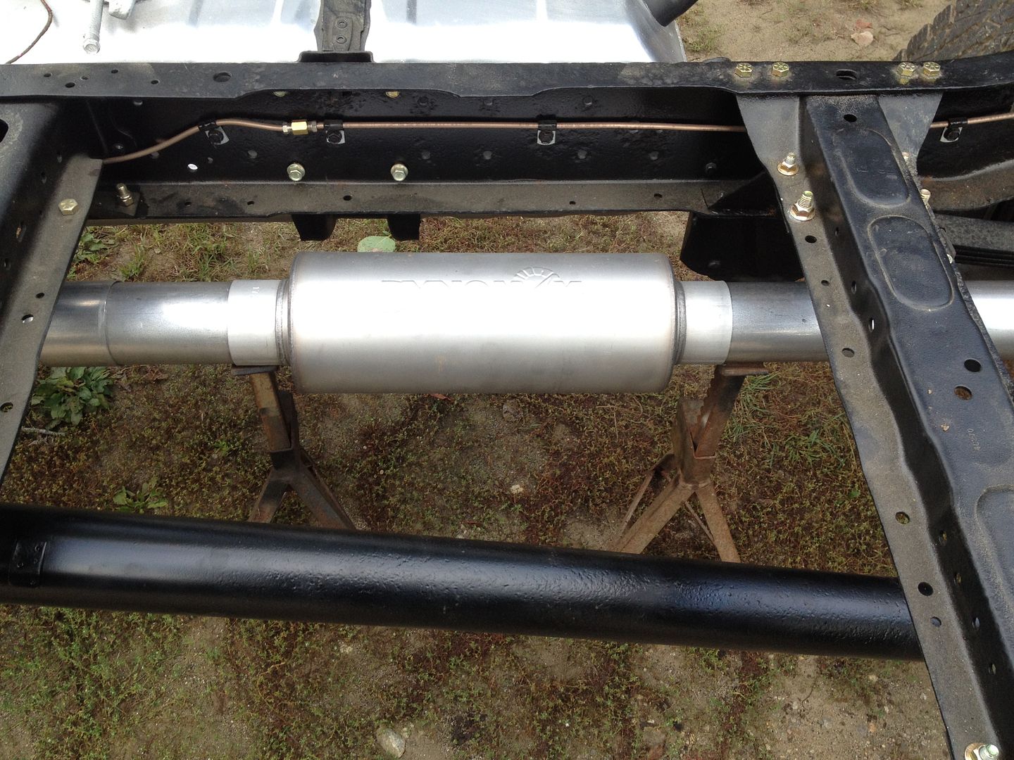

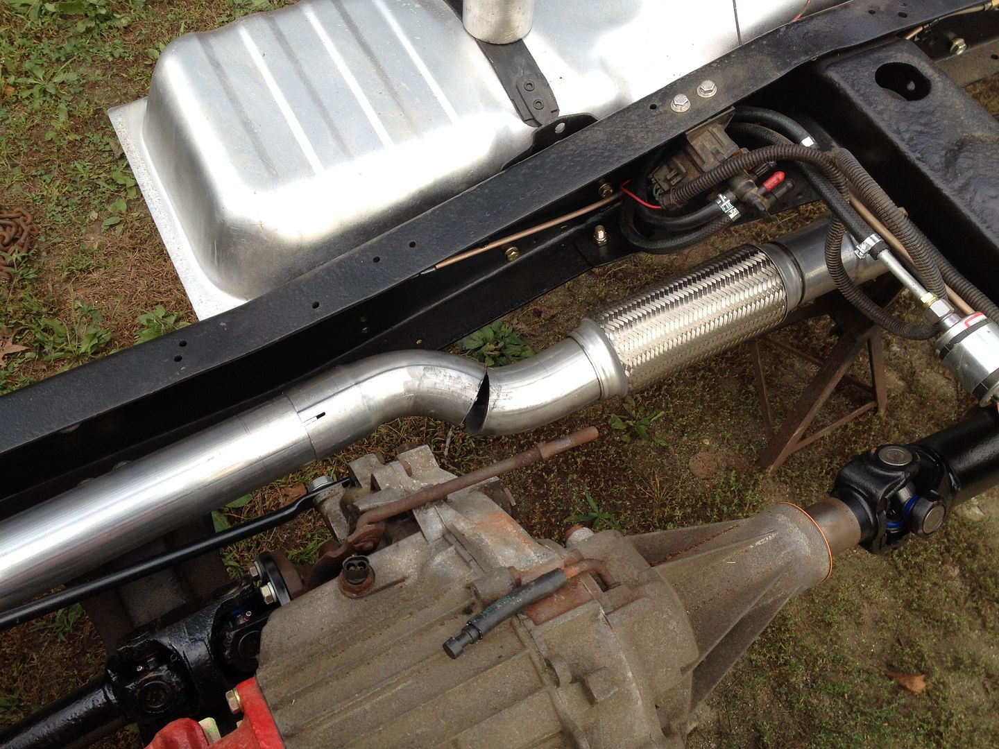

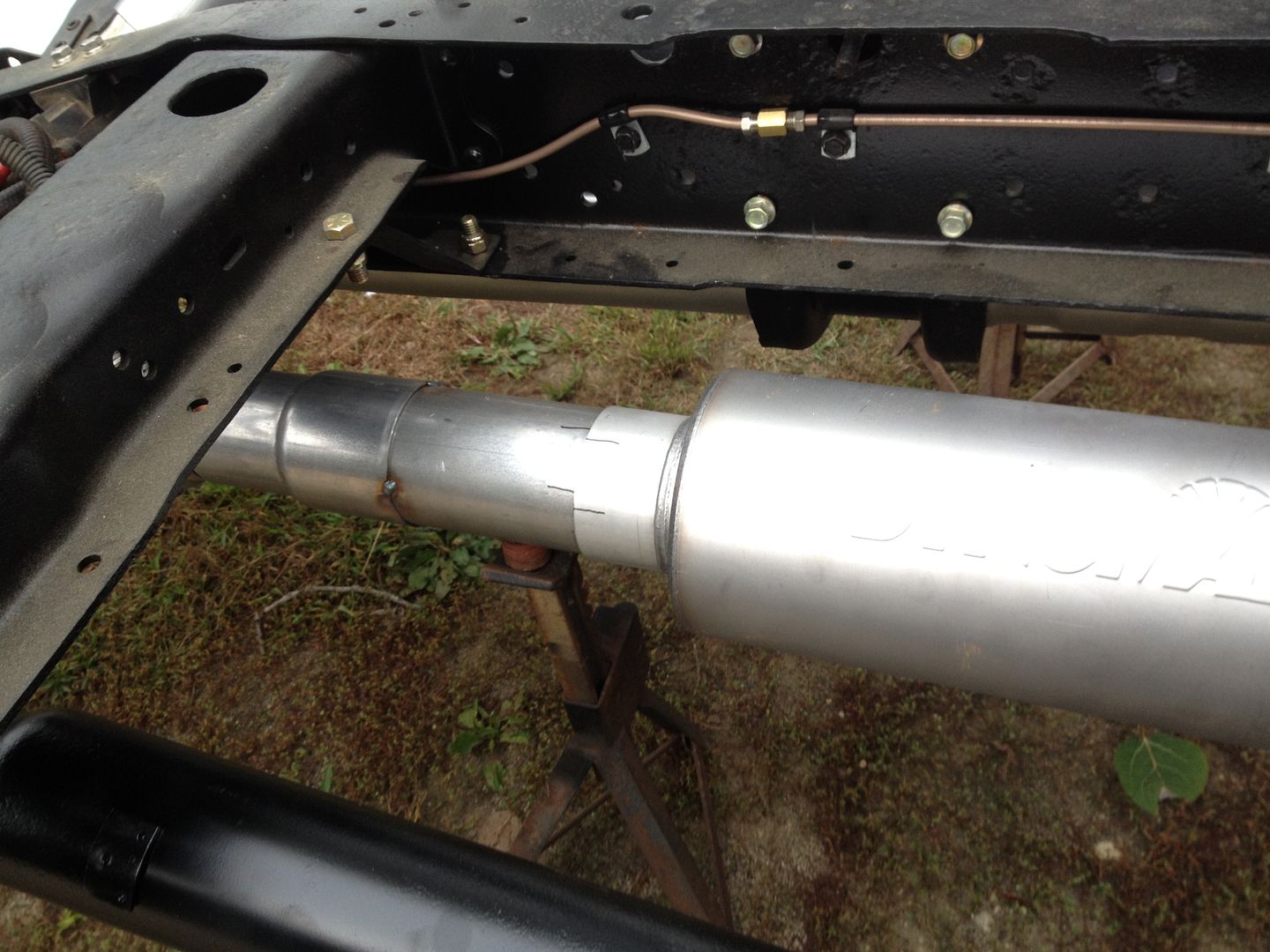

Exhaust is all tacked up, need 1 more hanger, maybe 2, and 2 clamps-I'm going to leave the muffler removable, AND when I pull the exhaust to fully weld I will be installing a V-Band clamp on the down pipe for easier removal later if needed. I don't really want to have to remove the exhaust in the near future, but you never know.
Couple before, and then a couple tacked, it was threatening to rain so I had to hurry up near the end to get it covered again.
That's all for now.

Got it. What size pipe are you using and what muffler? I like that your using a flex pipe, those are good to help reduce vibration and allow flexing as needed. It looks good.
LTZ Cheyenne C20
Offline 1967KaiserM715
  • Posts: 914
  • 1985 GMC K1500 w/ 6.5 TD
Re: 1985 GMC K10 build
« Reply #134 on: September 23, 2016, 09:09:37 pm »
Thanks.
3" to the muffler, then 3.5" the rest of the way. Muffler is a dynomax, 17224 ultra-flow welded round.
Definitely figured the flex was required, everything fit nice, but definitely wanted to reduce the risk of cracks forming in the down pipe, it really should be a part of every exhaust system, it's a lot of weight hanging out there.
