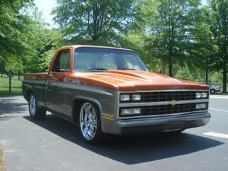

Dropped 2 more inches...I think this about right...
what's the total drop front and rear for it now? that's the ride height i want.

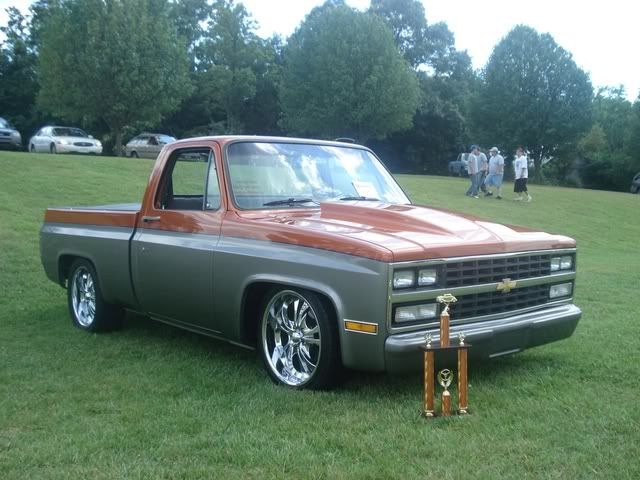

« Reply #48 on: August 15, 2008, 03:10:30 pm »
I finally got it sitting right..

I was'nt wanting to bag it.. Trying to get the right spring setup. I wanted it low as possible without flipping the axle and not having to take the inner fenders out....I finally got it...I think it is sitting just right now..

its the suburban conversion front clip.......................It is lowered with belltech spindles plus 2.5" lowering springs in the front...the rear has the belltech hanger shackle 4" drop plus a single monoleaf spring....Not stiff in the rear anymore...I had to put a half inch adapter in the front because when I turned the tire scraped the inner fender...any lower and the inner fender was coming out..

Thanks for the lowering info. Last question, promise. Are those 20's all around?
Offline 79GMClowboy
  • Posts: 35
Re: 79 big block fleetside
« Reply #57 on: August 24, 2008, 07:07:55 am »
Yes it is..20" all the way around...They are 8.5 wide..you can go with a 10" wide rim on the rear..
