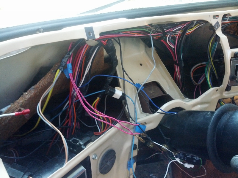

Sunday, July 1st, 2012:

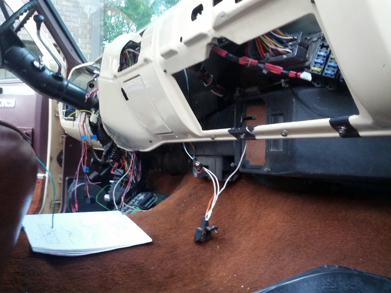

Back to the passenger side. I ran the Dakota Water Temp wiring from outside through the dash and down to the Controller, and I lengthened the VSS sending wire and ran it over to the Dakota Controller. I also spliced the AC request wiring into the Painless wiring so it will plug up like the factory did.
This is what it looks like outside the firewall now:
Starting outside the firewall I wrapped the wiring and Zip-tied it every 6-8" and then snugged it neatly out of the way.

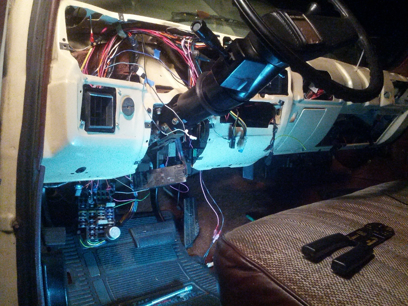

In the picture below I have routed all of the wiring up to the gauge opening with Zip-ties and tape wrap and attached the Fuel sender, Oil sender, water sender, Switch 1 and switch 2 for the Dakota menu, VSS send. Also seen are the 2 white plugs that attach to the Left turn and Right turn signal so they are displayed in the factory turn openings.

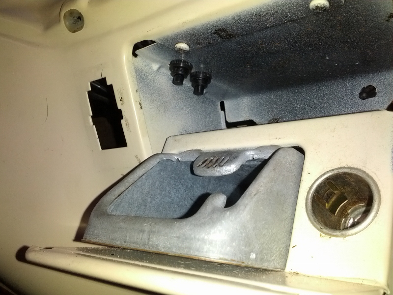

This is where I put the Dakota menu switches:
What is left on the Dakota controller at this point is the Check Engine, DIM switch, Ground and Accessory power, and the Ignition switch power to the LS ECM. Once these are done everything under the dash (minus radio wiring) will be completed and then on to under the hood.

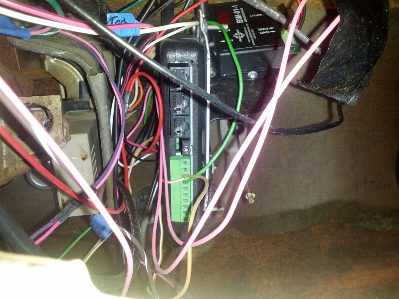

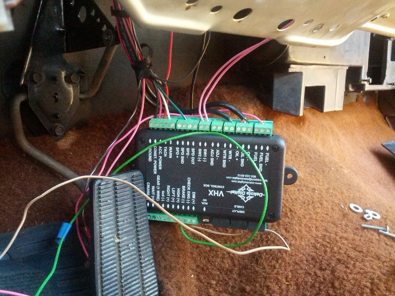

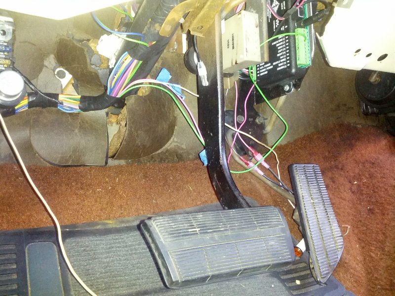

Friday, July 6th, 2012:

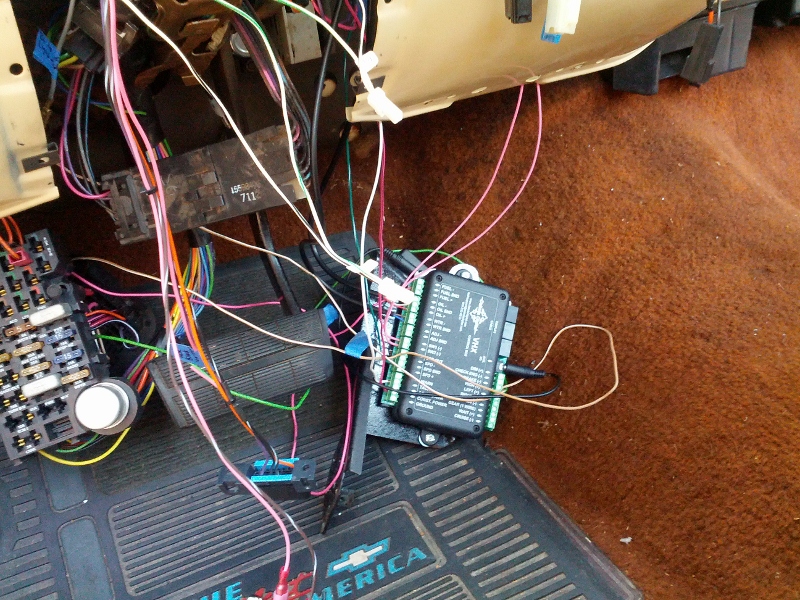

Finished connecting the Ground and Accessory power to the Dakota module and the ECM Ignition power wires to the fuse box. I made all of the wiring really long since as I need to get everything up top located so I can set the length. After getting these connected I mounted the Pedal assembly back into the truck.
Here you can see how much of a jumbled mess it is with the wires long.

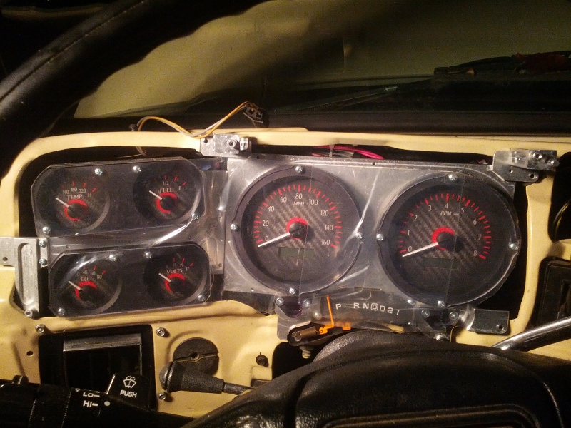

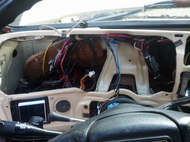

Saturday, July 7th, 2012:

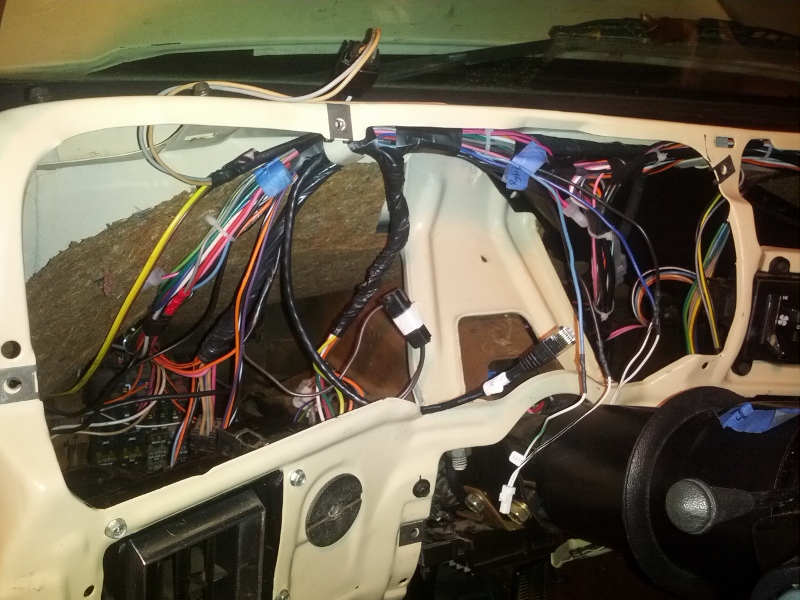

Unbolted the module from the pedal assembly and velcro tied all of the upper the wiring to check for proper length.
Once I got the length sorted out I began tape wrapping and Zip-tie'ing the dash/dakota wiring.
Once done with that I started shortening the firewall side wiring on the Dakota module, and then mounting it back. Not seen in this picture, but the Dakota ALDL Module is also connected and wired.
Routed the ALDL wiring, the CAT5 for the Analog gauges and routed the dimmer wire for the Dakota module.
Routed the Brake, Hi Beam, Dimmer and Fuel sender wiring to the front of the Dakota module. At this time the Dash/interior wiring is done (minus the radio)
Connected the ALDL, the CAT5 and the factory location turns to the VHX gauge and set it in place.

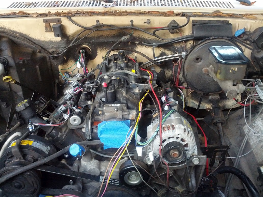

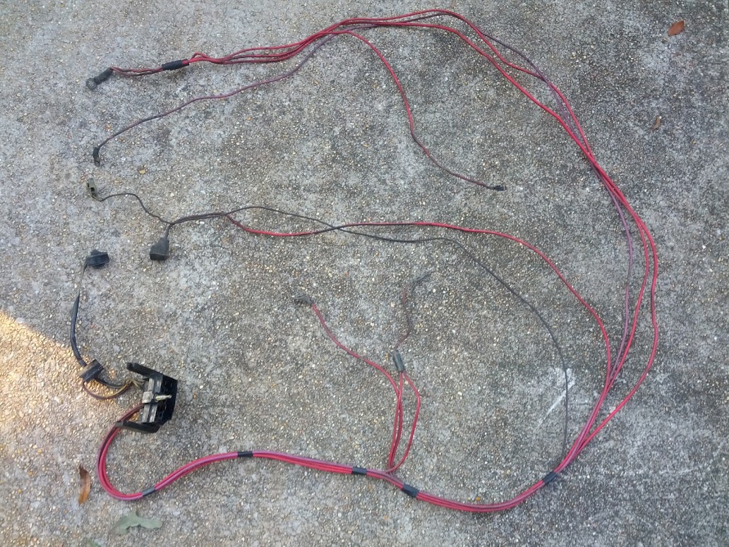

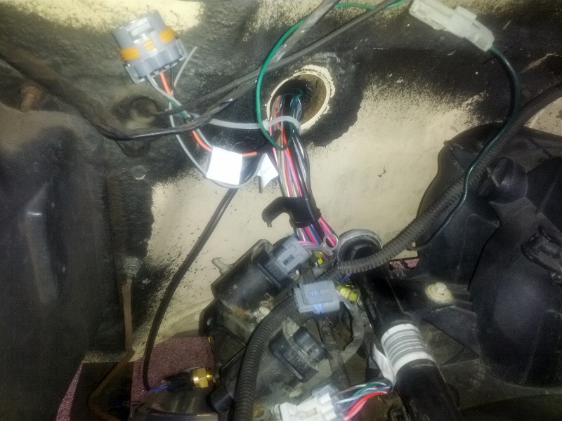

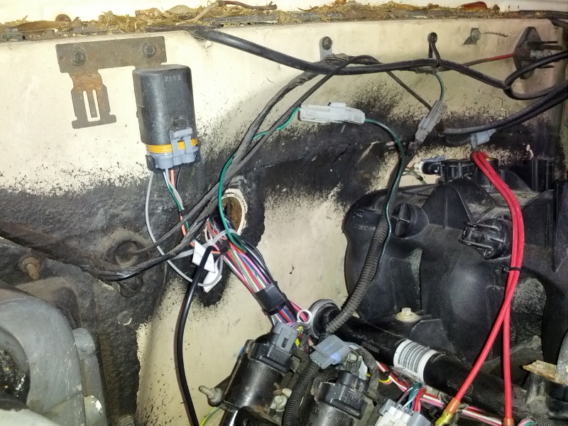

Saturday, July 28th, 2012:

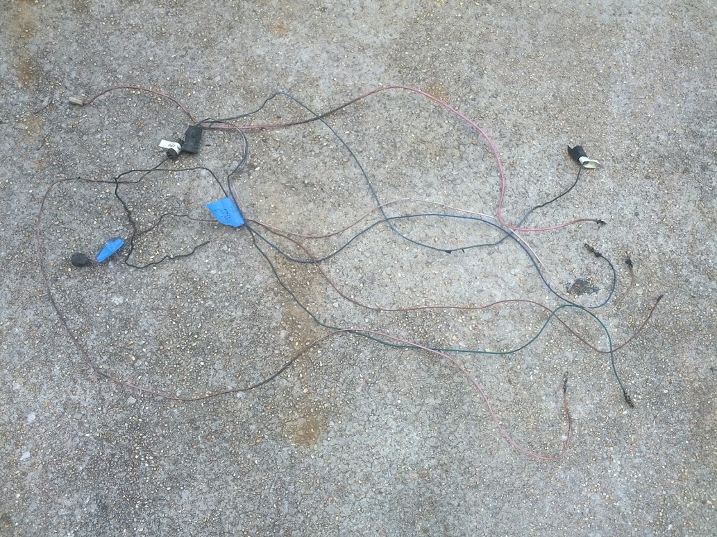

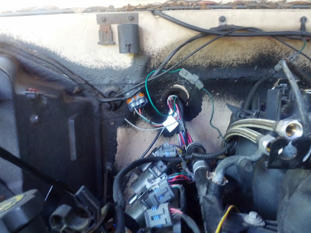

Modified the factory TBI firewall grommet by splitting it and cutting out the center to go over the wiring and fit back in the firewall.
Since I have a Carb'd truck that I am converting to Diesel, I used its firewall harness instead of the TBI as it had less wires and removed the Carb Solenoid, 12V to Coil, Choke, Coolant Temp and Oil Pressure relay wiring from the bulkhead fitting. (these were removed from the inside previously)
What I ended up with was wiring for the starter, starter solenoid, Power junction and distribution for the Alternator and battery along with the windshield washer wiring. The starter and alternator wires will end up being shortened for some and lengthened for others to match the original Wiring for the 99-02 pickup.
Here is a pic of the harness plugged back into the firewall distribution block
Here is where I started routing the firewall distribution to where it needs to go. In the foreground you can see the Alternator wiring that will end up being tied into the factory plug from the LS ECM along with the Power to the Alternator. I need to remove the PNP wiring from the LS harness as I won't be using it and I am also going to pull the EVAP wiring that I forgot about while I was focused on the inside. Then I can start bundling the LS and stock wiring back together.

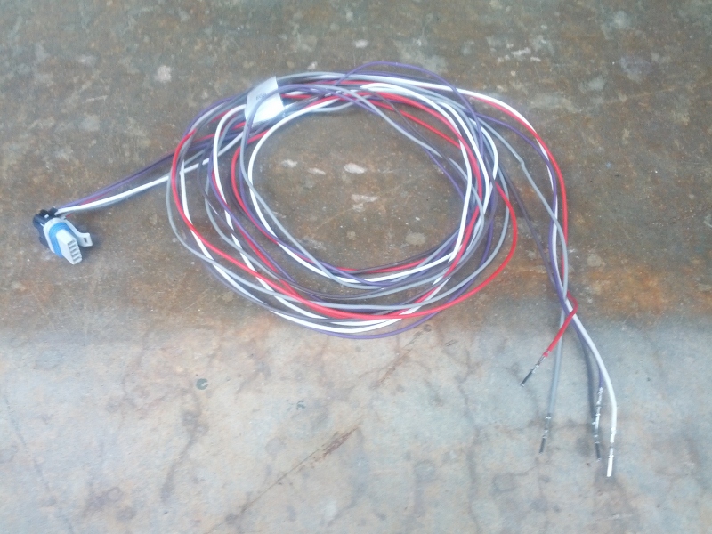

Saturday, August 4th, 2012:
Before I start to bundle all the wiring from the truck and the ECM together, the perfectionist in me got the better of me. I refused to leave plugs in the harness that I wasn't going to use. So I decided to pull the EGR wiring along with the PNP (connector) wiring out of the ECM harness
This is the EGR wiring: (99-02 Blue connectors 23, 48 and 55 and Red connectors 7 and 41)
This is the PNP bundle (99-02 Blue connectors 32, 34 and 72 and Red connector 62, plus I had to cut a ground and power out)
